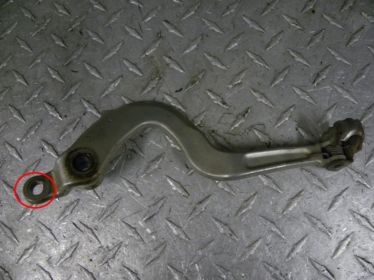

I have 6 KX500 rear brake levers in inventory.
Every one of them has the same issue.
2000 kx500 kawasaki rear brake lever mod oem-cycle.com 101.JPG (400.43 KiB) Viewed 11341 times
The attachment point for the master cylinder gets wallered out and make for a sloppy rear brake :shock:

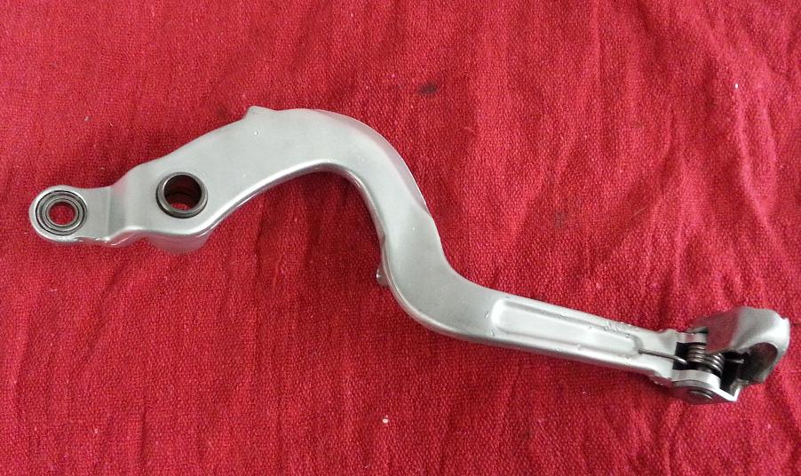

Fixed!
KX500 REAR BRAKE LEVER FIXED 101.JPG (109.36 KiB) Viewed 11334 times
KX500 REAR BRAKE LEVER FIXED 102.JPG (47.45 KiB) Viewed 11334 times
KX500 REAR BRAKE LEVER FIXED 103.JPG (55.32 KiB) Viewed 11334 times
Re: Fixing a KX500 rear brake lever

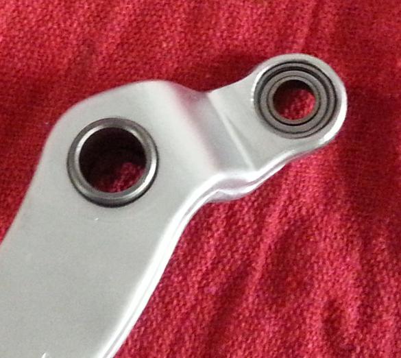

To fix it I drilled out the existing hole to make it round again.
Then I cleaned it extremely good.
Next, my welder filled in the hole and added a bit of material around the outside edge where the bearing is as it would be a little too small for the bearing to fit.

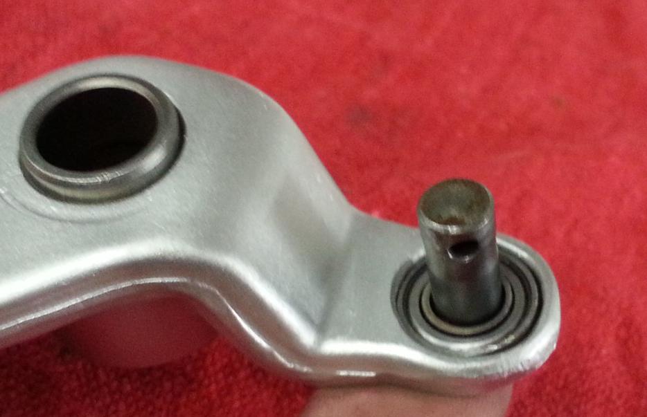

Then I drilled a 16mm hole for the bearing.
Slipped the bearing in with a bit of bearing retainer.
DONE!
Oh! Bearing size:
16mm OD x 8mm ID x 5mm wide
Next I need to give it a good ride and see how it holds up.
