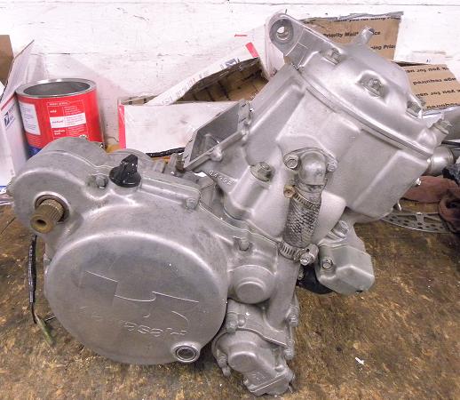

This is a customers engine that was sent to us for a full rebuild.
91 KX500 ENGINE BUILD 10002.JPG (57.58 KiB) Viewed 15818 times
On a rebuild the first thing you must do is take it apart and inspect it.
Since this engine was nice and clean we were able to dig right in.

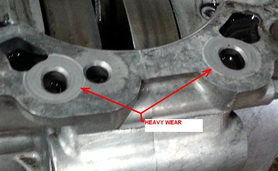

Here is another piece of damage that we found that is a little more unusual.
91 KX500 ENGINE BUILD 10004.JPG (68.22 KiB) Viewed 15816 times
It seems the drum valves were actually wearing on the cases.. We will need to figure out why they are so badly worn and fix the issue as well as fix these cases.

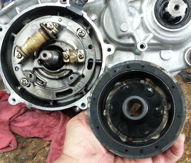

Here is another area of concern.
The crank seal was leaking so bad that it was letting a lot of fuel into the magneto area and actually smelled burnt when we removed the cover.
Of course we will need to check the OHM specs on the stator to be sure that it is in good shape before we install it.
91 KX500 ENGINE BUILD 10005.JPG (69.46 KiB) Viewed 15816 times

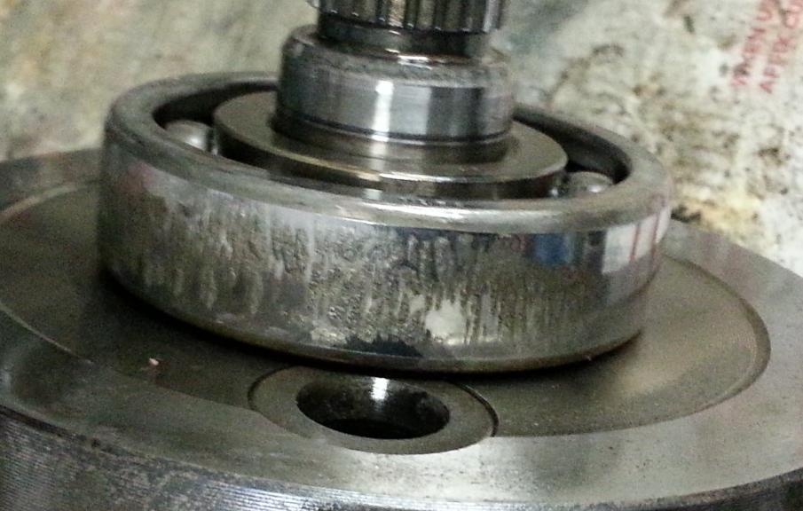

The crank journal was so worn out that the bearing literally falls onto the shaft...
This should be a light press... No way should you be able to even push it on with your hands let alone letting it fall on..

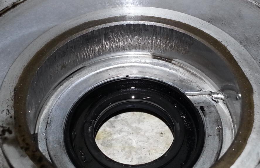

Check out these pics..
91 KX500 ENGINE BUILD 10006.JPG (70.64 KiB) Viewed 15815 times
91 KX500 ENGINE BUILD 10007.JPG (71.53 KiB) Viewed 15815 times
The bearing was so worn out that it started chattering inside the engine case and severely wearing out the case :shock:

I have a '92 engine with the same chatter marks in one side of the case . will you try a repair or scrap it ?
Re: Building a 91 KX500 engine
Posted: Fri Jun 05, 2015 5:17 am
Well.... I know we can clean it up and do the JB weld repair.
They will hold for some time.
I'd rather bore it out and put a sleeve in it.
But I don't have a mill to bore it or a lathe to make the sleeve :cry:
I do know several guys with the equipment to do it but it's time consuming running parts around town.
After all you can't just drop stuff off and say bye... Guys always want to talk about what my latest plans are :lol:
Probably the best option for this customer is to get a new/used case.
But the school is still out on that as I have to discuss the options with the customer before we go much further...
