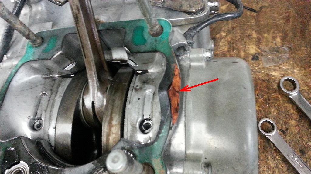

Note on the pic below how the base gasket was sucked in.
Instead of removing the cylinder and replacing the base gasket the previous builder filled in the gap with some orange sealant :o

So you disrupt the smooth flow of the fuel air mixture with a gasket flapping around in there and probably had a air leak making it run lean.

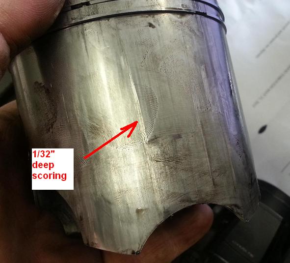

Now, take a look at the pic of the piston below:
91 KX500 ENGINE BUILD 10001.JPG (43.22 KiB) Viewed 15798 times
What caused that on a recently installed piston?
First off note that the scoring is on the intake side of the piston.
And, there are actually two scoring marks spaced evenly and symmetrically on the piston.

Cracked intake bridges were the cause of the piston destruction.
Some people say that they have ran their bike for years with cracked intake bridges and that theirs never had a problem.
And that is possible.
However, some people experience this exact same problem when their intake bridges crack.
Why?
Believe it or not their are internal stresses on the cylinder casting.
This became apparent when I was cutting a KX500 cylinder for display purposes.
You can read more on that here:
viewtopic.php?f=5&t=481
In any case, when the cylinder heats up and vibrates it can cause the intake bridges to extend into the cylinder bore and start scuffing up the sides of the piston.
Of course a good plating company such as Millennium Technologies can weld up those cracks and much worse damage as well.

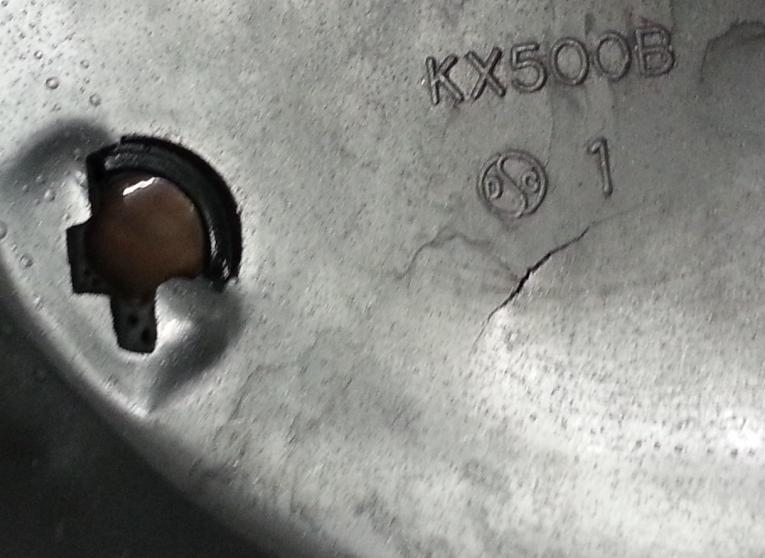

Another area that is typically damaged on a KX500 is the clutch cover.
When a guy falls on his right side the rear brake lever pushes into the clutch cover and cracks it.
This one looks like it is not leaking but why take a chance?
We have some special brazing rod that can fix it right up.

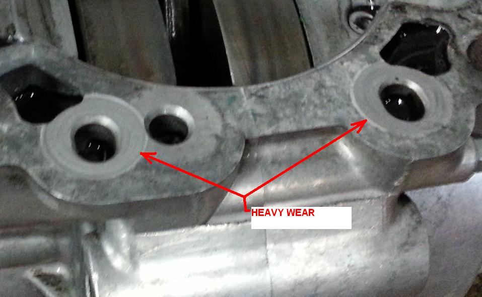

Here is another piece of damage that we found that is a little more unusual.
91 KX500 ENGINE BUILD 10004.JPG (68.22 KiB) Viewed 15794 times
It seems the drum valves were actually wearing on the cases.. We will need to figure out why they are so badly worn and fix the issue as well as fix these cases.
