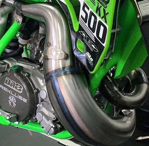

Is that a OEM-CYCLE 2 piece clutch cover on Destry Abbott's bike? 8-)
destry abbott.jpg (164.72 KiB) Viewed 18978 times

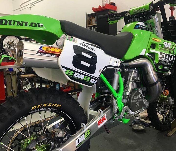

Re: KX500 2 piece clutch cover adapter
Posted: Wed Feb 24, 2016 3:27 pm
destry abbott2.jpg (159.84 KiB) Viewed 18975 times

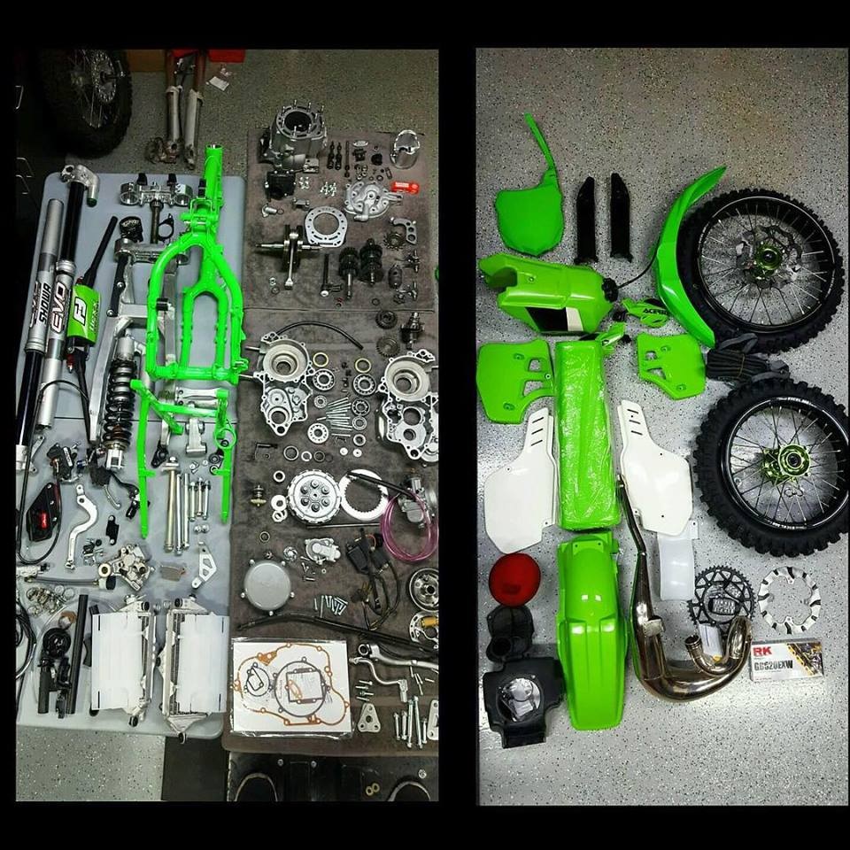

Posted: Fri Feb 26, 2016 1:31 am
destry abbott3.jpg (77.46 KiB) Viewed 18971 times

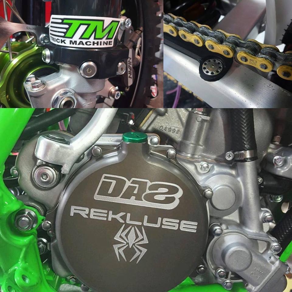

Posted: Fri Feb 26, 2016 1:33 am
destry abbott4.jpg (151.85 KiB) Viewed 18971 times
