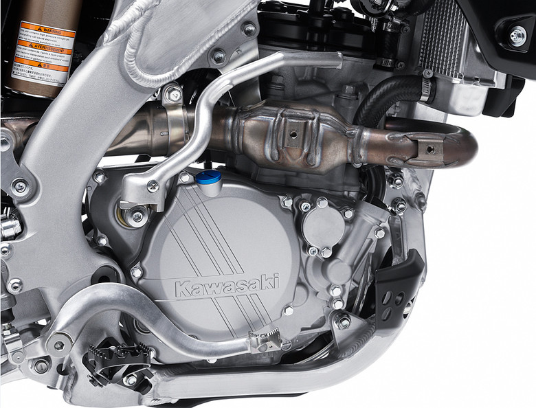

shame.. I like the way the 2013 covers look..
