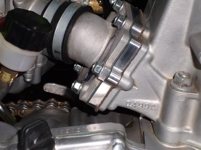

Guess what I have in my Grubby little hands... grin
The Rad valve thats been formentioned...
Measurements, Ideas, and thoughts to come..

Posted: Mon Sep 08, 2014 1:34 am
Well...
Here is the stuffer out of a V3 reed cage. (which matches the stock rubber intake boot pretty darn good).. Layed ontop of the RadValve Hole... Im not sure there is enough material on this thing to open it up to Work. (the bore on the carb side is only 38mm)
