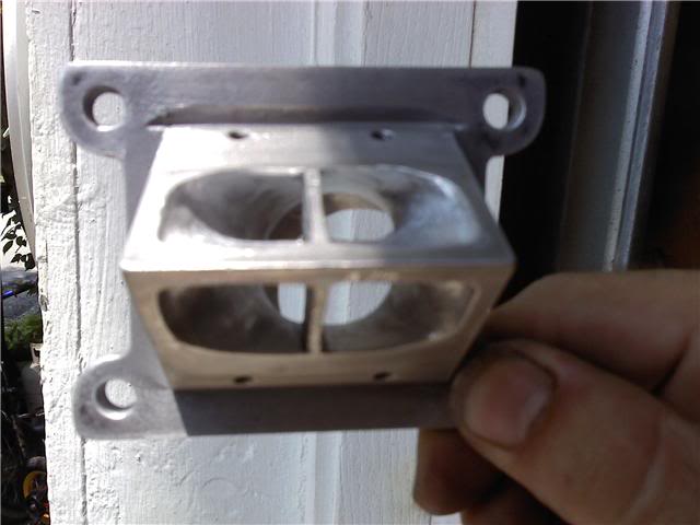

kaw rider:
here is the size of the opening. found it in another post.
a stock cab measures about 40 mm at the intake side of its bore ..that is about 1.570 dia the rad valve when cut like this has around a 1.300 hole with a bridge in the center thats already removed from this one.
Motorrad:
1.3" thats hmm 33mm then you add a Bridge to restrict area further..
Not sure that will keep up flow with a 42mm carby.. Thats a 10MM differance, not counting the bridge...
I fully believe in taper bore stuff... But my Carb is already taperbored DOWN to 42mm..

Posted: Sun Sep 07, 2014 6:07 pm
Ran some numbers.. (Im currently standing in a high school boiler room watching guys remove asbestos... doing air monitoring, typing on my phone... so... Rough draft......)
Cross section area of my carb (taper bore 42mm Sudco) is
13.8544CC
Cross section area of the Rad valve (not counting divider, based on Kaw Riders 33mm measurement) is
8.5529CC
Difference of
5.3015cc..
So the Percentage of Cross section area change would be..
38.28386649728606%
Like I said. Im all about taper bore, and increasing intake velocities via running big hole into small hole..
But a 38% restriction variance is a big number...
When I get home Ill pull out my engineer nerd formulas and see what that will do to velocities and total flow at WOT...

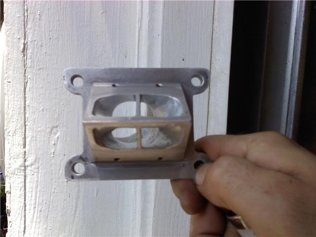

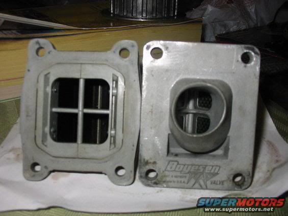

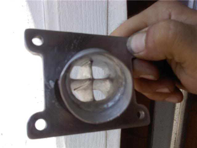

Posted: Sun Sep 07, 2014 6:12 pm
All the guys running ported, stroked, big bore, big carb, etc etc motors have the same issue I see...
the rad valve is too small to Breath a modded motor.... A Cork if you will
so they all port them out..
Not saying these pictures are done well or even correctly for that matter... just example..
Before.
Motorrads Jeff Wards Engine build round 2 9-9991.jpg (31.15 KiB) Viewed 7159 times
AFTER
Motorrads Jeff Wards Engine build round 2 9-9992.jpg (31.35 KiB) Viewed 7159 times
Motorrads Jeff Wards Engine build round 2 9-9993.jpg (31.62 KiB) Viewed 7159 times
Motorrads Jeff Wards Engine build round 2 9-9994.jpg (21.23 KiB) Viewed 7159 times

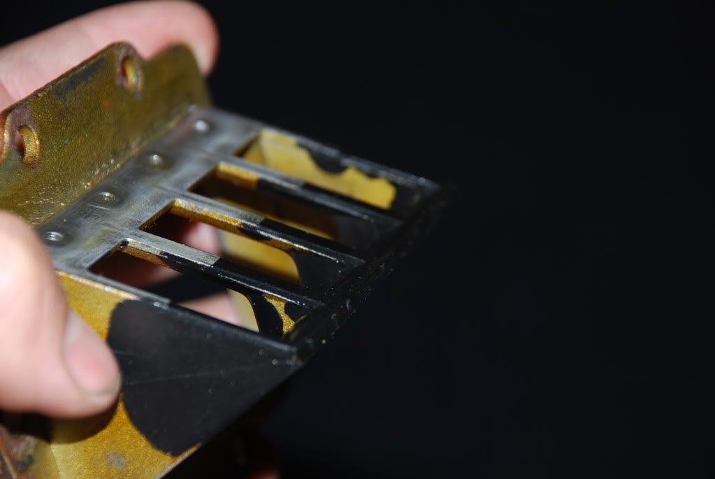

Okay.. interesting Bit of info to share...
I fired an email off to Moto Tassinari, explaining the issues Im having (and the fact you can see daylight through these cages)...
and this is the responce I got.
"David
Is the bike modded? Race gas or alcohol? The reeds may not be stiff enough. Send me your address and I will get you a different set up.
Best Regards
Jeff
Moto Tassinari"
Will Be very interesting to see what I end up with huh

Posted: Sun Sep 07, 2014 6:17 pm
2-Stroke Tom:
I'll be following this closely, because so far I am just getting more reassurance to stick with the stock reed and cage setup. The fit of the V-force III is unacceptable to me, and I was always surprised to see so many people endorsing them. I guess in a pure horsepower competition, from what I've read (but never personally tested) the V-force III reeds may be the winner when they are brand new. After they warp from heat and use, will they still offer the same performance?
Motorrad:
I have a brand new set sitting here on my bench. (sent to me by mistake, was supposed to be a set of Vforce 2's)... So before i sent them back... I took the liberty to open them, and inspect..
Yep.. Daylight....
Also water timed it..
Not good... there is no way this thing will seal my Stuffed motor...
Id still like a set of V2's to give a shot.. as they seemed to have a stronger petal tension, and the one I had in my hand oh about a year ago now. seemed to have good petal to cage seal.. Sure screws come out... Just RTV them to the cage, like we used to do to all the metal cages...

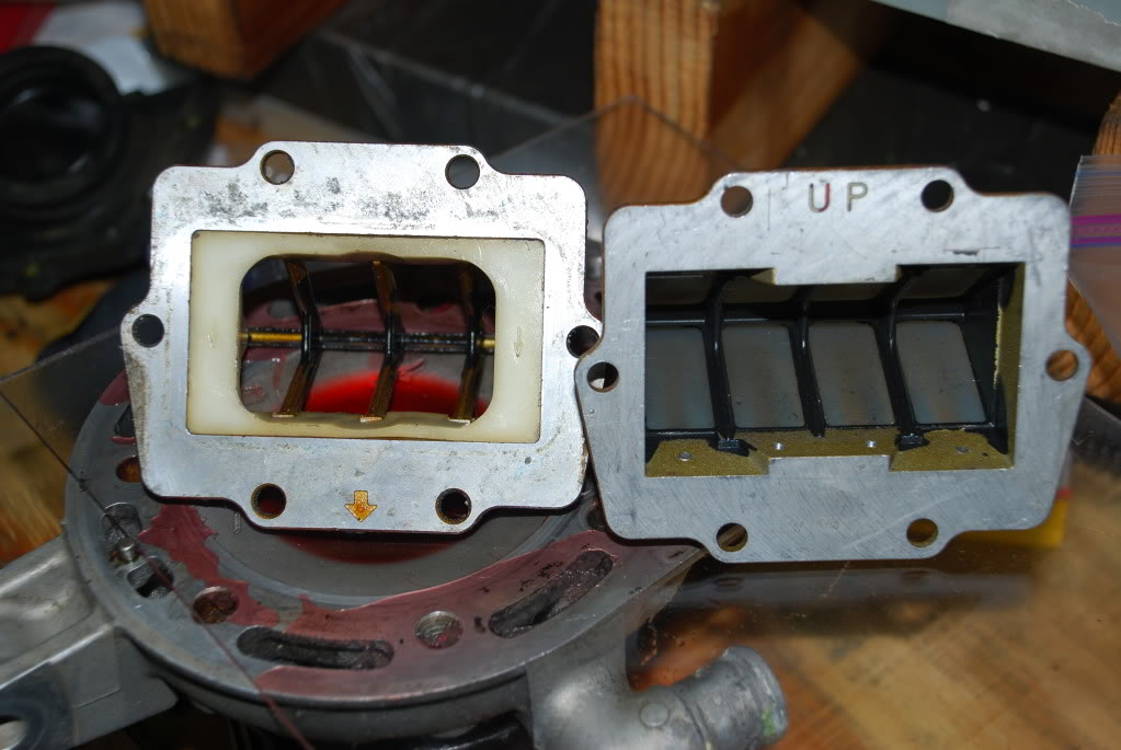

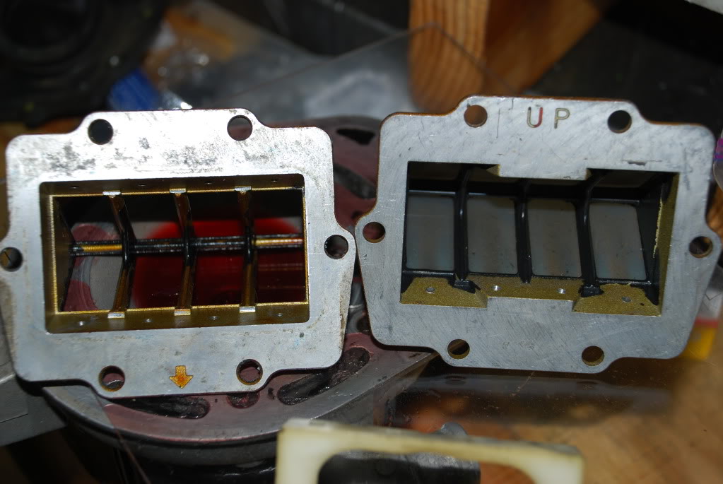

Posted: Sun Sep 07, 2014 6:20 pm
Not sure what Vforce is sending me in the mail... Will wait to see what it is before I move forward with this....
But I may have accidentally stumbled onto my New setup... evil grin

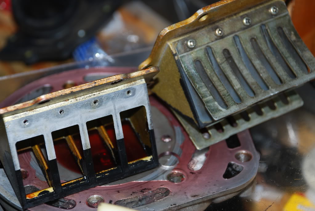

I vaguely remembered my 87 having a air guide (stuffer) like the V3 reeds do...
so I went up in the loft today to dig out the reed cage off my 87..
Few things different..
1. it has a stuffer/air director BONUS..
2. its missing one ridge in the middle of the cage. (???strength???).
3. NO reed stops..??Could have been removed sometime in its life??.. Havnt consulted Parts diagrams.. BUT the reed stops off the newer cage bolt on...
4. Its rubber coated, but not like the later cage that RAISED the reeds up with a rubber ridge, its rubber coated FLAT,so this would be less prone to blowback vs the newer cage... So I could get away with a softer reed possibly...
I think Im going to build a HIBREED cage.. consisting of.
1987 reed cage,
1987 reed stuffer
1988-04 reed stops
Carbon Tech "smooth power band" reeds
NOW Stand back and watch all the 1987 reed blocks get bought off ebay rolleyes
