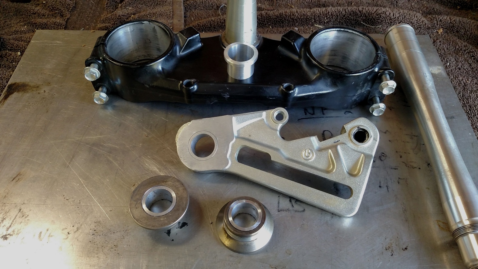

I think the site is great. Sure has gave me a head start on a lot of questions. Also hope to add some info to help others.
I was really trying to use KX trees to use the plastics. Old enough I though machining parts to make them work would be less of a hassle to rig a number plate and fender, haha.
I'll look into the "retaining compound" from loctite, Curious what minimal fit is needed to work? We at one time had Belzona at work. But all I found was some dried up canisters. More I thought about it, the top bearing surface isn't perfect on the stem, so I might want to remove the stem later and swap it out, so I moved away from the permanent options.
You know, if you look closely at the frame head tube, you can tell they just welded bearing cups on the top and bottom. I really think the easiest fix to a modern front end is to change the top cup altogether. Its one cut around to the top tube, a little debur bit action around the top tube gusset, weld in new bearing cup and you are done. Would not even need a frame jig. Two tapered cones and a piece of all thread would be a great tool to align the cups and pull string from to verify top cup is centered with top tube.

Awesome idea.
Do, it, document it, and post it here 8-)
