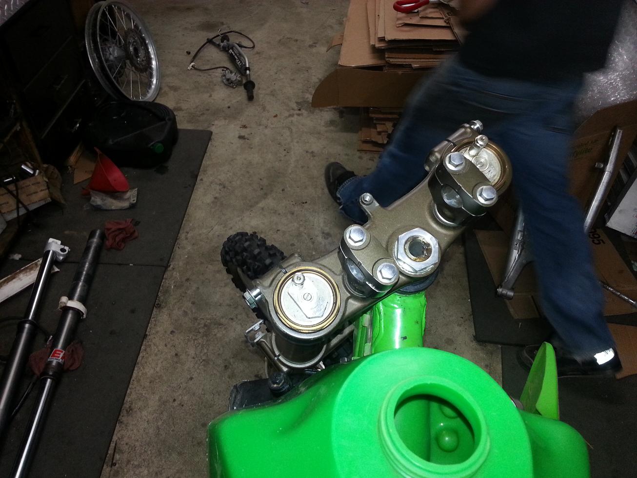

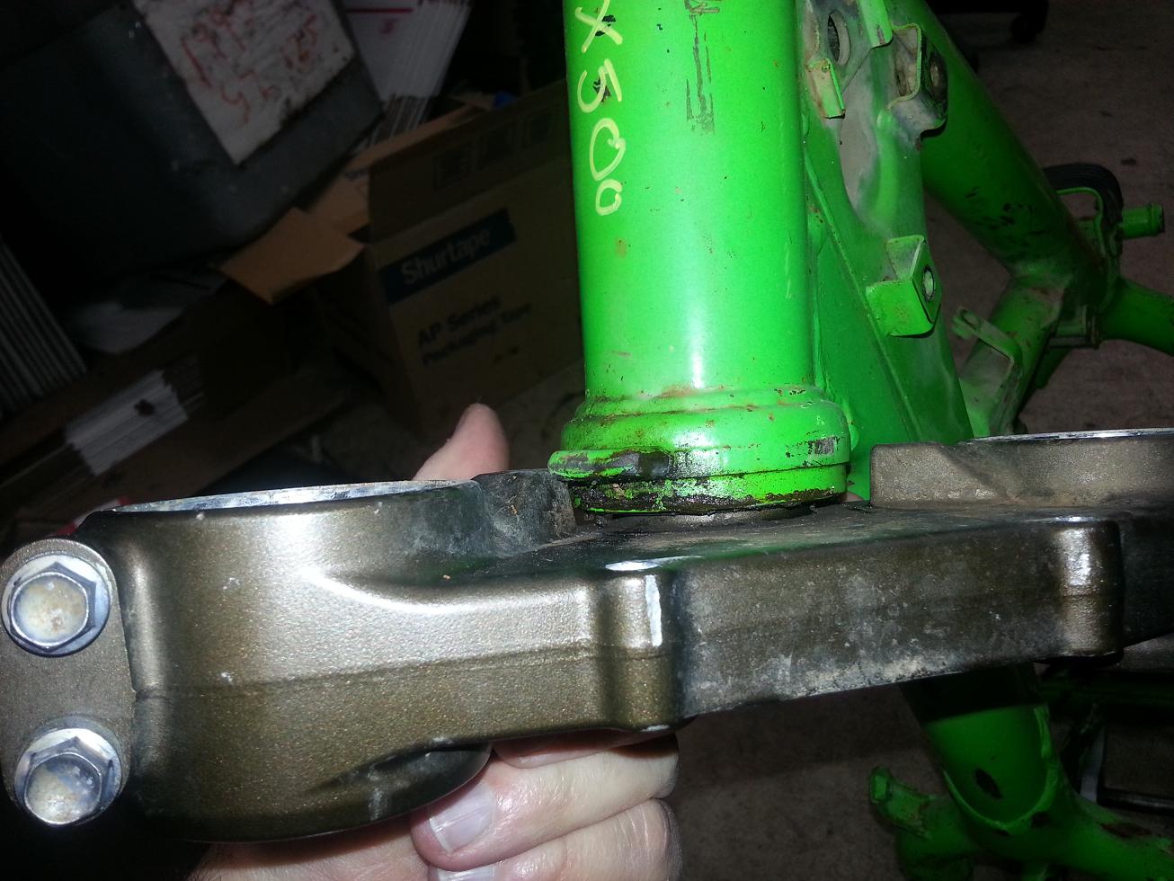

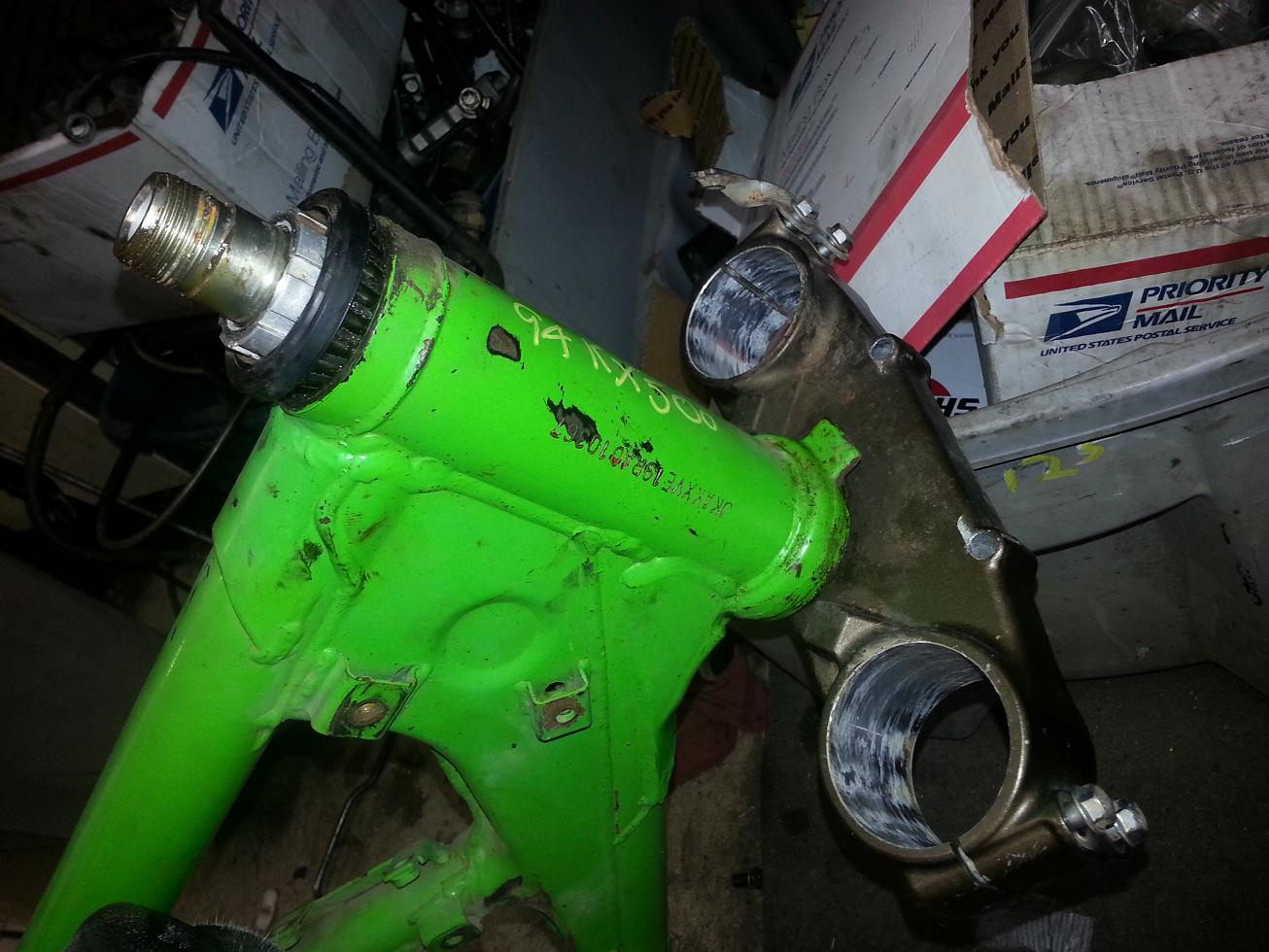

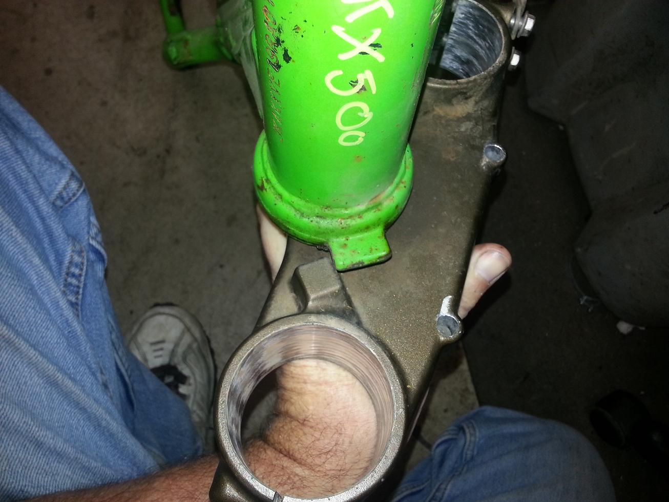

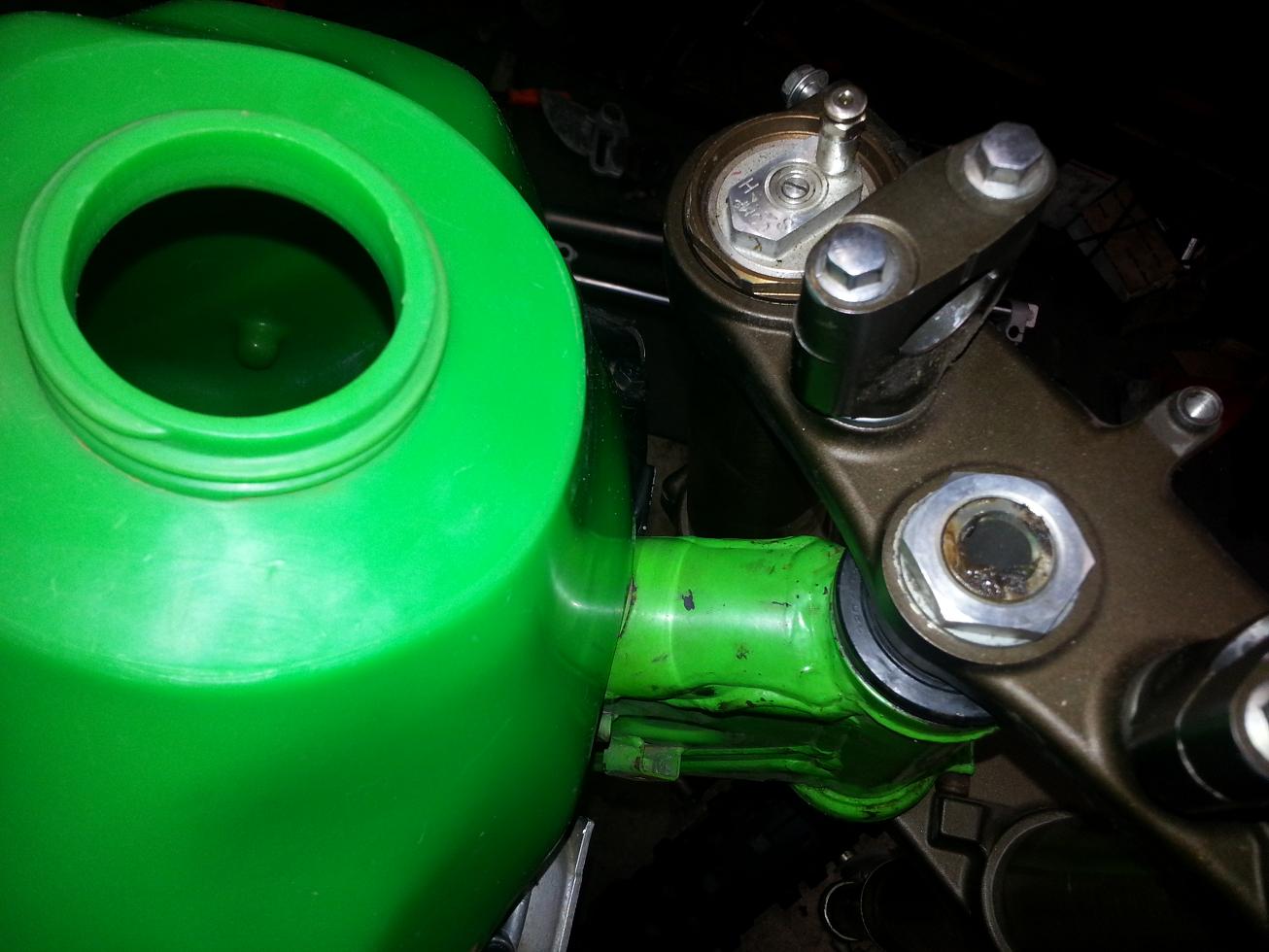

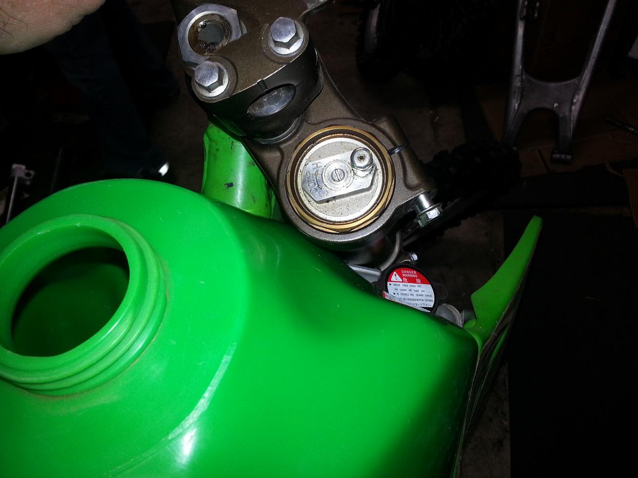

First off, will the triple clamps bolt right up?
Nope...
Let's take a look at why not..

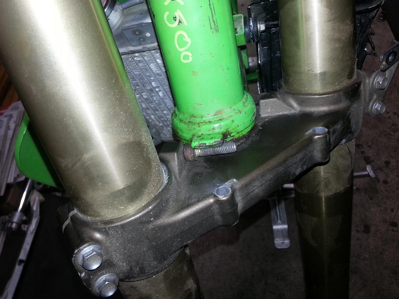

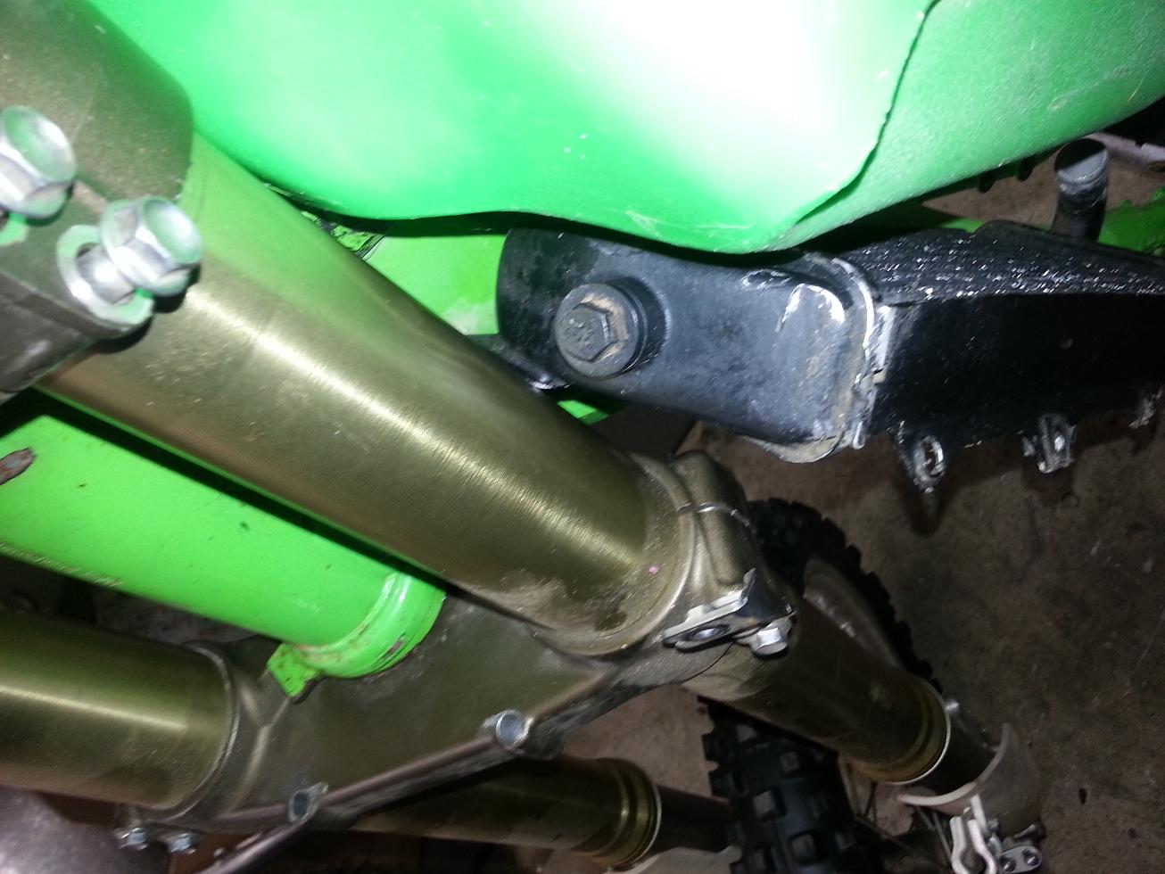

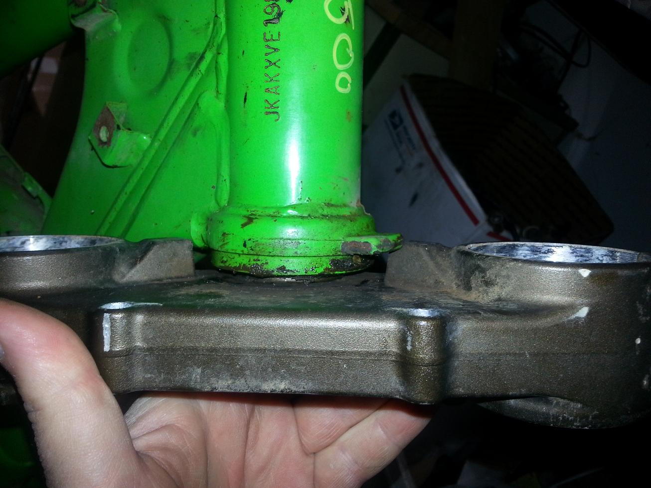

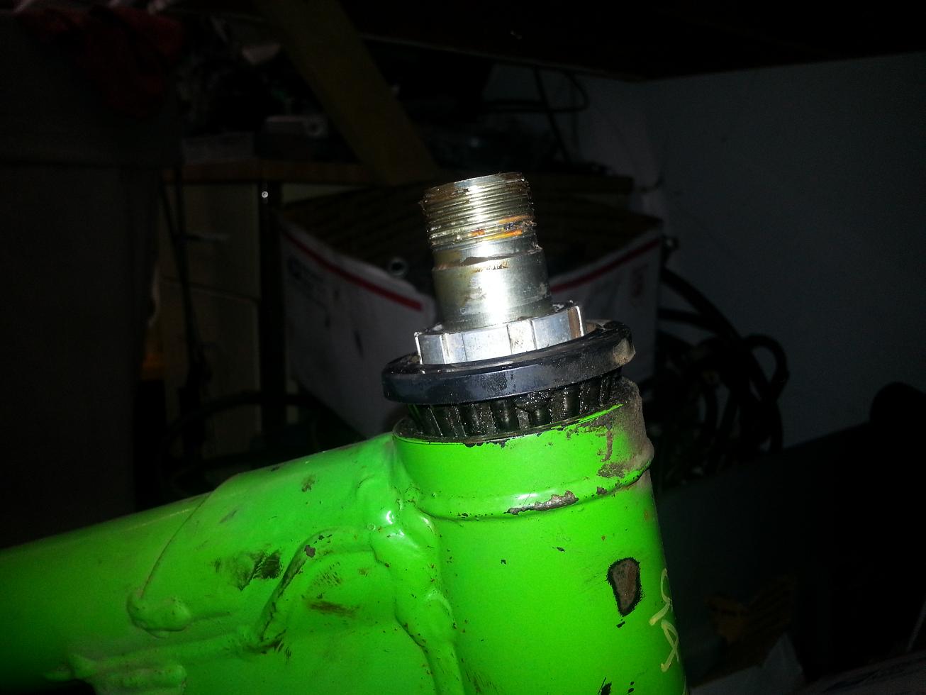

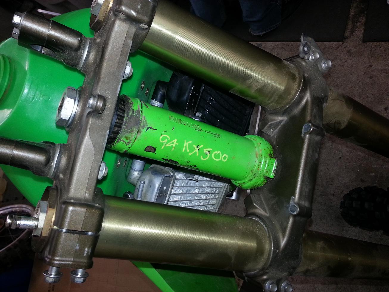

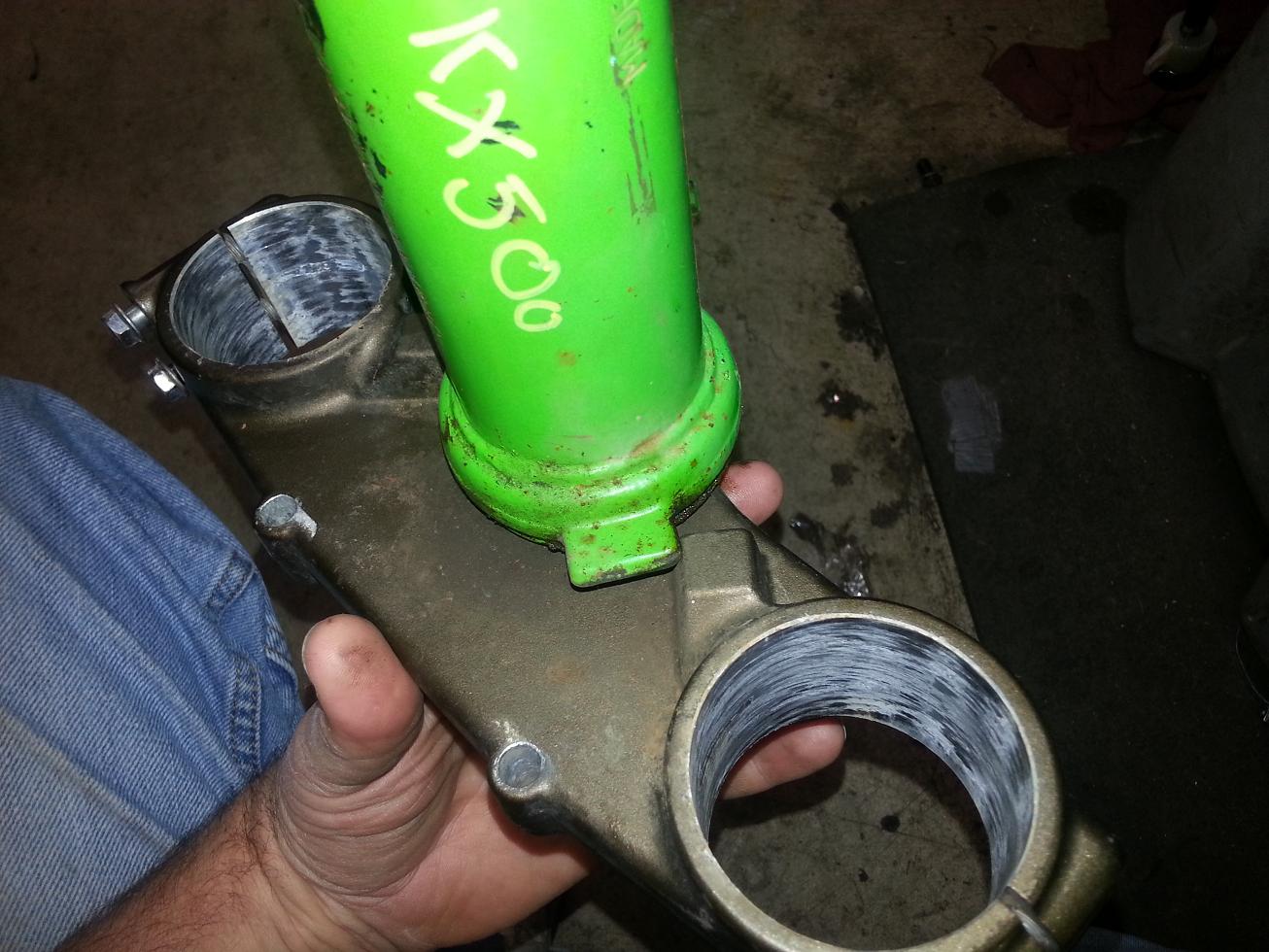

What I am using for this demonstration is a 94 KX500 frame and a 07 KX250F triple clamp.
KX500 FRAME WITH A 07 KX250F TRIPLE CLAMP 1.JPG (158.97 KiB) Viewed 24003 times
KX500 FRAME WITH A 07 KX250F TRIPLE CLAMP 2.JPG (159.26 KiB) Viewed 24003 times
KX500 FRAME WITH A 07 KX250F TRIPLE CLAMP 3.JPG (161.05 KiB) Viewed 24003 times
KX500 FRAME WITH A 07 KX250F TRIPLE CLAMP 4.JPG (140.42 KiB) Viewed 24003 times
KX500 FRAME WITH A 07 KX250F TRIPLE CLAMP 5.JPG (166.78 KiB) Viewed 24002 times
KX500 FRAME WITH A 07 KX250F TRIPLE CLAMP 6.JPG (94.23 KiB) Viewed 24002 times

Thanks for looking into this swap Sandblaster! I have a few comments that may help someone who is considering this swap.
The first thing I found when I began researching this swap is that the KX500 and 07 KX250F share the same lower steering head bearing.
This allows the 250F triples to slide into the KX500 frame, and everything is taken care of as far as the LOWER bearing goes.
The LOWER bearing (All Balls Racing, Part #99-3519-5) dimensions for both bikes are:
30mm I.D.
55mm O.D.
17mm Height
The UPPER steering head bearings are different between the two bikes. :(
The KX500 UPPER bearing (All Balls Racing, Part #32205-5) dimensions are:
25mm I.D.
52mm O.D.
19mm Height
The KX250F UPPER bearing (All Balls Racing, Part #99-3513-5) dimensions are:
28mm I.D.
52mm O.D.
16mm Height
As you can see, both the KX250F, and the KX500 use the same O.D. on the upper bearing. This is good! :mrgreen: That means that the UPPER bearing pocket in both frames has the same O.D.
However, the two bikes use a different I.D (25mm vs. 28mm) on the UPPER bearing because the 250F uses a steering stem with a 3mm larger diameter.
The solution is to use the 2007 KX250F UPPER bearing and race in the UPPER location of the KX500 steering head.
This should work because the KX 250F UPPER bearing (All Balls Racing, Part #99-3513-5) has the 28mm I.D. to fit the top of the 250F stem, and a 52mm O.D. to fit the UPPER bearing pocket on the KX500 frame.
Also, the two bikes use a different bearing height or thickness (19mm vs. 16mm) on the UPPER bearing because the 250F uses a shorter, or thinner UPPER bearing.
To solve this problem, we install a spacer or large washer into the KX500 UPPER steering head bearing pocket PRIOR TO installing the KX250F upper bearing. This spacer or washer must have a thickness of 3mm (19mm KX500 bearing - 16mm KX250F bearing = 3mm spacer needed), a 28mm I.D. , and a 52mm O.D.
Following the previously described procedure SHOULD allow the KX250F triple clamps to be bolted into the KX500 frame without the need to have a new stem pressed into the KX250F triple clamps. Then we can continue to address the issue regarding differences in the steering stop locations between the two bikes, as Sandblaster has so beautifully done in his pictorial posts above.

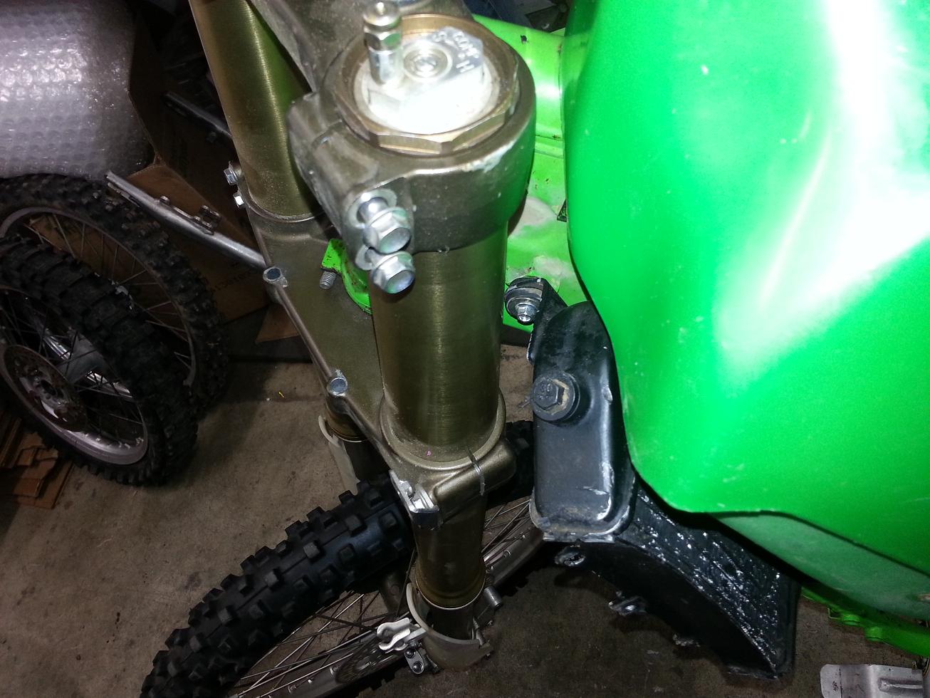

What we have here is a 94 KX500 frame mounted up with a front end from a 07 KX250F.
We already discussed the need for a different steering stem.
Here is the front end mounted up.

The next pics show the front end turned all the way to the right.
As you can see, the forks touch the gas tank and just barely miss the right radiator... Not good....

The next pic shows the front end turned all the way to the left.
KX250F 2007 FORKS ON A 94 KX500 FRAME 6.JPG (190.51 KiB) Viewed 23991 times
As you can see the forks hit the gas tank and the radiator.

Not really.
It will take very little to fix this problem.
Something as simple a bolt welded to the bottom of the steel stop on the frame will easily fix this issue.
KX250F 2007 FORKS ON A 94 KX500 FRAME 8.JPG (193.4 KiB) Viewed 23991 times
With the bolt sitting there and the forks turned all the way to the left you can see that there is plenty of room...
KX250F 2007 FORKS ON A 94 KX500 FRAME 9.JPG (116.39 KiB) Viewed 23991 times
KX250F 2007 FORKS ON A 94 KX500 FRAME 10.JPG (158.37 KiB) Viewed 23991 times
KX250F 2007 FORKS ON A 94 KX500 FRAME 11.JPG (160.24 KiB) Viewed 23991 times
Not shown in the pics is the steering turned all the way to the right, there is also plenty of room.
In fact, there is room for a narrower bolt head, block of steel, or if you wanted to get really fancy you could use a block that is tapped all the way through and you could install a bolt in either end that you could adjust exactly at what point the stops worked.
