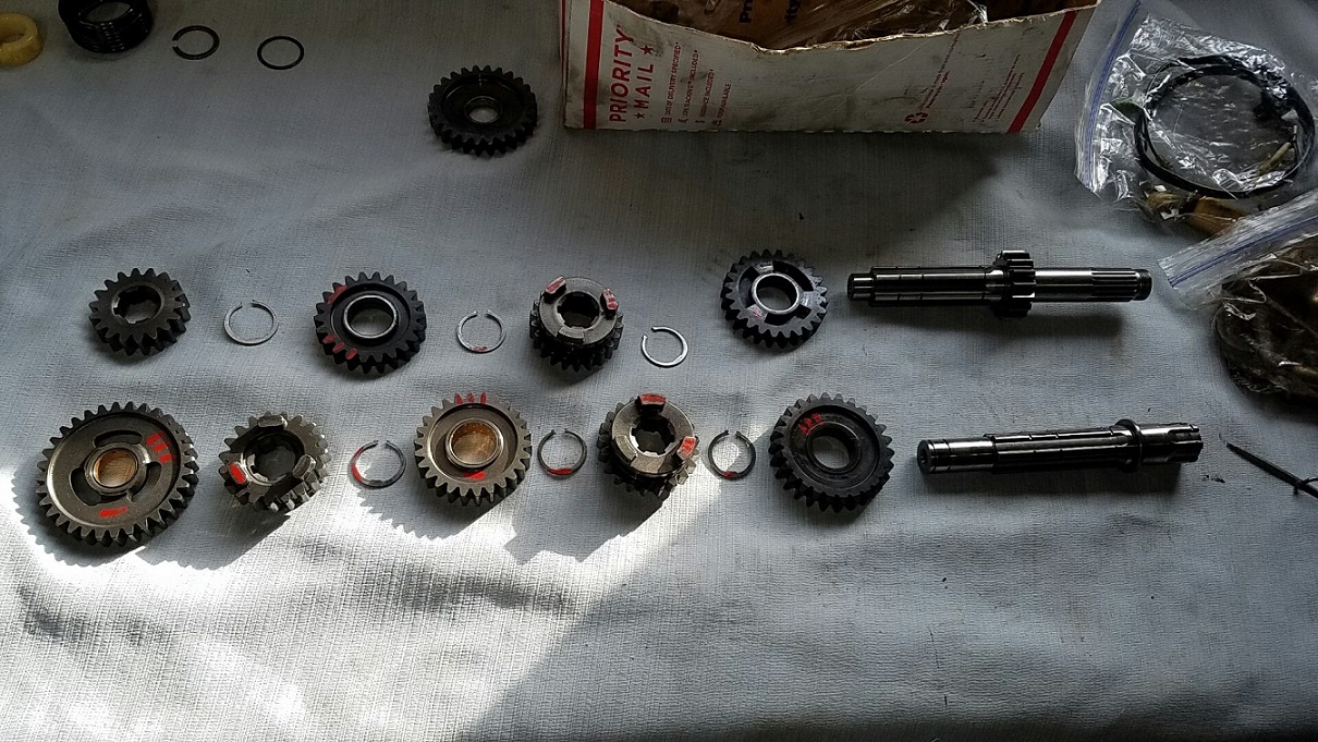

Ok, back to the nuts and bolts of this build.
We already inspected this trans once before but it never hurts to do a double check.
KX GURU RACING SEAN COLLIER KX500 304.JPG (414.68 KiB) Viewed 10318 times

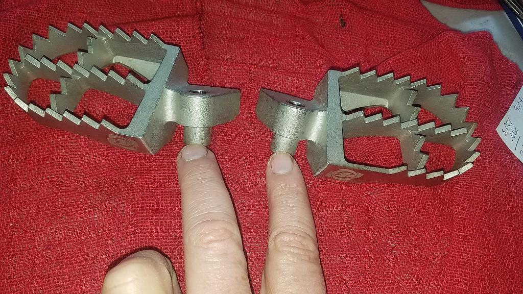

Torque one sent us some killer foot pegs for a YZ450F.
But they won't fit on a KX500.
KX GURU RACING SEAN COLLIER KX500 315.JPG (198.8 KiB) Viewed 10282 times

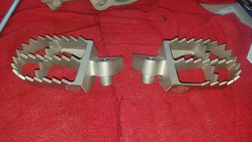

But they still won't fit...
KX GURU RACING SEAN COLLIER KX500 318.JPG (99.08 KiB) Viewed 10281 times

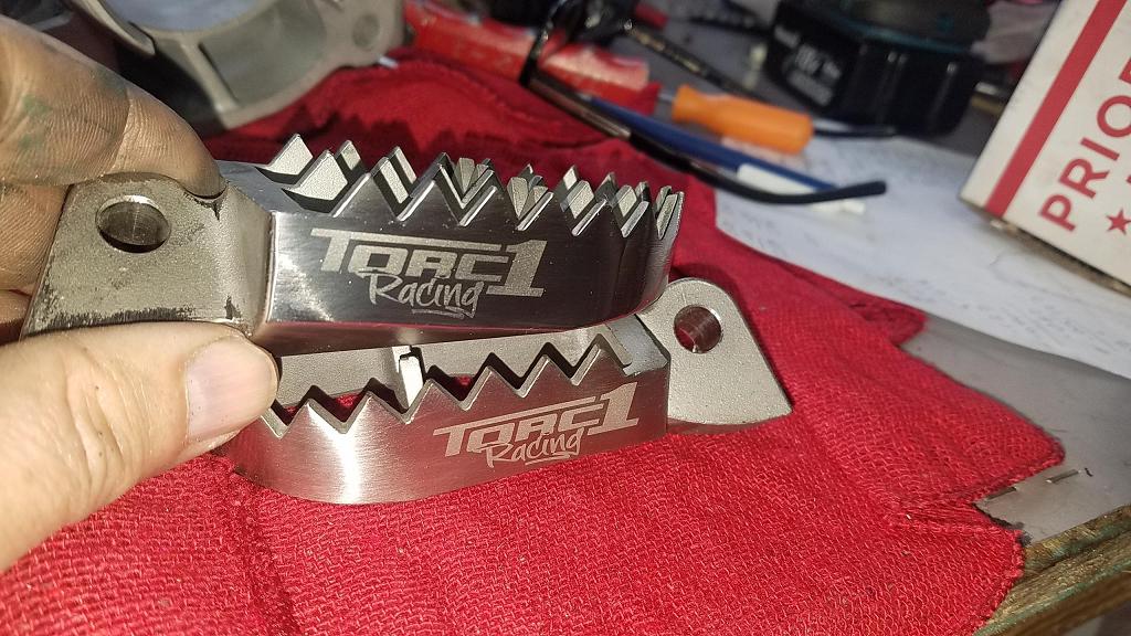

The web is just too thick...
So into the vice for a little hand work..
KX GURU RACING SEAN COLLIER KX500 319.JPG (131.11 KiB) Viewed 10281 times
Grind, grind, grind, file, file, file...
Check it often... Unless you have a mill, then just mill it to the correct thickness..
KX GURU RACING SEAN COLLIER KX500 320.JPG (368.89 KiB) Viewed 10281 times
Make sure it rotates freely with no obstructions..

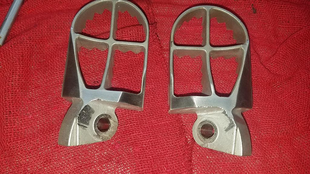

But, your still not done...
You will need to remove some more material as shown in yellow.
Go slow and do a ton of test fitting..
KX GURU RACING SEAN COLLIER KX500 319.JPG (130.96 KiB) Viewed 10278 times

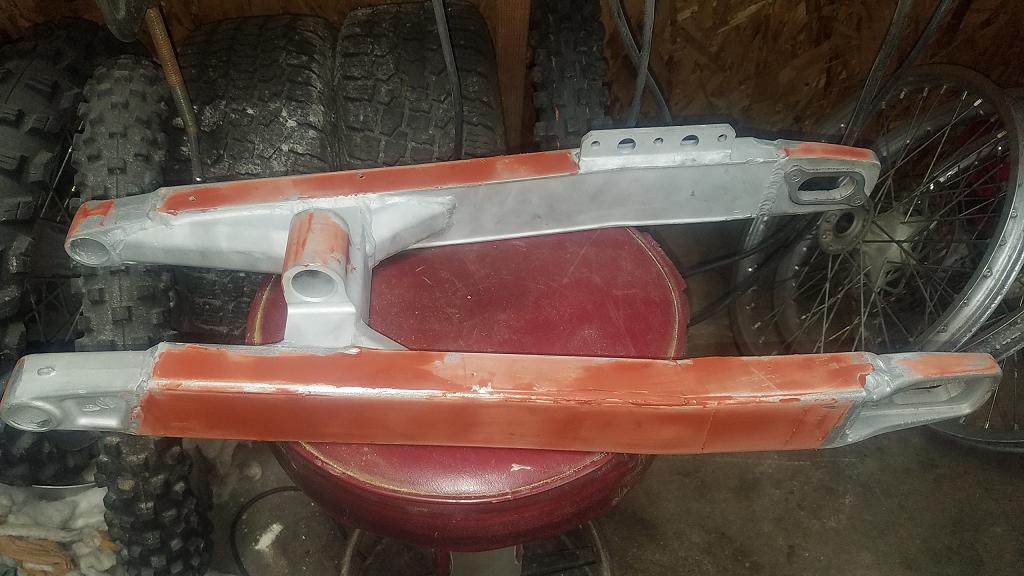

Our donor swing arm was a bit beat up so a little sanding, a little putty, a little more sanding..
KX GURU RACING SEAN COLLIER KX500 322.JPG (91.07 KiB) Viewed 10274 times
Re: Sean Colliers KX500 build
Posted: Sun Nov 13, 2016 4:32 am
More putty, more sanding...
KX GURU RACING SEAN COLLIER KX500 323.JPG (104.72 KiB) Viewed 10265 times
KX GURU RACING SEAN COLLIER KX500 324.JPG (106.88 KiB) Viewed 10265 times

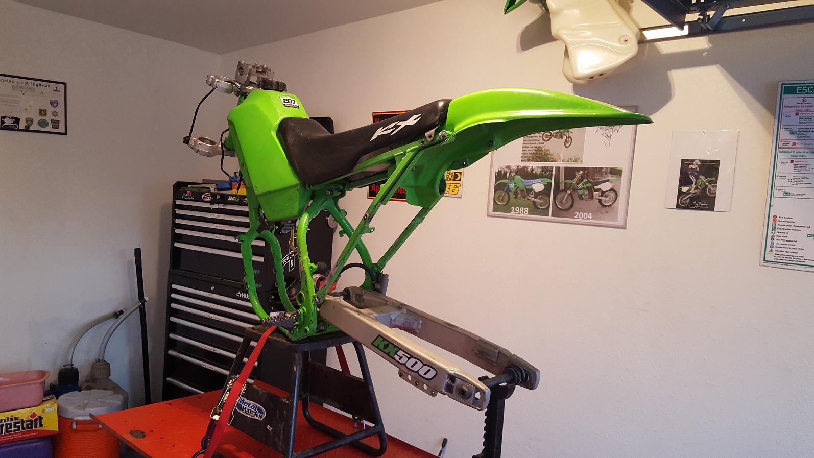

2 weeks till Race day and this is where we are at.
KX GURU RACING SEAN COLLIER KX500 325.JPG (167.78 KiB) Viewed 10265 times
I don't have any engine internals... Or Suspension internals.... :o

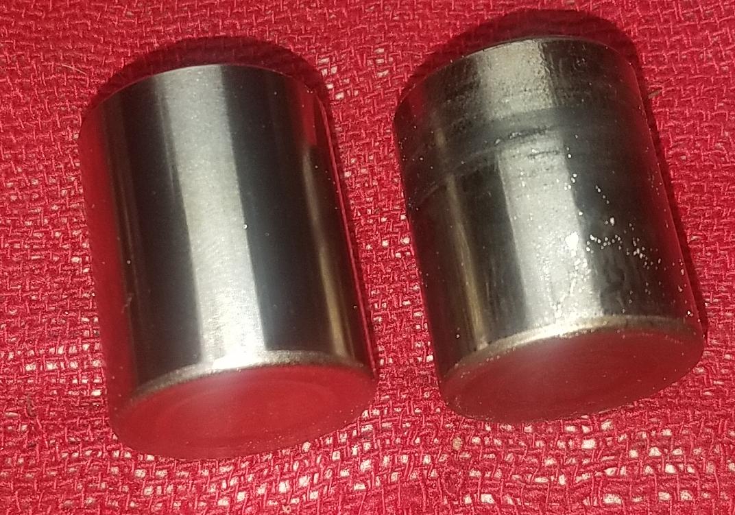

I'm rebuilding the Rev 2 rear brake with a new piston and seals..
KX GURU RACING SEAN COLLIER KX500 326.JPG (160.04 KiB) Viewed 10257 times
A little more spot putty, a little more sanding, a little more painting...
KX GURU RACING SEAN COLLIER KX500 327.JPG (91.49 KiB) Viewed 10257 times
