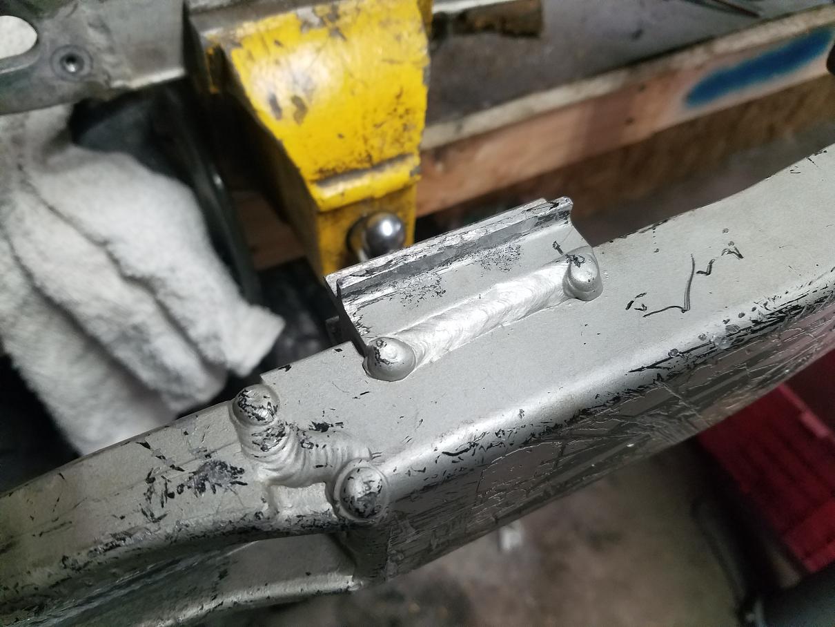

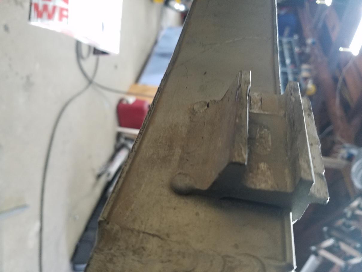

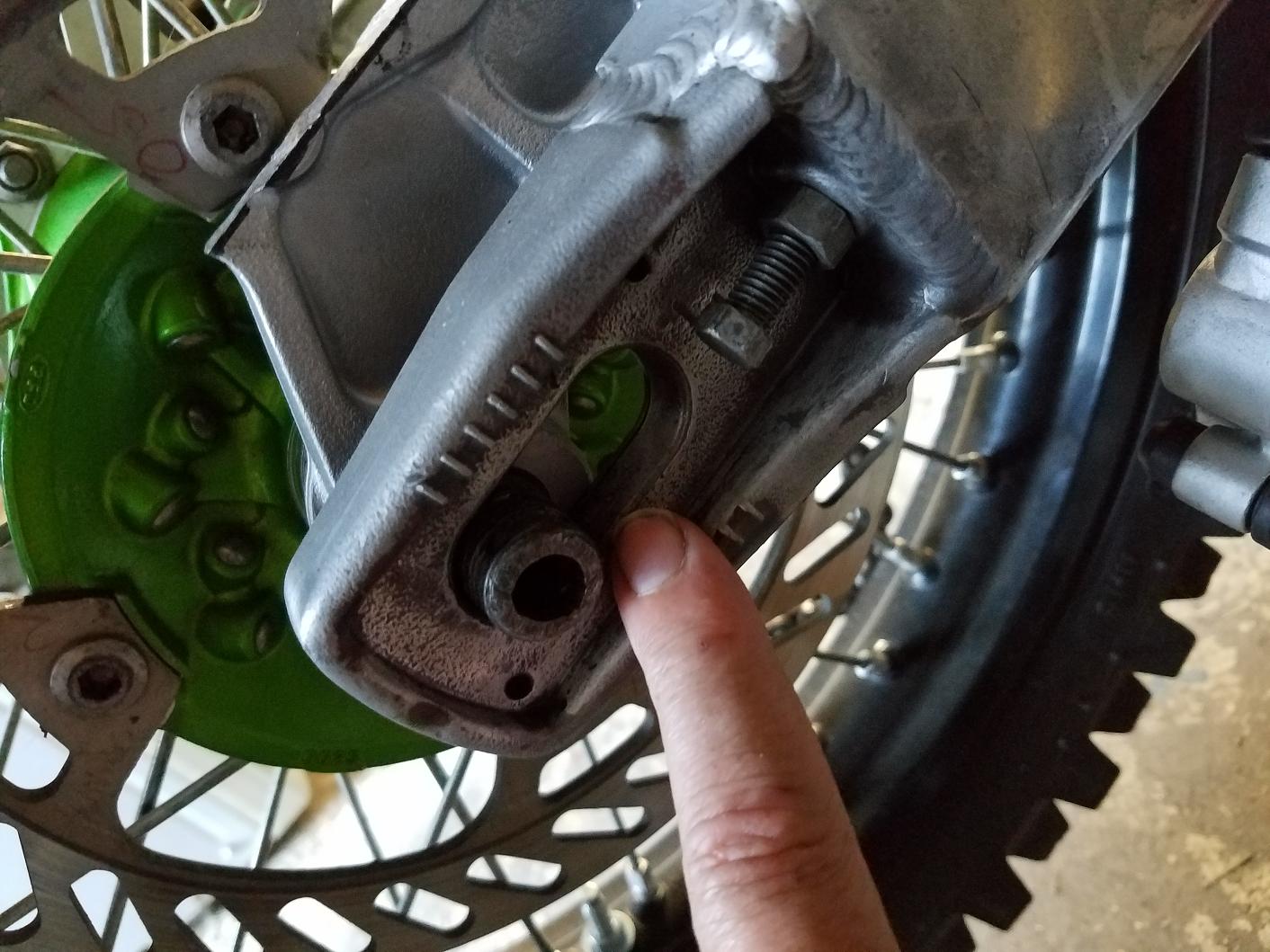

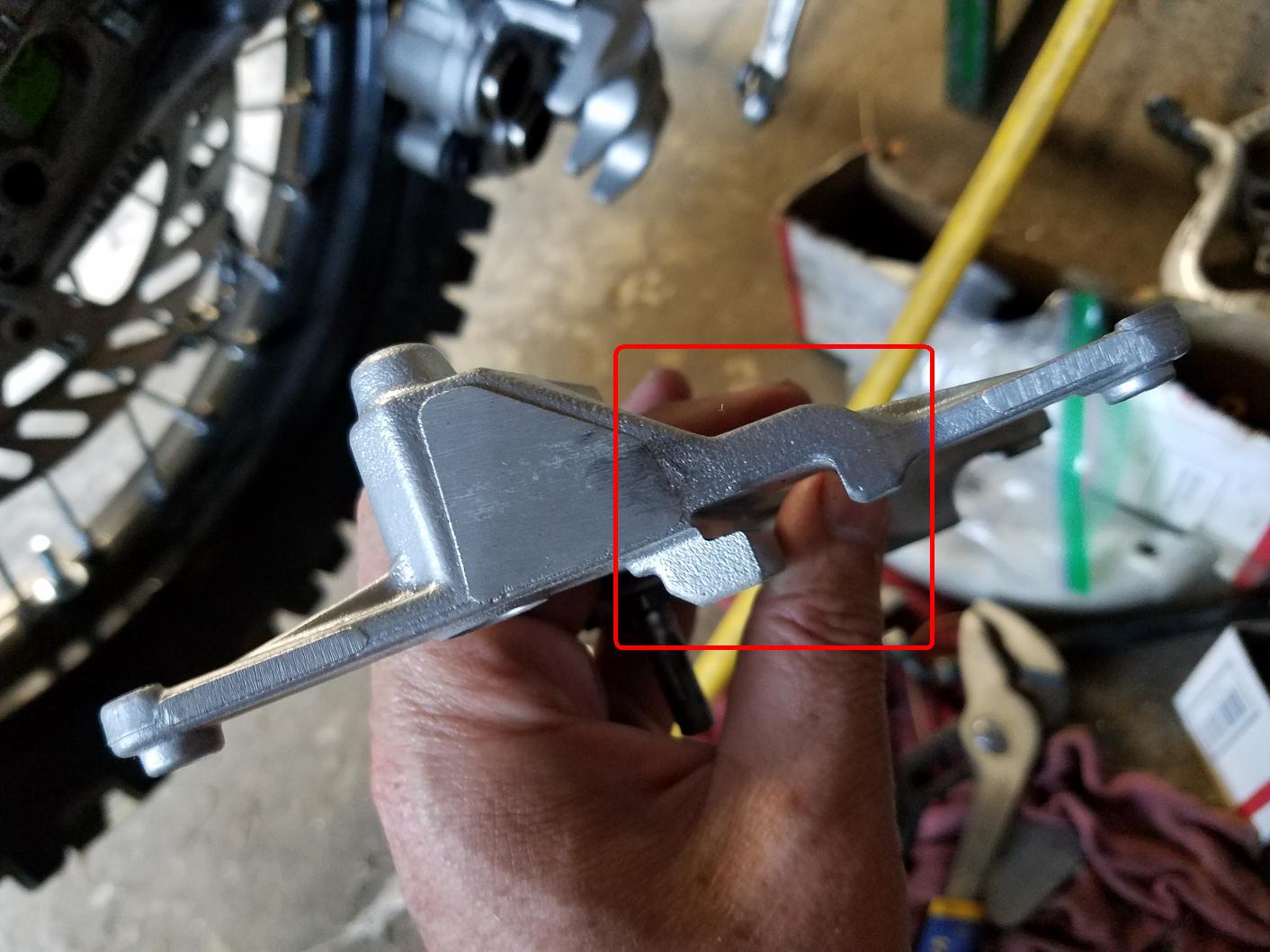

Because we are using the KX450F rear wheel with axle, blocks, and adjusters, we will need to machine these slots to 25mm
I will need to make a new hanger on the inside of the swing arm to fit the KX450F rear brake caliper mount.
So this guy has gotta go..
Re: Sean Colliers KX500 build

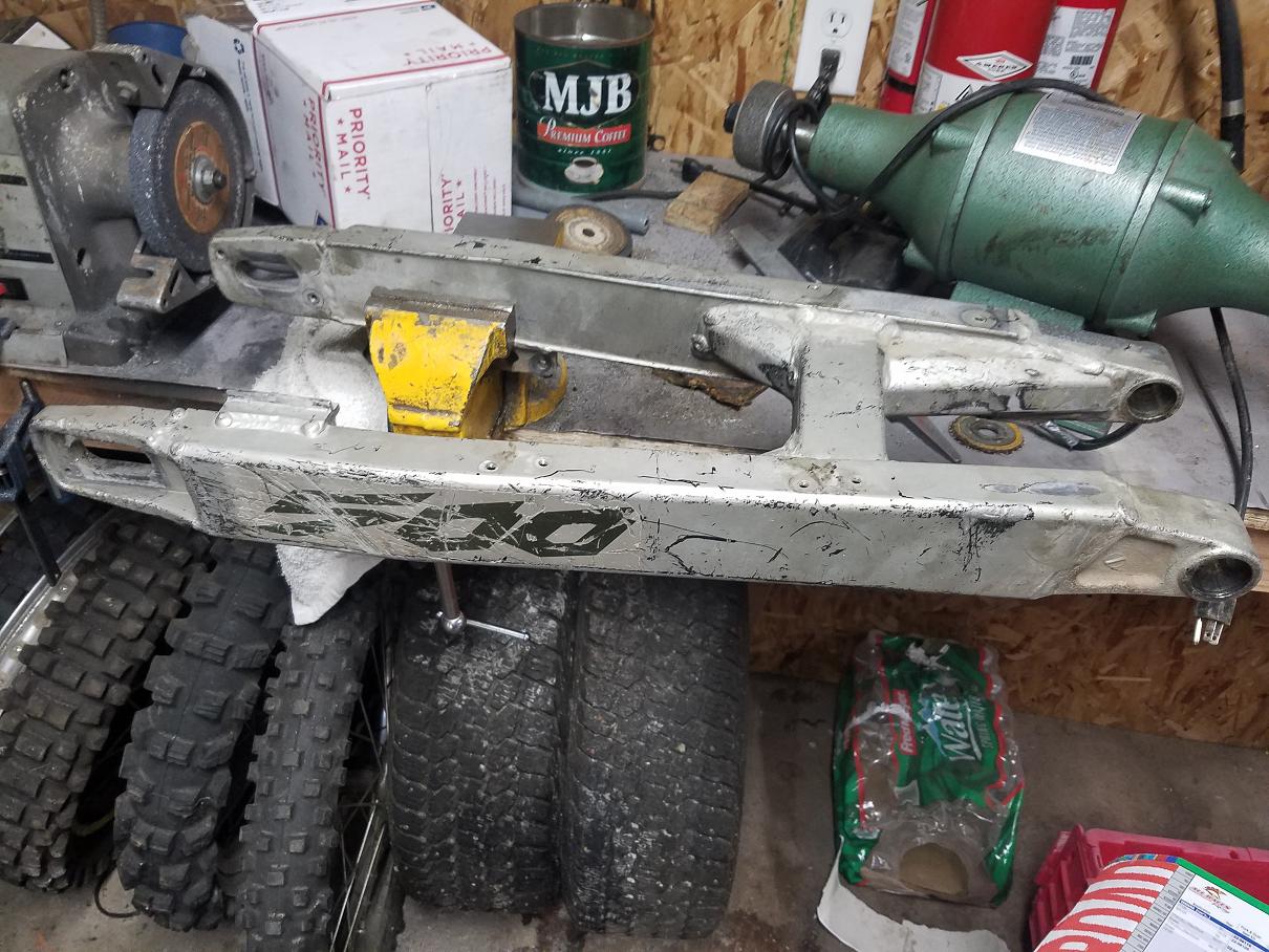

A friend of mine donated a KX500 swingarm for me to ruin...eeeerrrrrr... modify :shock:
KX GURU RACING SEAN COLLIER KX500 101.JPG (212.76 KiB) Viewed 25633 times

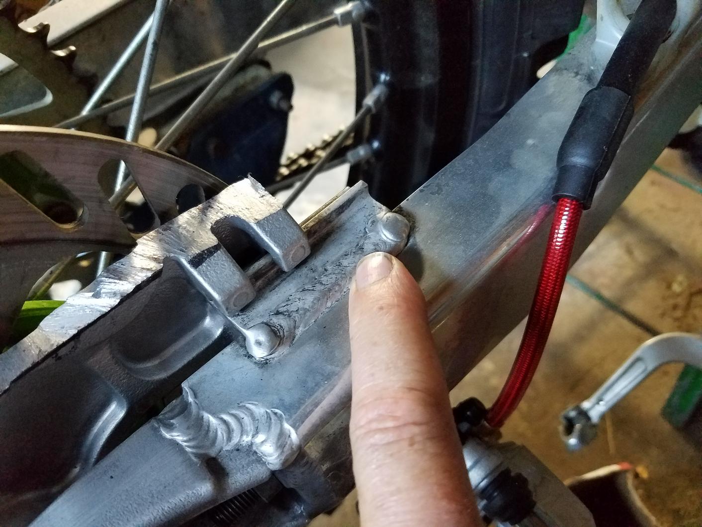

Again, this mount for the KX500 rear brake mount has got to go..
KX GURU RACING SEAN COLLIER KX500 102.JPG (148.21 KiB) Viewed 25633 times
KX GURU RACING SEAN COLLIER KX500 103.JPG (88.99 KiB) Viewed 25633 times

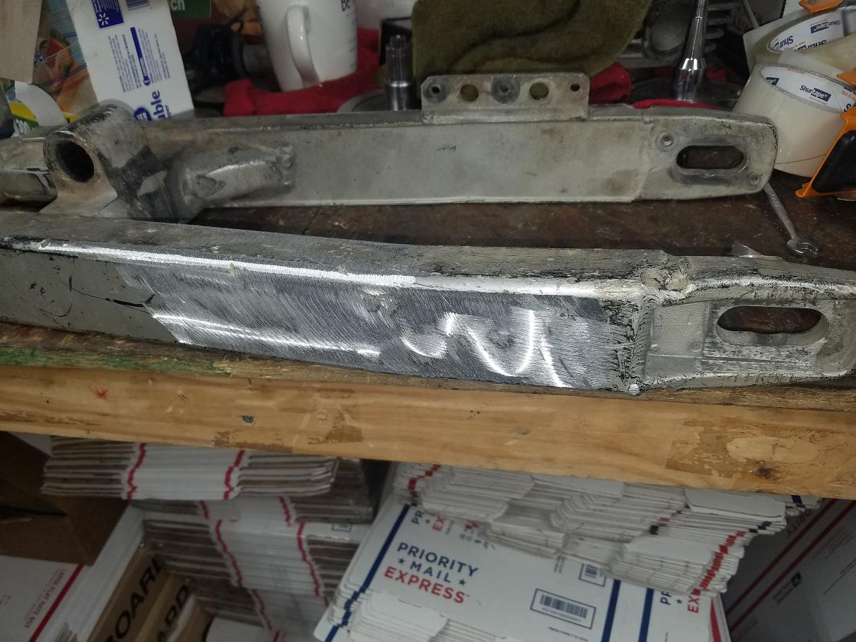

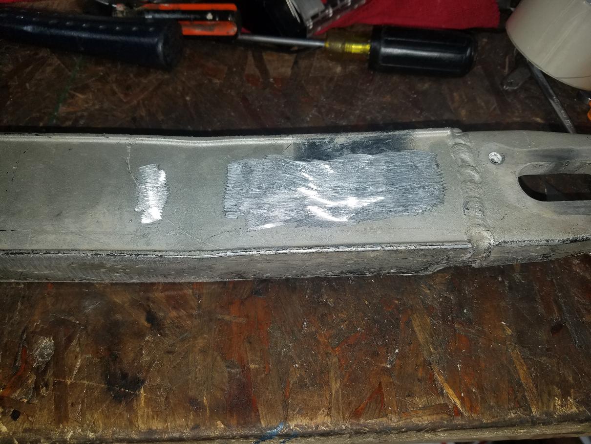

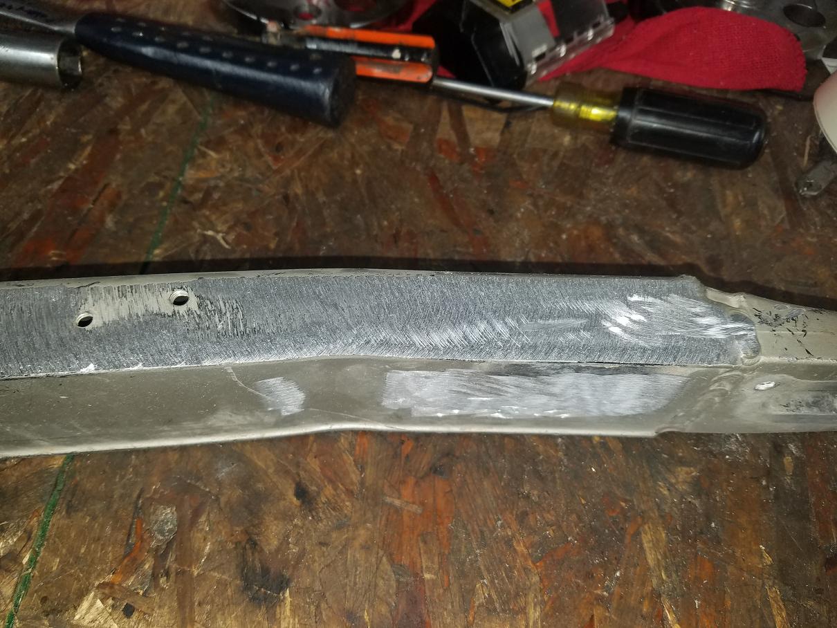

All gone...
KX GURU RACING SEAN COLLIER KX500 104.JPG (176.86 KiB) Viewed 25632 times
KX GURU RACING SEAN COLLIER KX500 105.JPG (204.87 KiB) Viewed 25632 times
KX GURU RACING SEAN COLLIER KX500 106.JPG (188.88 KiB) Viewed 25632 times
Tomorrow I will get it sand blasted and start working on the new caliper mount.

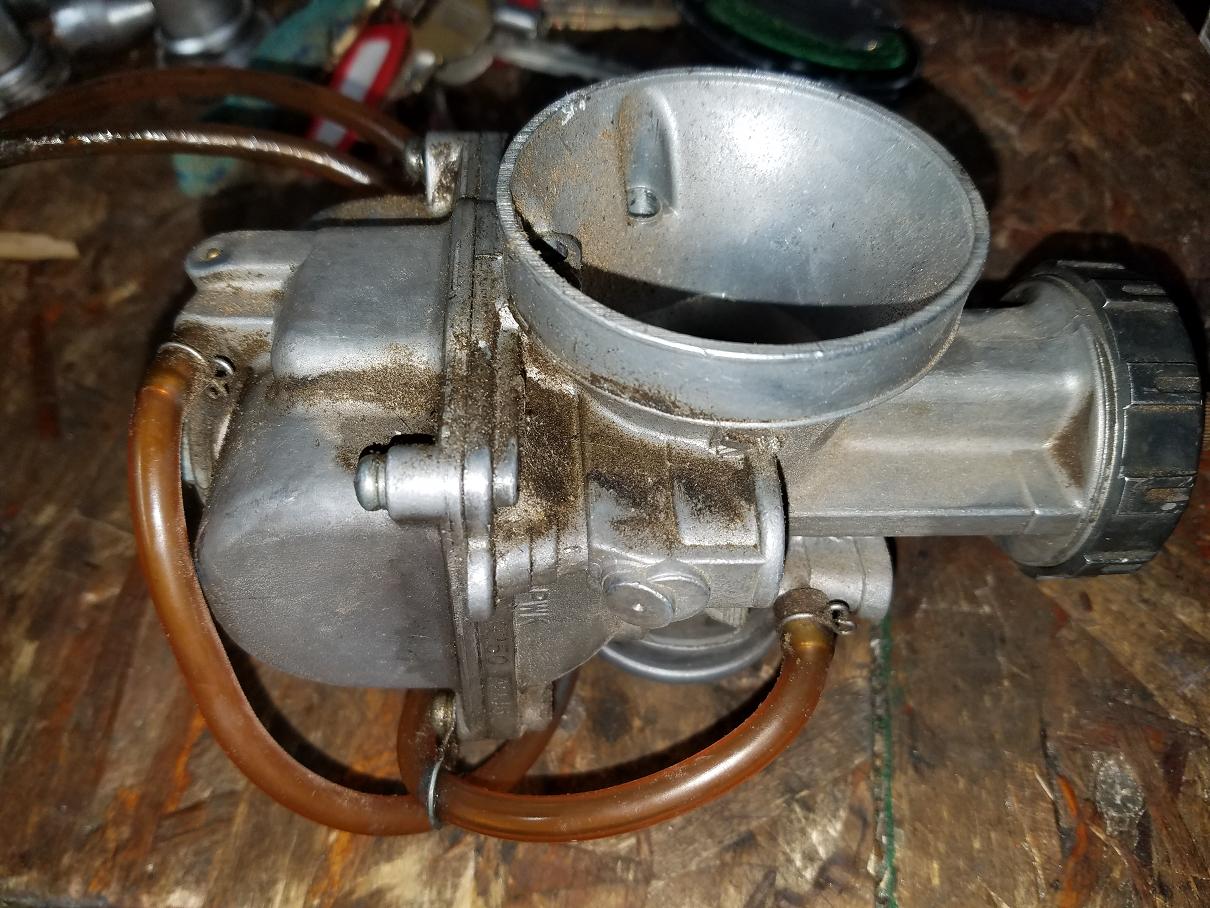

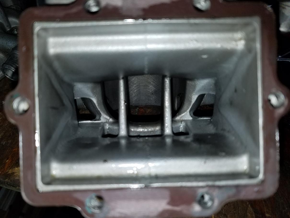

Let's see what we have to work with...
Dirty carb... Check!
KX GURU RACING SEAN COLLIER KX500 109.JPG (193.36 KiB) Viewed 25624 times
Dirty head... Check!
KX GURU RACING SEAN COLLIER KX500 110.JPG (331.91 KiB) Viewed 25624 times

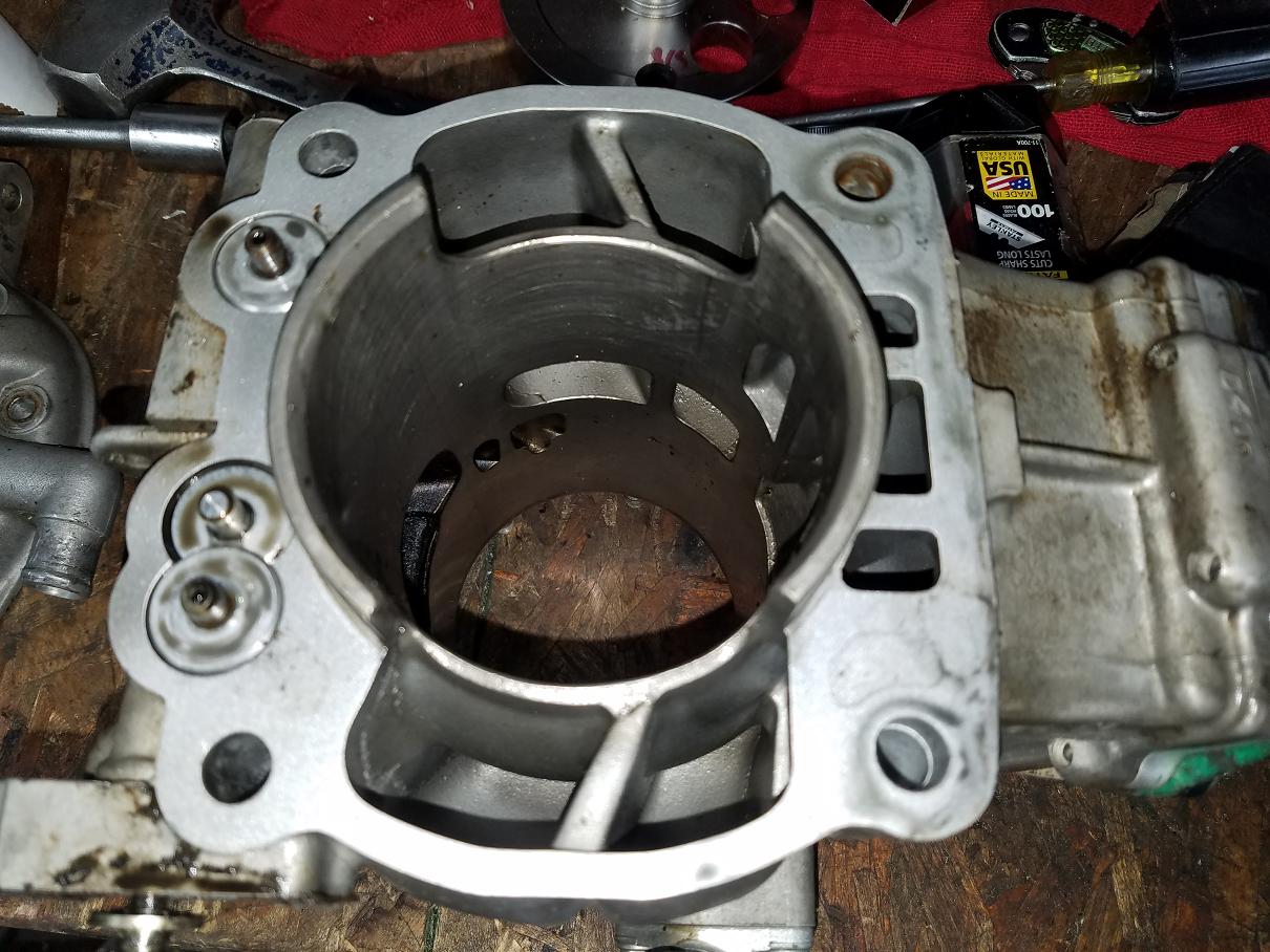

Dirty stock cylinder.... Check!
KX GURU RACING SEAN COLLIER KX500 111.JPG (180.96 KiB) Viewed 25623 times
