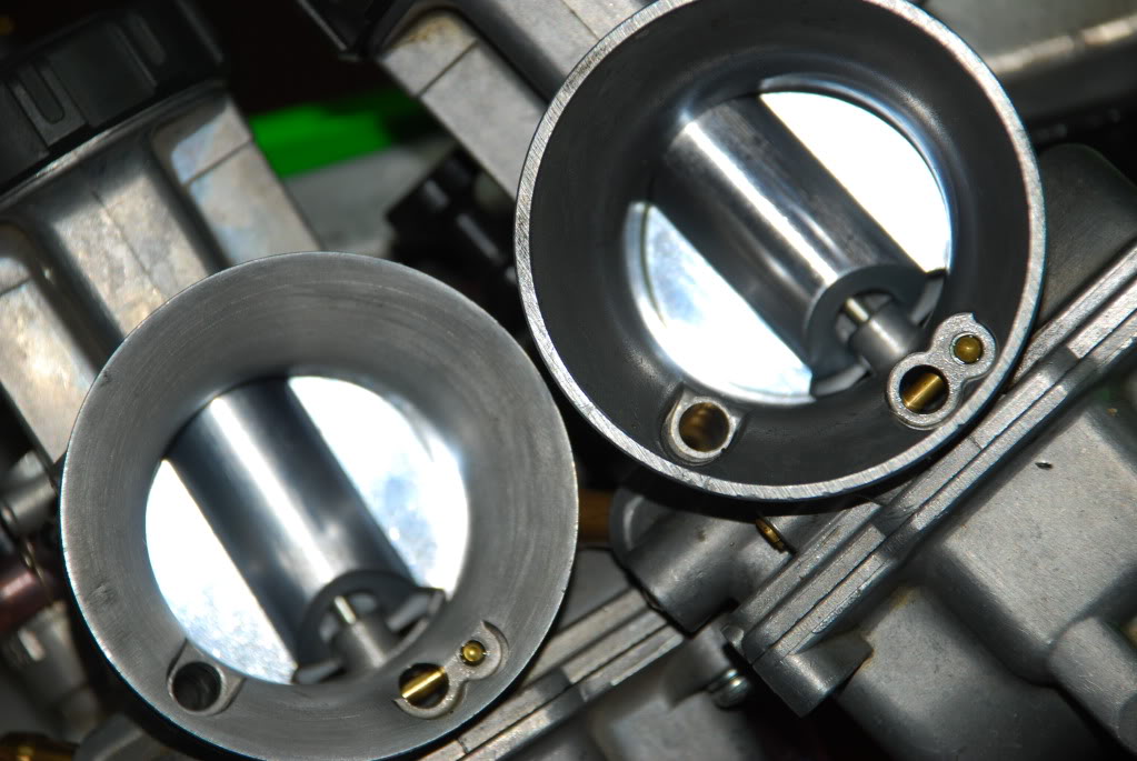

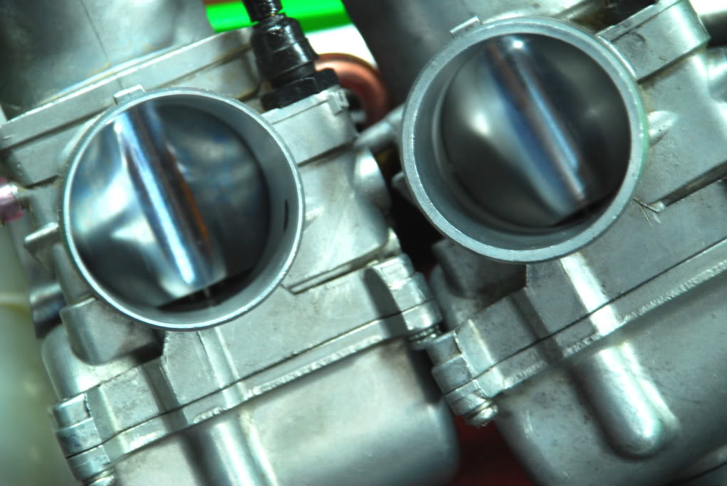

After alot of beer tonight, I remembered you asking me for pictures of a standard PWK vs the taper bore Sudco... sorry I forgot (takes beer to Jog my memory sometimes)...
But here ya go..
