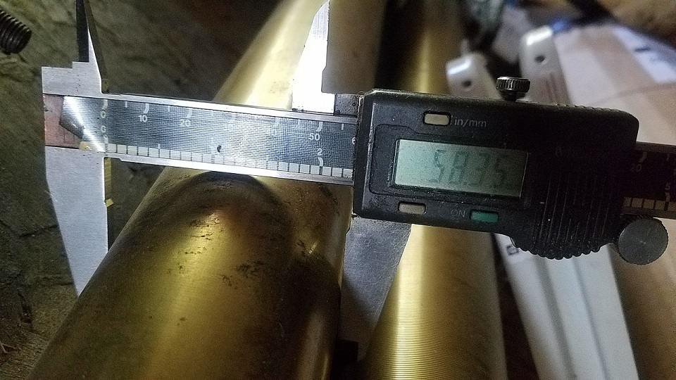

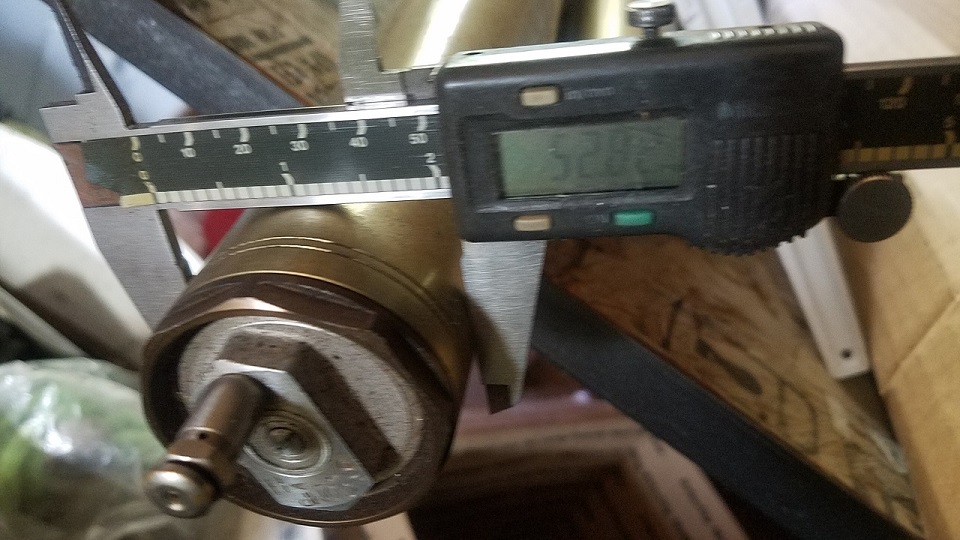

Here is the measurements off my 07 KX250F forks
UPPER 52.82MM
LOWER 58.35MM
I also have a set of 2011 KX450F forks in my hands right now.
UPPER 53.8
LOWER 59.1
Here is the measurements off my 01 KX500
UPPER 53.8MM
LOWER 58.9MM
