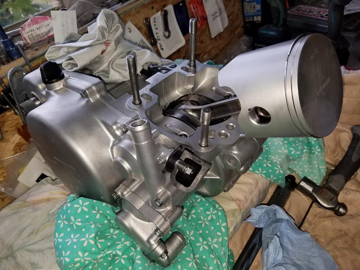

After lapping, Jason is holding the cases up to the light to make sure there is not going to be any air leaks...
Perfect...

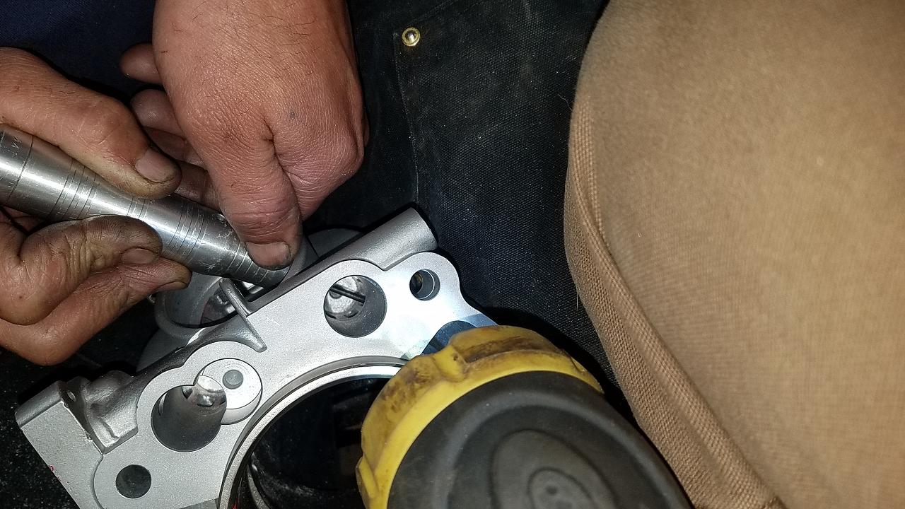

Re: Sean Colliers KX500 build
Posted: Wed Oct 26, 2016 3:41 am

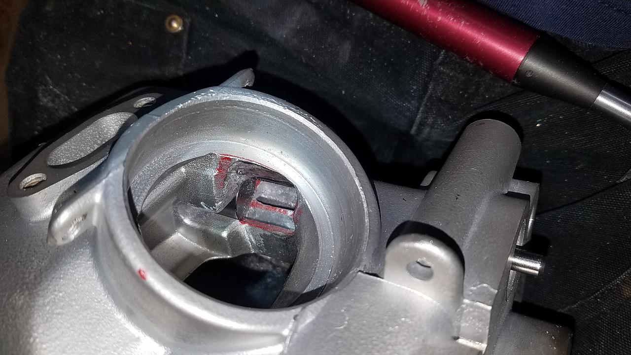

Getting the Exhaust sub ports cleaned up.
I'm holding the flashlight for Jason as he is porting :-)

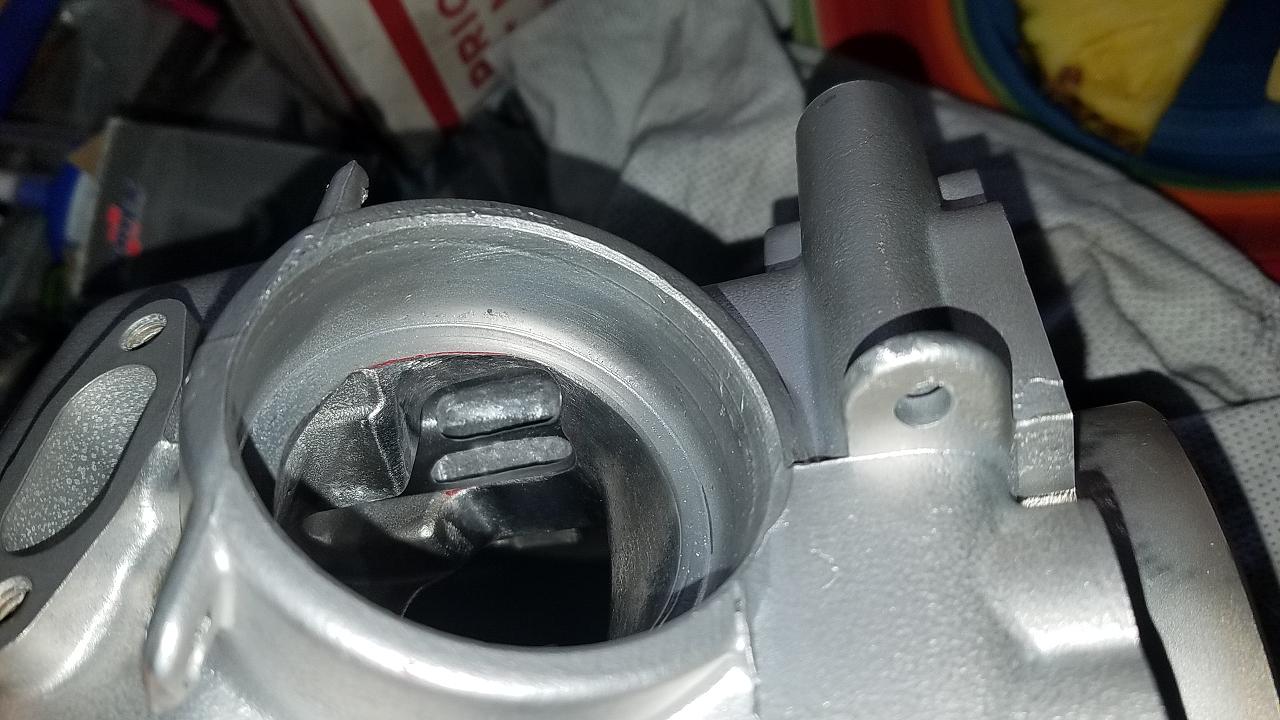

KX GURU RACING SEAN COLLIER KX500 288.JPG (170.19 KiB) Viewed 11115 times

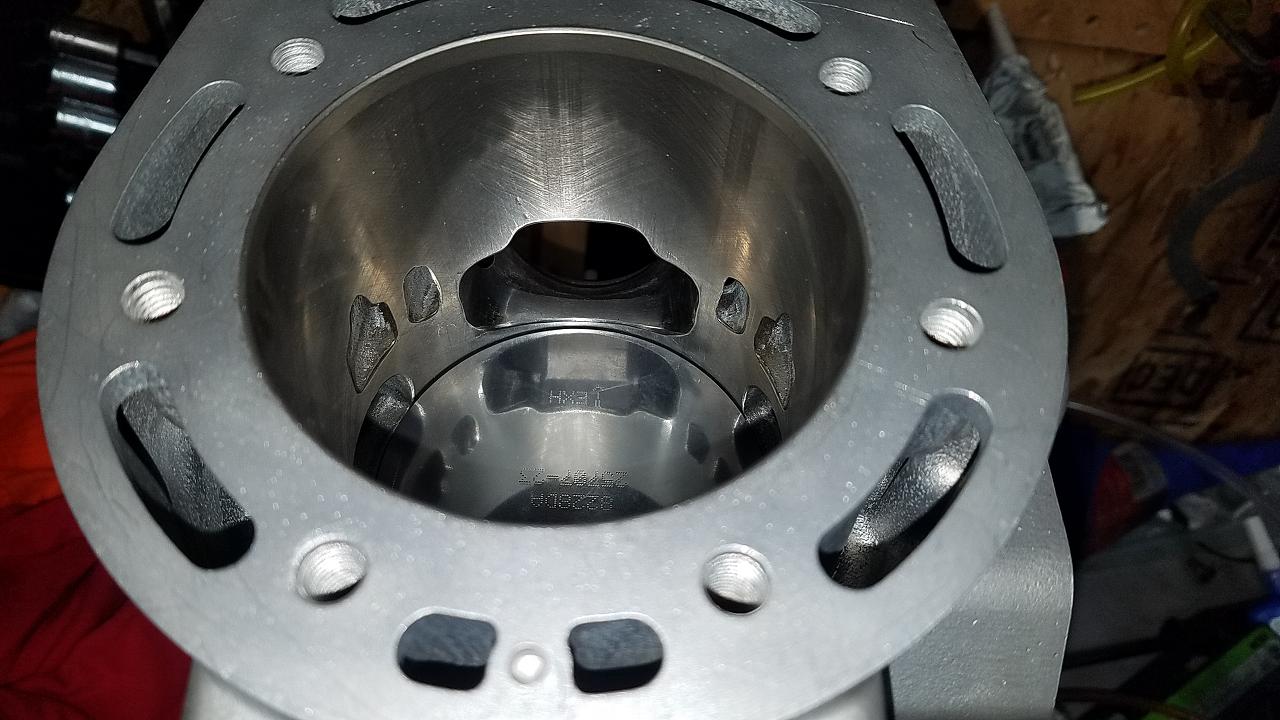

Some progress..
KX GURU RACING SEAN COLLIER KX500 289.JPG (157.5 KiB) Viewed 11115 times

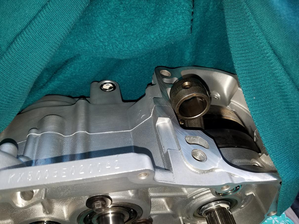

Almost ready for plating..
KX GURU RACING SEAN COLLIER KX500 291.JPG (139.12 KiB) Viewed 11115 times

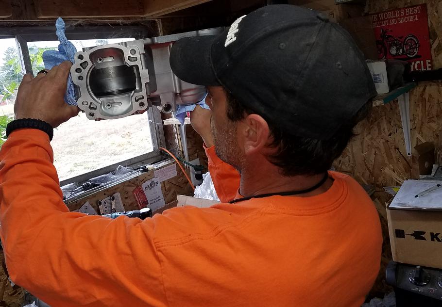

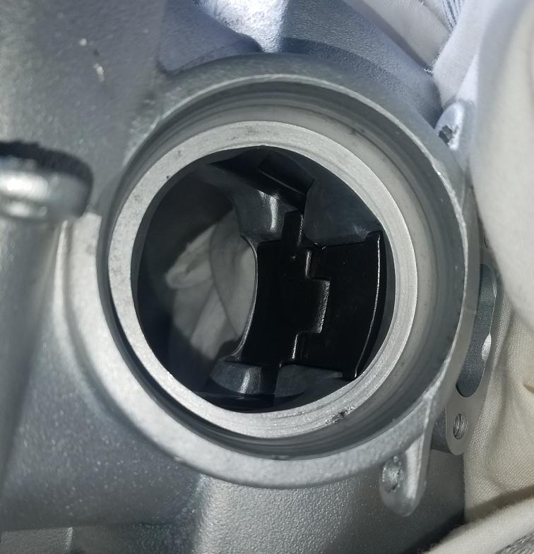

Checking the final fit before shipping the cylinder off to Millennium for plating
KX GURU RACING SEAN COLLIER KX500 290.JPG (131.33 KiB) Viewed 11114 times
One other thing to note, we do not do a fianl polish job until after the plating has been done.
Millennium does a harsh sand blast before plating and it will ruin a perfectly good polish job :lol:

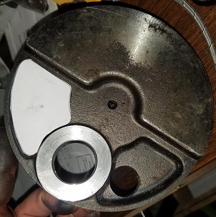

Posted: Wed Oct 26, 2016 3:52 am
CAD is a cool tool..
KX GURU RACING SEAN COLLIER KX500 292.JPG (93.44 KiB) Viewed 11111 times

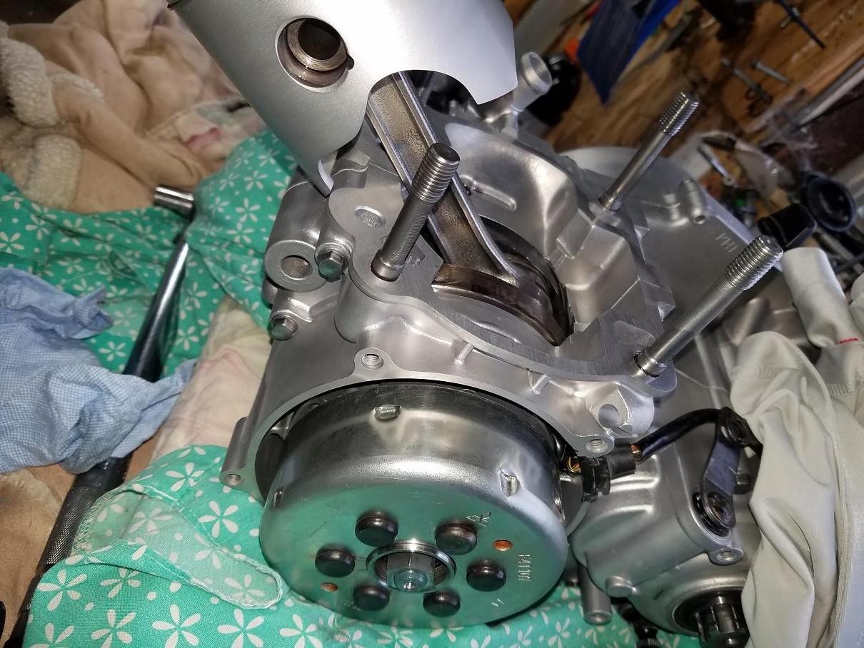

Stuffer!
KX GURU RACING SEAN COLLIER KX500 293.JPG (130.87 KiB) Viewed 11111 times

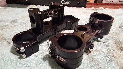

Posted: Thu Oct 27, 2016 2:55 pm
Brand new set of DH1 Racing triple clamps for the NEW project KX500! The picture doesn't do them justice!! Gorgeous piece of work! #dh1racing #dannyhamel #thebesttherewas #tribute #kxgururacing #kx500 #2stroke #comingsoon
KX GURU RACING SEAN COLLIER KX500 294.JPG (29.98 KiB) Viewed 11091 times
