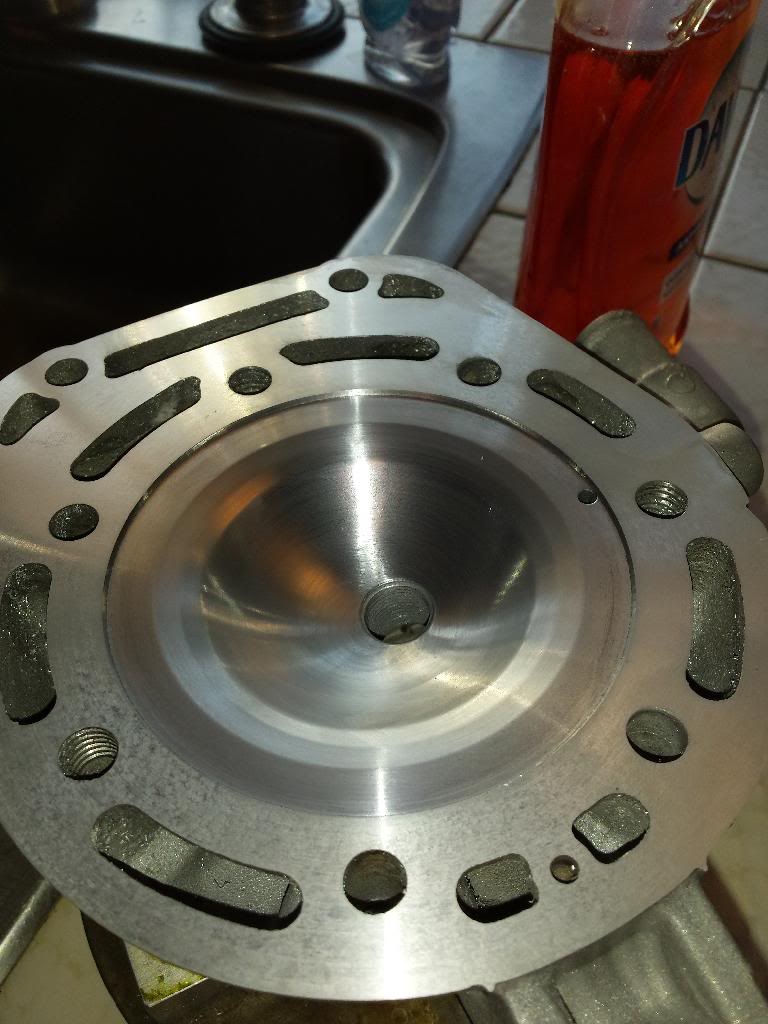

Other head had been cut too much to get it up to the needed chamber cc
So
Started with a new head
And fresh off the lathe from being molested
KX500 JEFF WARD ROUND 3 REBUILD 1086.jpg (167.36 KiB) Viewed 9863 times
sandblaster
Looks sweet as always....
Is that Dawn soap?
Motorrad
Yup. Best thing to happen to cylinder's and heads ever.

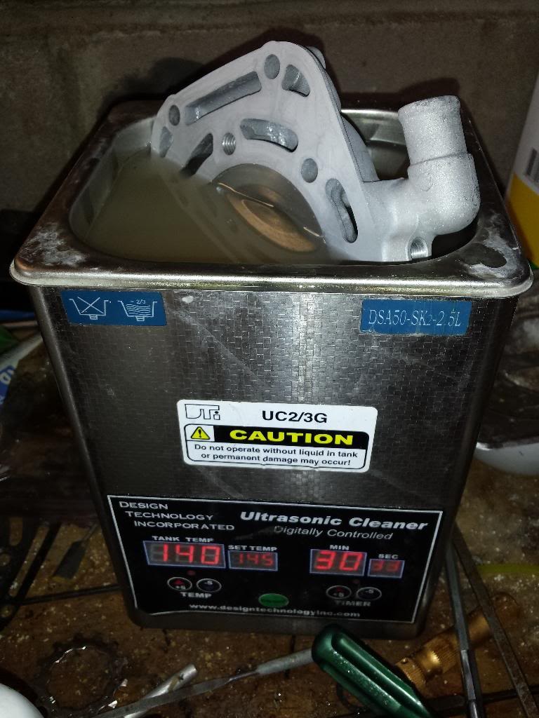

Missed my cc's a bit. So here we are making some cc adjustments. Now we are within 1/4 of a cc. Close enough for me
KX500 JEFF WARD ROUND 3 REBUILD 1087.jpg (289.47 KiB) Viewed 9852 times
Head hand lapped to perfection. And very smooth gasket surface.
Trip through ultrasonic cleaner to get any compound from polishing or lapping off.

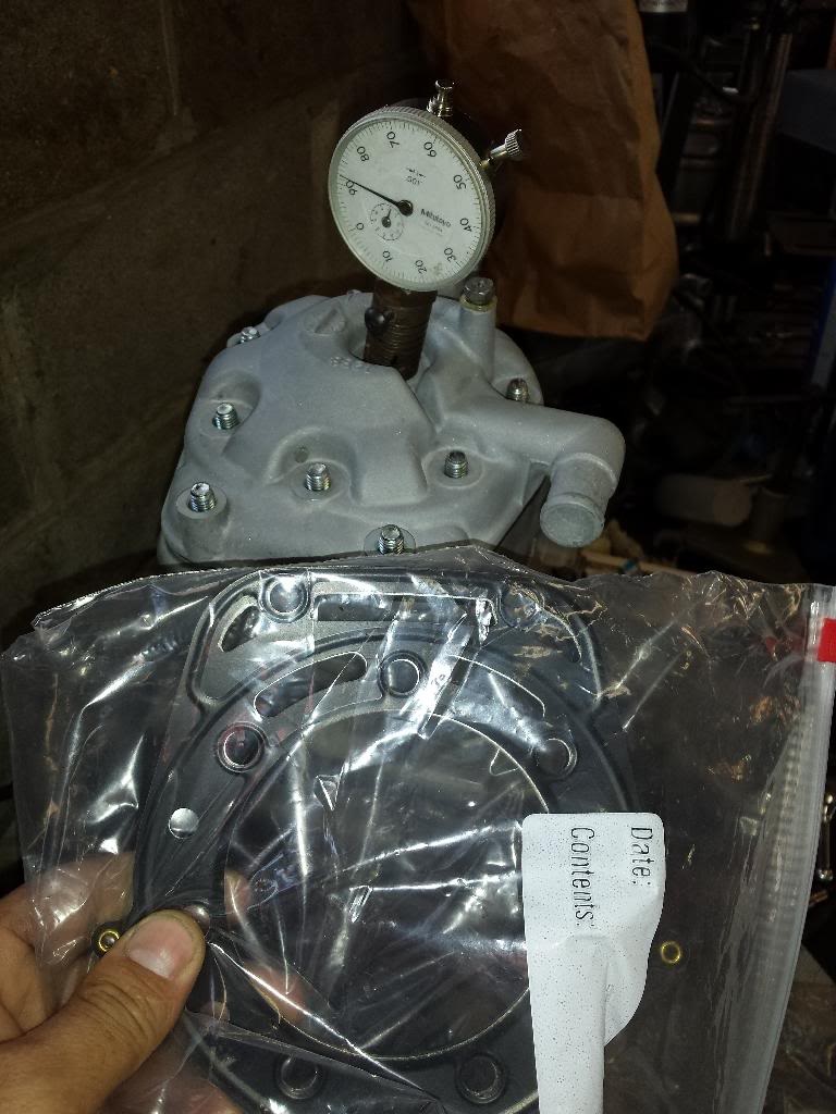

Had to take .037" off of dowel pin as to bit bottom out
Say by by
KX500 JEFF WARD ROUND 3 REBUILD 1089.jpg (207.16 KiB) Viewed 9852 times

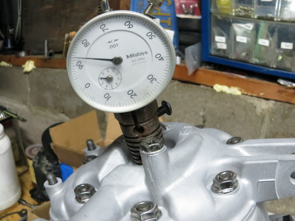

Magic custom gaskets. And checking squish clearance with the dial indicator.
KX500 JEFF WARD ROUND 3 REBUILD 1090.jpg (194.35 KiB) Viewed 9852 times

.04725" squish clearance. If anyone besides blaster cares
81cr450
.04725 ? due to the cc recalc or on purpose, always thought .037 was the G spot. Care to quantify
just curious, if theres a practicality behind it, i have the 87 head thats already near .100 in the hole
