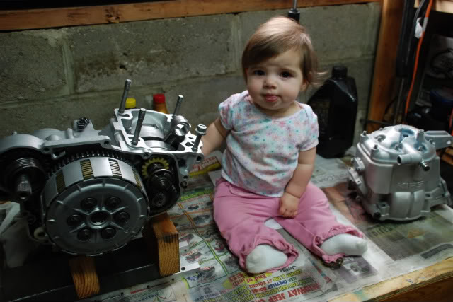

Motorrad:
The shop Supervisor is much more help than last time around..
Last time motor was out of the bike.
KX500 JEFF WARD ROUND 3 REBUILD 1000.png (523.34 KiB) Viewed 10101 times
NOW.
KX500 JEFF WARD ROUND 3 REBUILD 1001.png (1.08 MiB) Viewed 10101 times
KX500 JEFF WARD ROUND 3 REBUILD 1002.png (1.06 MiB) Viewed 10101 times
KX500 JEFF WARD ROUND 3 REBUILD 1003.png (1.01 MiB) Viewed 10101 times

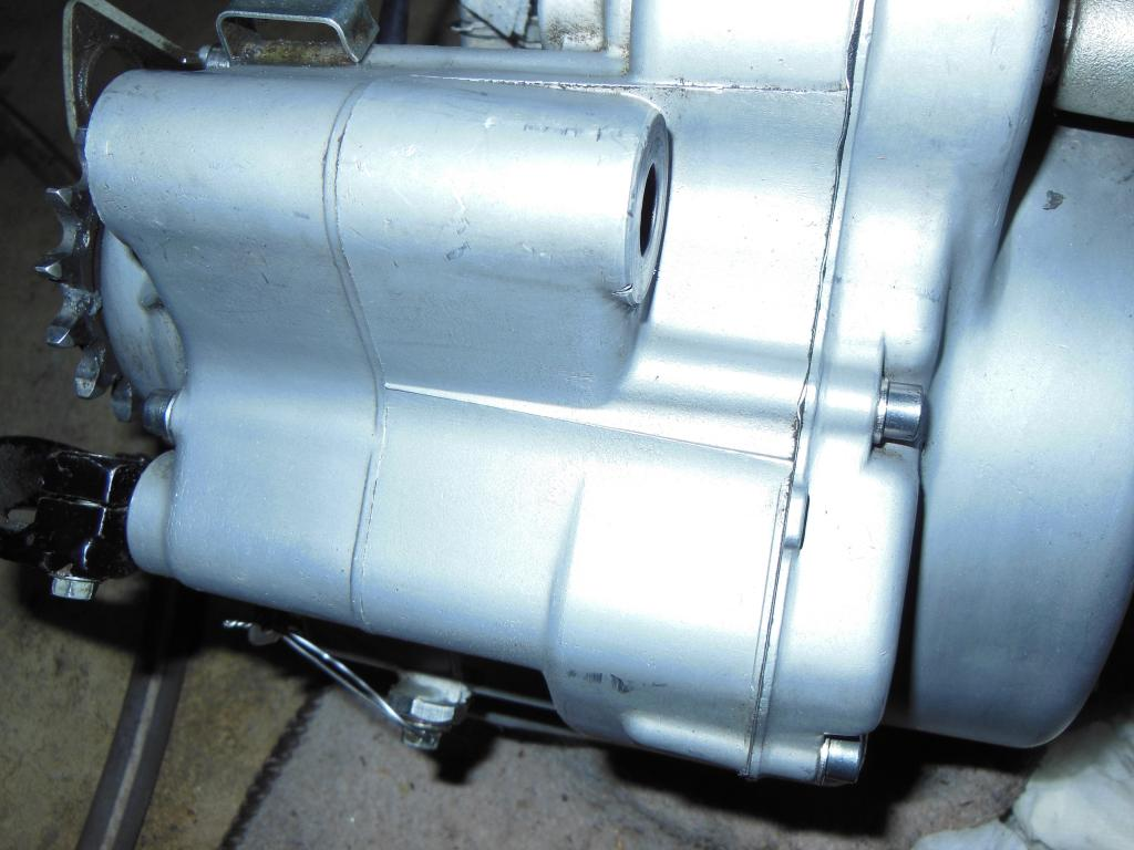

and for all of you that I always gripe out about opening motors that are dirty.
THIS is what it should look like. MINIMUM. (not clean enough yet, still going to hit it again tomarrow before I open her up).
KX500 JEFF WARD ROUND 3 REBUILD 1004.png (881.49 KiB) Viewed 10101 times

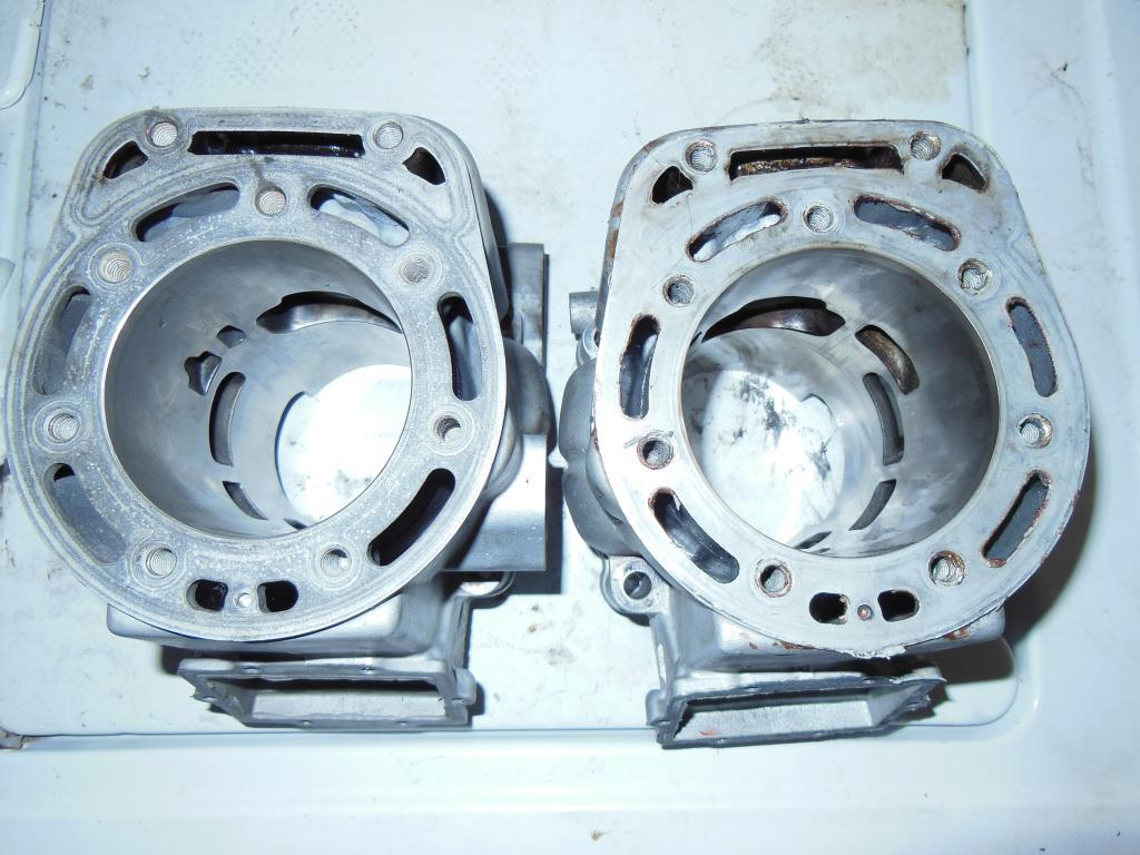

I'd sure like to see that HUGE piston..
KX500 JEFF WARD ROUND 3 REBUILD 1007.png (732.55 KiB) Viewed 10095 times
KX500 JEFF WARD ROUND 3 REBUILD 1008.png (958.58 KiB) Viewed 10095 times
sandblaster:
Wish I could borrow one of those cylinders for just a day... I'm sure I could learn a thing or two.... shocked

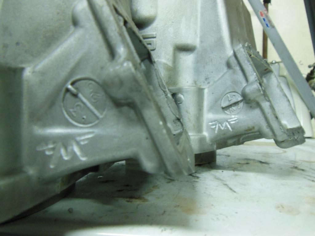

What is the M stamped on the cylinders? Is that one of Tom Morgan's Stamps?
sandblaster;
Flying M is for Motorrad cool
Pmcg:
Can you take a picture from the bottom of the cylinder?
USMC 500:
I don't know why, but I get the chills seeing these 2 K5 jugs sitting side by side..... grin
motopunk:
looking at that, makes the idea of an 2-cylinder engine with 1000cc ... grin
81cr450:
Looks like like alot of broken head studs, or am I seeing things?
