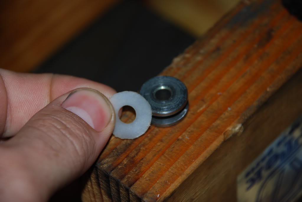

Did some more shimming of kips tonight.. (Little tinker stuff while I wait on parts to move forward).. I didnt like how much play there was in the actuator disk...
I should have cut the E-clip grove closer tolerance... (but I went off stock spec, not thinking about this when I cut it)... so..I cut a shim out of some Urithane..... (stock setup would benefit from shim)

and caught me HAND SANDING. my .50mm shims down by hand... to the correct size to shim the kips (since I can only get to .38mm with the shims I have). He gave me a look like I was nuts... undecided
Going sanded down to .48mm and going to step down .01mm at a time till they are SPOT ON...

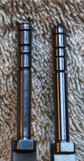

ordered a new shaft, guide, etc etc etc... today... Ugg. I have more $$ in kips than I cair to think about..
I went crazy with some polishing compound today..... carbon shouldnt stick to this..

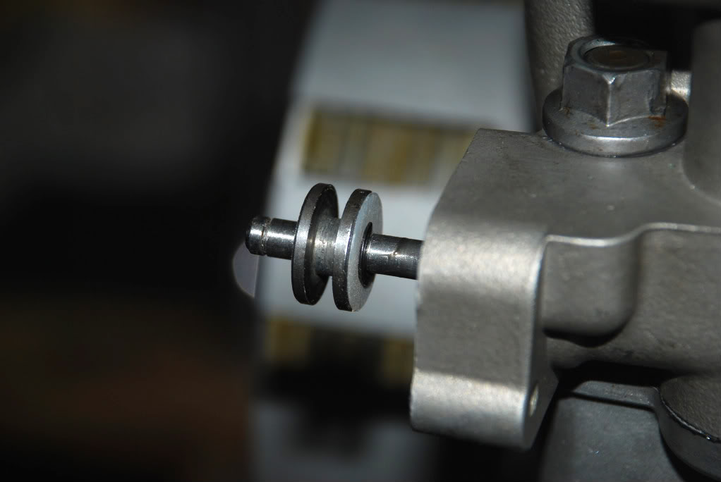

Got kips stuff today..
Guide, seals, hardware, shaft, etc...
Cut the Snap ring grooves... nice and tight this time

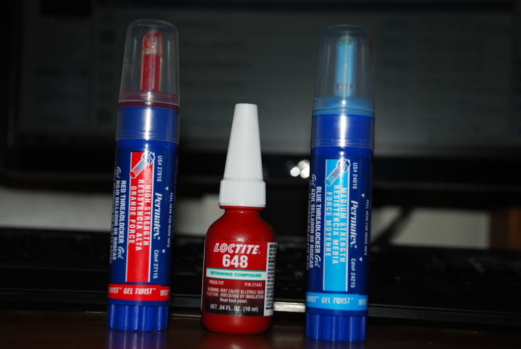

A word on Loctite...
It is both your best friend.. and YOUR WORSE ENEMY!!!
Know where to use it... and how to use it... STRONGER IS NOT BETTER!

Yes.. I use retaining compound.. there are ALOT of differant kinds of retaining compound... differant strengths, set times, temp ranges, tolerance's to fuel, oil and so on... I like 648, sets fast (5min work time, 24hr set) but it isnt affected by fuel, ethonal, oil, etc...
USES... DONT USE ALOT... When I put in for example a tranny bearing... Ill put a VERY VERY small spot (this stuf has a 4500PSI break strength) on 2 sides of the bearing (opposite each other)... its enough that when its time to get it out.. you can... but will aid in not spinning in the case.... IF you were to put this stuff around the entire bearing... GOOD LUCK getting it apart again without buying a set of cases...
Think ahead... if your doing a main bearing... and want to "retain" it to both the crank, and the case... make for darn sure one side has VERY little on it so it will come loose... (I like to use more on the crank, as it tends to spin, and when apart, if the bearings come out stuck to the crank, I can take HEAT to it to get rid of the loctite)
Retaining compound can be a savior for some of you that have "worn" cranks.. or have had a bearing spin on it in the past... as they make this stuff to fill .006-.015" gaps!!!!!!.. I have saved many Old VERY HARD TO GET parts this way.. (Norton transmission, CZ cranks, etc).. just polish out the galling from the spun bearing.. and GLUE HER IN..
I USE this stuff every day at work... and know how it behaves... WHEN IN DOUBT, or your not sure, comfortable etc... DONT USE IT.. you will do MORE HARM THAN GOOD.. and will destroy stuff trying to get it apart again!!!

Oh... same goes for the lever itself....
I can actuate my kips, with the eclip gone, and the nut unscrewed.... all works fine as if it was tight...
Just some extra holding Umph reasurance...
Dissasembly takes some Know how.. but thats no problem...

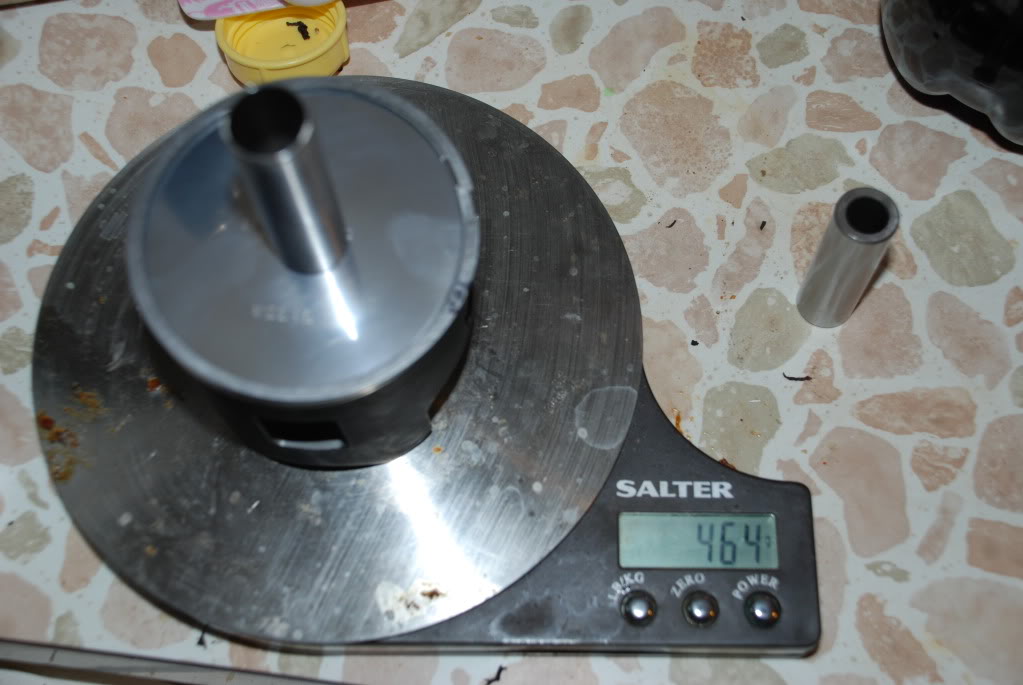

Checking weights... (before I polished piston top)
This is pin, clips, rings, piston. (no bearing, add 21G for bearing))
Measurement in Grams.
