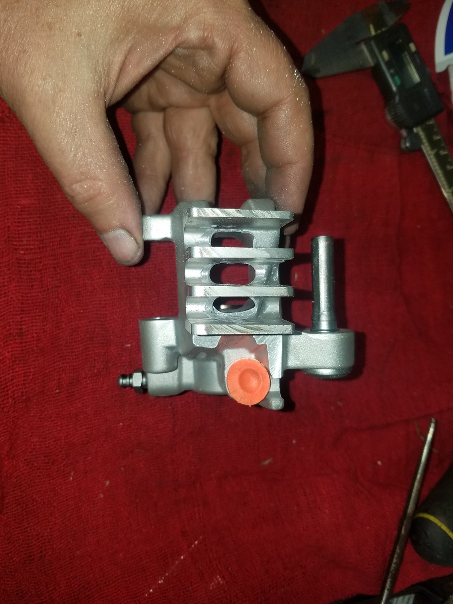

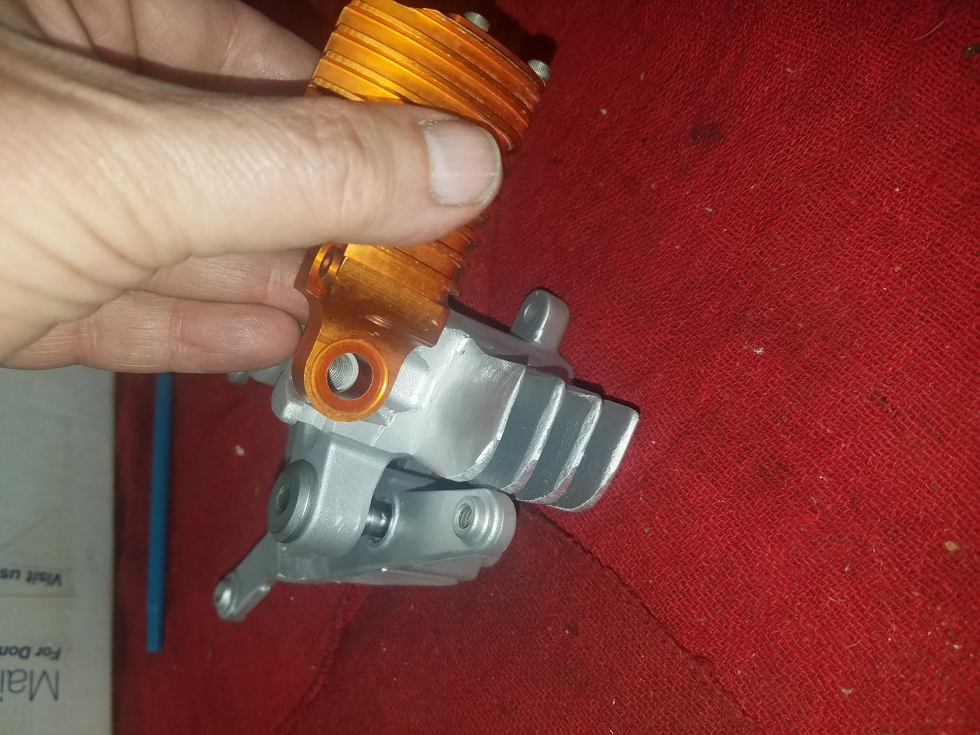

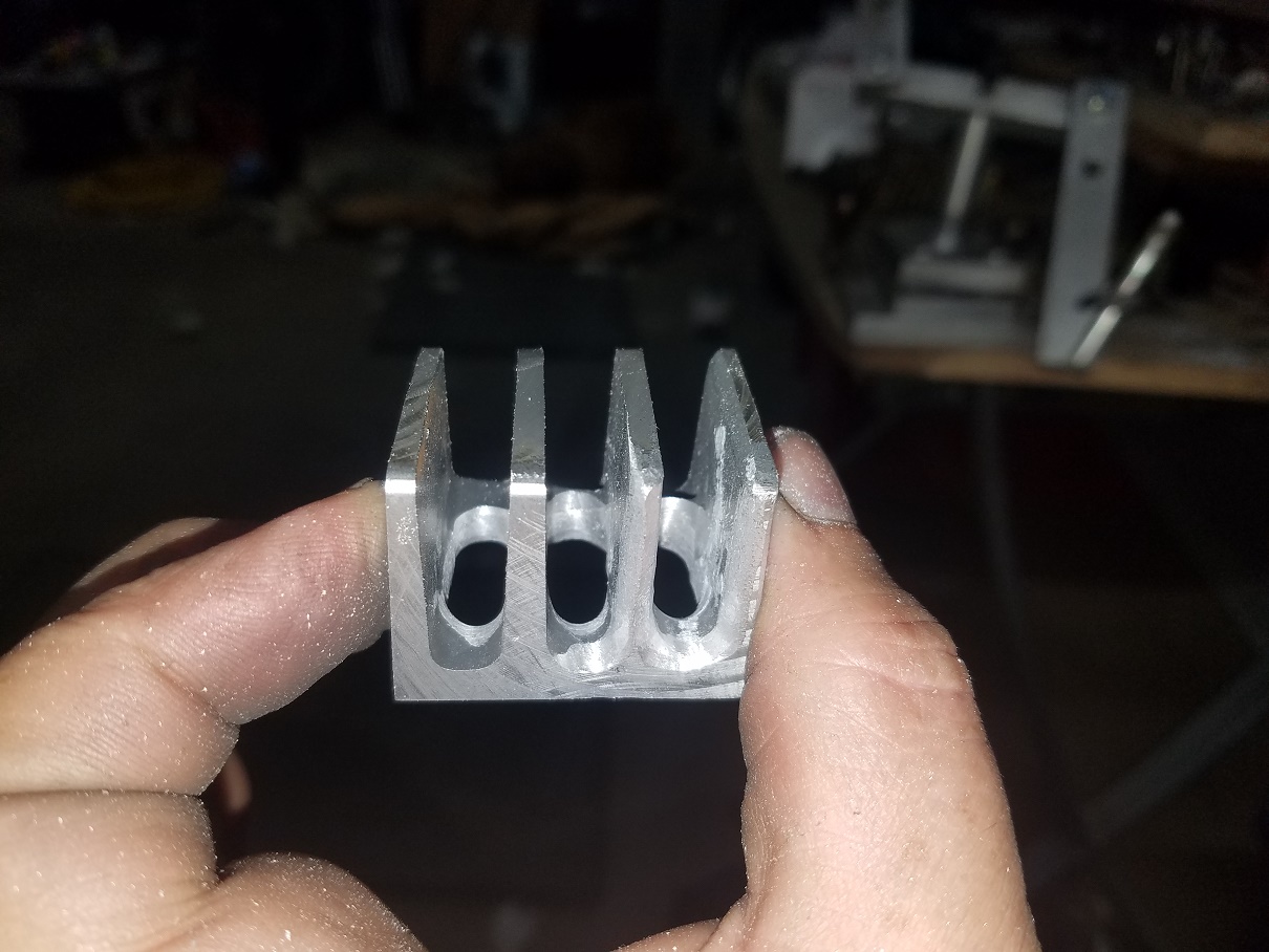

Posted: Fri Sep 23, 2016 6:30 am

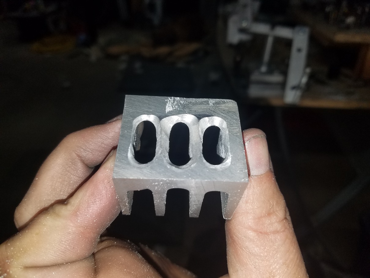

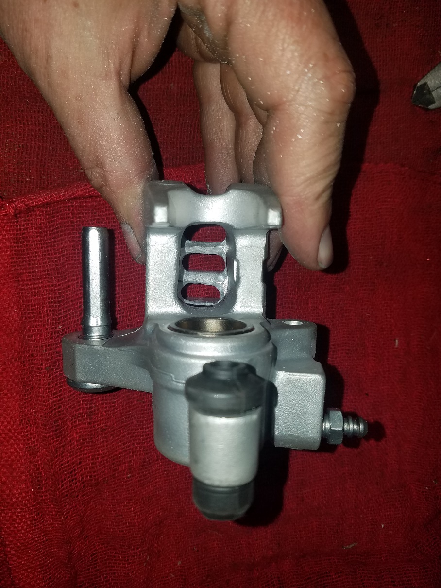

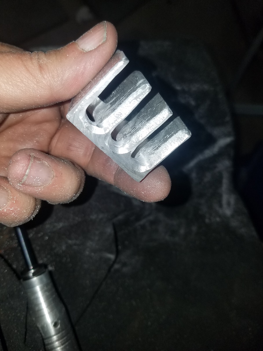

Got the top of the caliper decked so that the heat sink would sit flat on it.
The trimmed the heat sink to size and started whittling on it.
The idea is to angle the slots so that the air is pulled down and through the caliper, rotor, and pads.
Keep in min that this is very rough... I will be doing a lot of clean up before I'm done

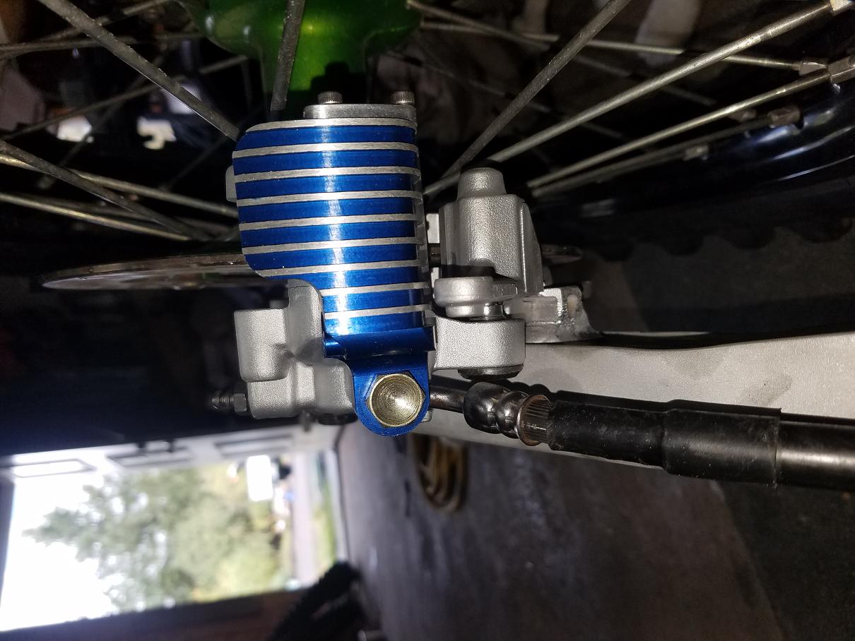

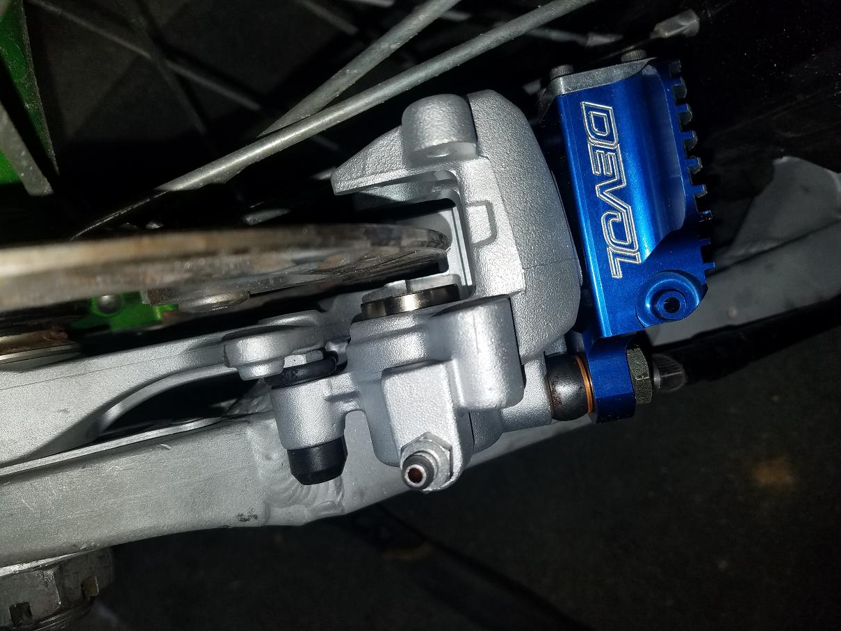

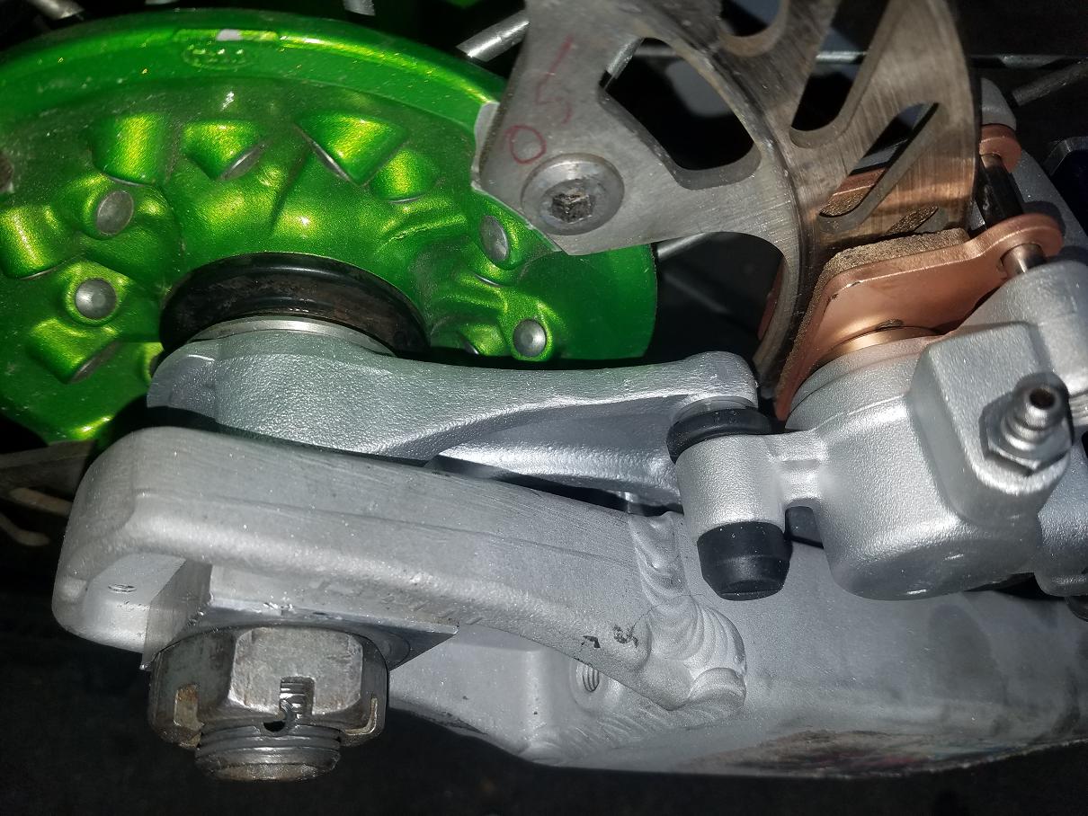

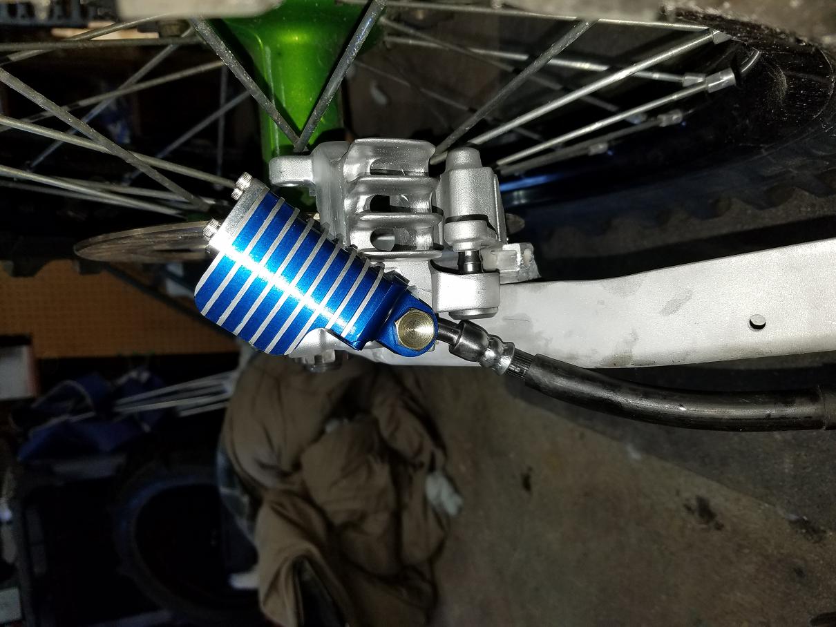

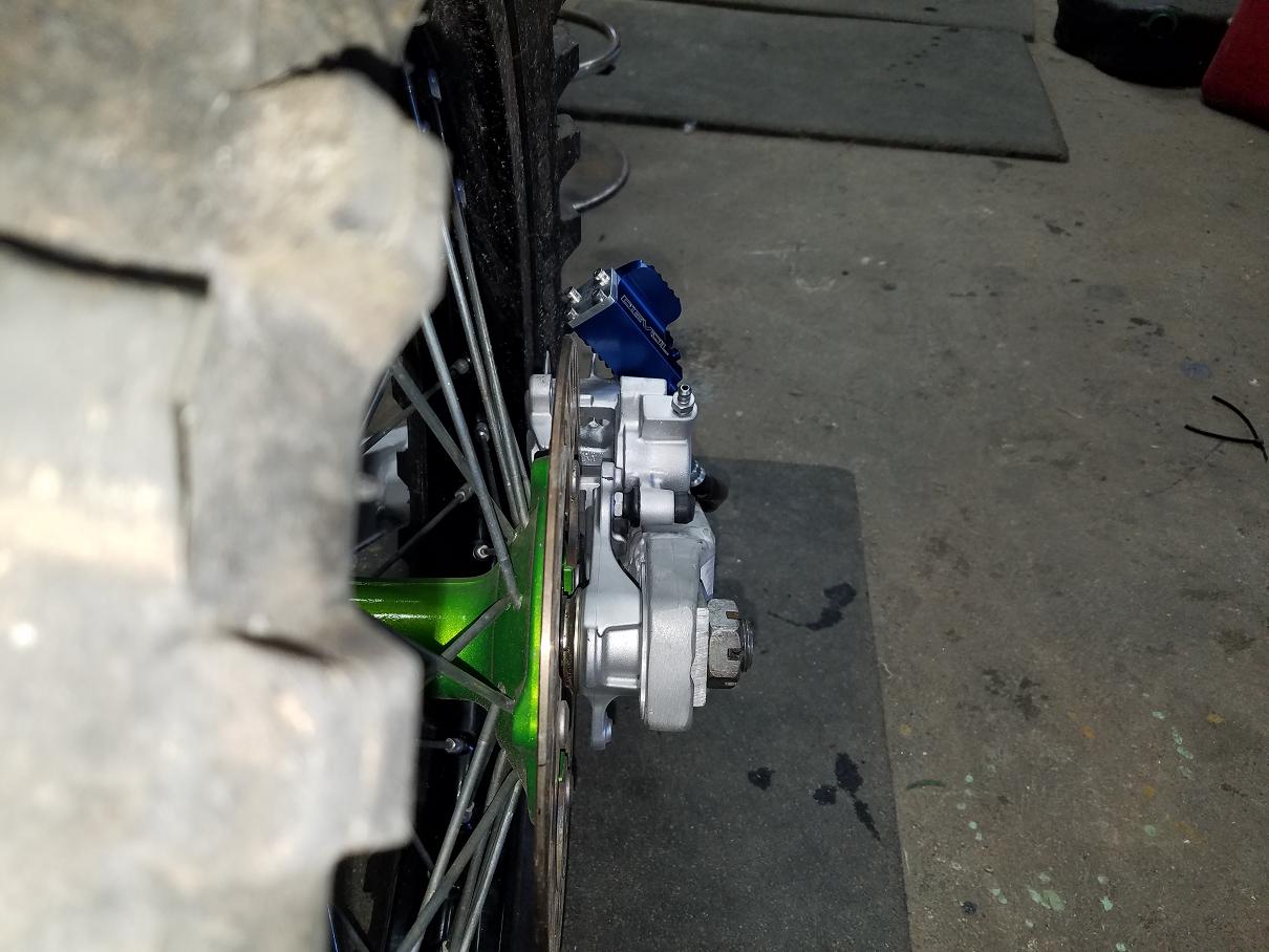

Ok... Back to the rear brake project...
I could say a lot here.... but this pretty much covers it..
https://www.youtube.com/watch?v=3Eny8P0d09k

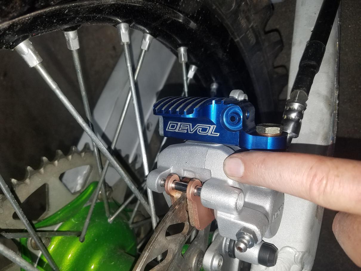

Re: Sean Colliers KX500 build
Posted: Sun Oct 02, 2016 9:27 pm

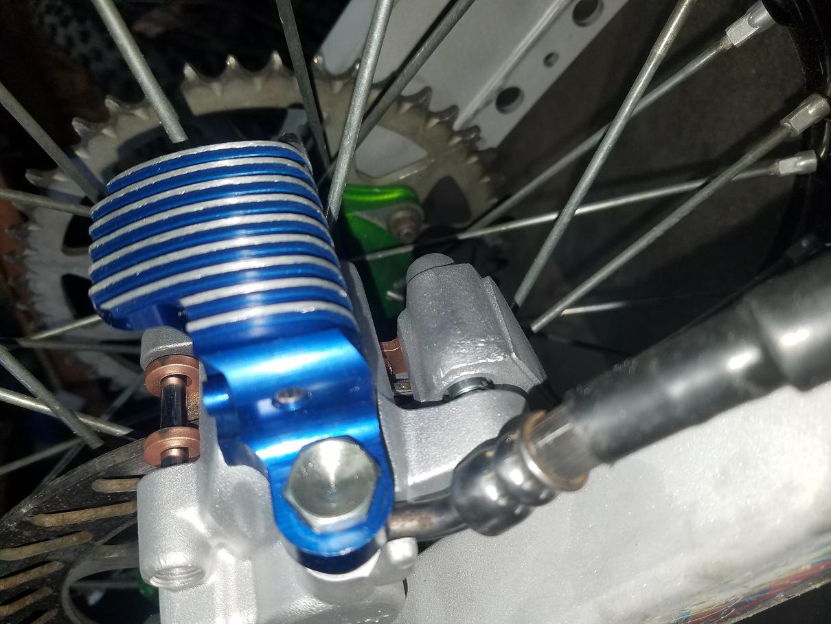

The way I have the fluid cooler is mounted is not the way Sevol envisioned it..
They have it mounted like this..

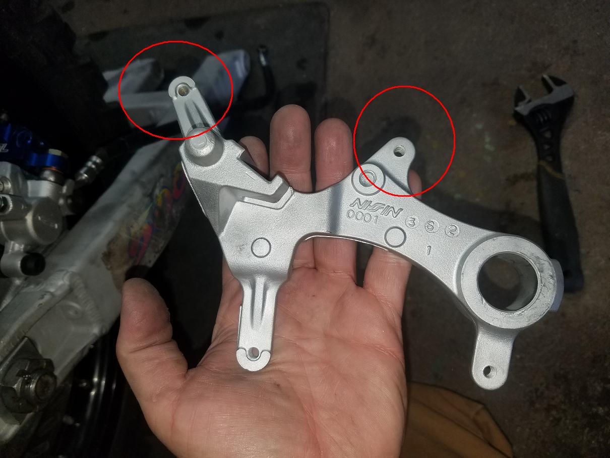

Here is something else... Regardless of which way we end up going, I don't need the caliper guard mounts..
KX GURU RACING SEAN COLLIER KX500 173.JPG (132.56 KiB) Viewed 10516 times
So I'm thinking about removing them like so..
KX GURU RACING SEAN COLLIER KX500 171.JPG (198.65 KiB) Viewed 10515 times
KX GURU RACING SEAN COLLIER KX500 172.JPG (157.61 KiB) Viewed 10516 times
I can do it either way... What do you think?
