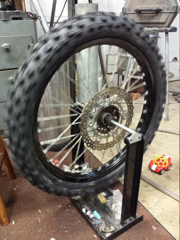

Converted to tubliss. And yes I balance my dirt bike wheels
KX500 JEFF WARD ROUND 3 REBUILD 1066.jpg (268.34 KiB) Viewed 9142 times

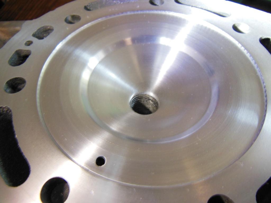

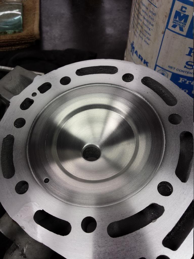

A little CC work...
KX500 JEFF WARD ROUND 3 REBUILD 1078.jpg (137.42 KiB) Viewed 9135 times

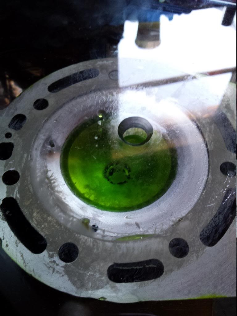

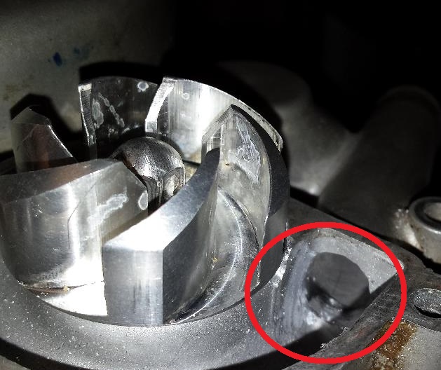

Factory looking water pump mod..
KX500 JEFF WARD ROUND 3 REBUILD 1079.jpg (113.1 KiB) Viewed 9135 times
I see something happening..

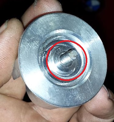

sandblaster
Threaded rod or cut off bolt?
KX500 JEFF WARD ROUND 3 REBUILD 1081.jpg (63.35 KiB) Viewed 9135 times
Motorrad
5mm to 6mm. Grade 8 adaptor

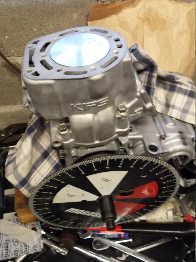

Final mock up to check port time on all new parts. My math was good Timing is on the money. And to mark piston for final mods
KX500 JEFF WARD ROUND 3 REBUILD 1082.jpg (181.36 KiB) Viewed 9135 times
Posted: Sun Feb 01, 2015 10:52 pm
dave916
what port timing are u running?
Motorrad
Dropping back down to 191. Was up at 199. But I also have more variance on my kips than stock (more range).
Motorrad
199 made a awesome ride and killer dunes motor. But for real world desert 191 was my favorite riding motor
Spent the better part of the evening installing my pingle petcock. Doing more piston mods (not done yet).
And finding all the brackets that make my team green radiators fit the bike. As well as a few hours on the couch with some tweezers straightening radiator fins
Did you run the 191 port timing with your current exhaust valve setup and the exhaust valve divider wall removed?
Motorrad
last time I ran 191 I was still 86mm bore. with stock kippies.
with the 90mm bore I have run 195, 198, and 200
Good
hey Motorrad, at the 199 number what kind of rear wheel power number would you guess that you had? 64-65ish? I'm looking for a reliable but fun and still somewhat competitive dune combo to work towards.
It sure would be nice to have a dyno sheet database to compare HP/TQ curves to pick the combo that we feel would be right for us. I don't need anything extreme, but competetive with the other big bore 2-strokes on the hill and reliability are a must.
Motorrad
setup like my 199 motor. all your bottom end BETTER be d**n good my bike would blip over 10,000K so fast... I feared rods comming appart. Awesome dunes motor though!.
If I was still riding as much dunes as I thought I would when I built that motor. Id still run that setup. but my riding has varied a bit since I have branched out to riding with the socal guys. So I needed to tame her down a squeek.
The last socal ride, all the guys lite off their bikes, and Then I lite off mine. they all then ask "why does yours sound like a GP bike, and ours sound flat"

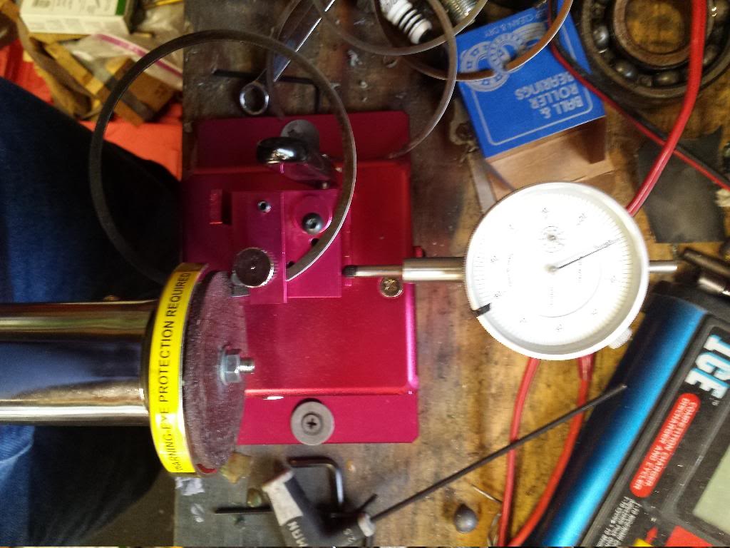

Ring end gap check seconds before final assembly............. .011" hmmmm somthing is wrong.
Break out the bore gauge. Hmm 90mm forged piston should have more than .0015" clearance.
why is it always me that gets shotty parts, or workmanship?
alward25
I agree should be more than .0015" that is way too tight grin typo included
Motorrad
Okay. took VERY carefull measurements. even broke out my GOOD measurement tools. and let everything sit in a 70deg room for 24 hours before I measured. (yes I dissconnected the thermostat from the wall, and brought it into that room, and set it next to all the parts)
Bore 3.5407"
Piston 3.5433"
Clearance of .0026
wossener wants 0.00275"
so a squeeeek tight. (less than most people can measure)
but not the drastic ammount that is throwing off my ring end gaps.
Hmmm
Found my problem. Time to break out big pink
