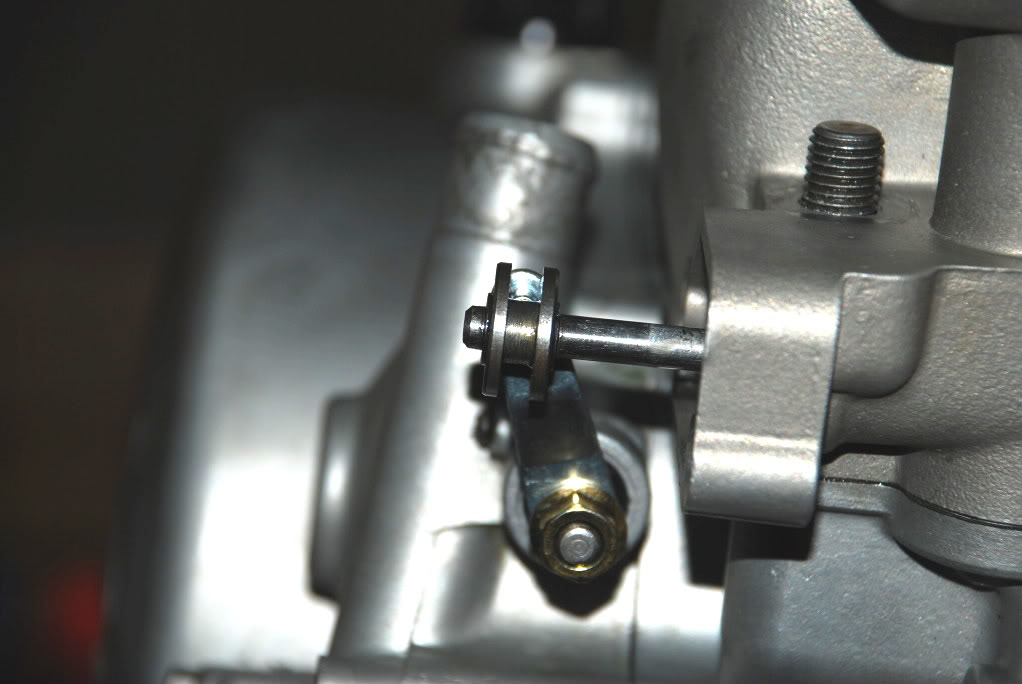

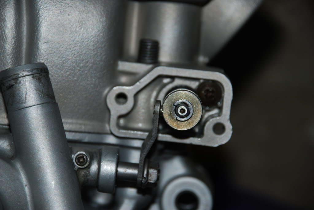

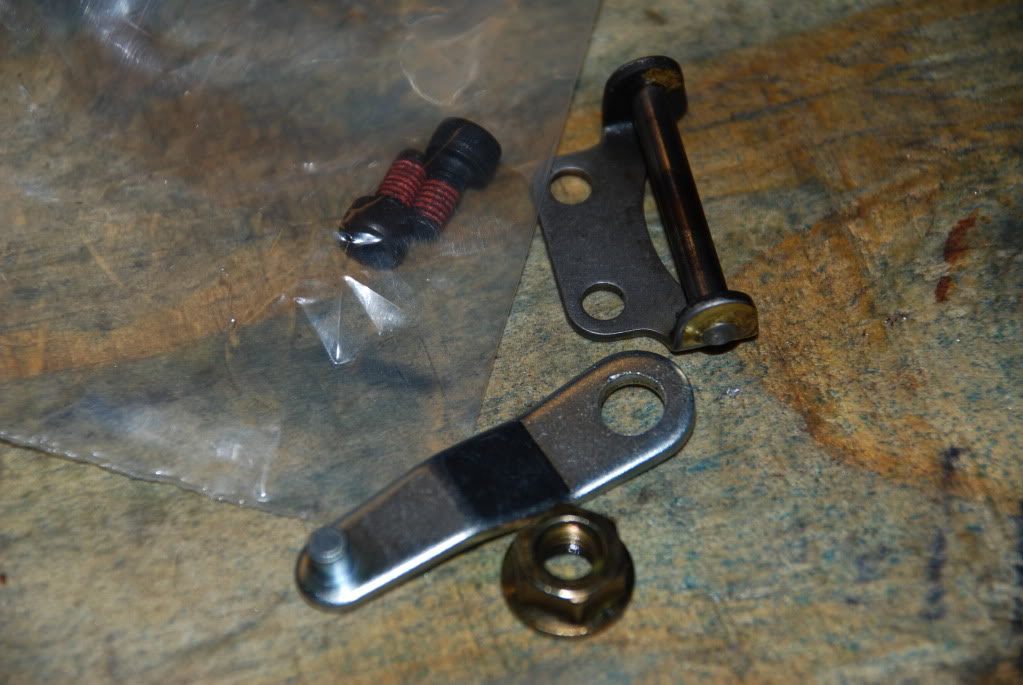

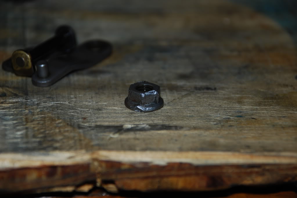

All my NEW Kips levers showed up today. (due to mine being bent, and worn) angry
And noticed this..
The NEW arm is longer than my old arm.. (2.54mm center to center) to be exact...
I havnt assembled it all to see what this is going to do on the bike yet... figured I share.. incase one of you knows why, and can tell me before I mock it all up to see what it does..
Motorrads Jeff Wards Engine build round 2 8-1.jpg (175.33 KiB) Viewed 7573 times

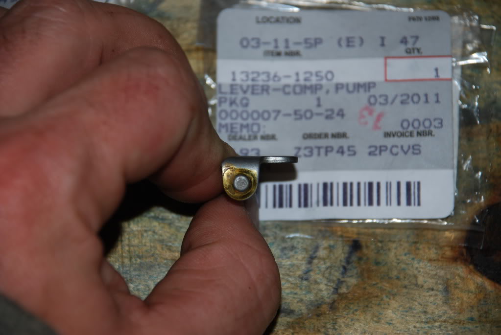

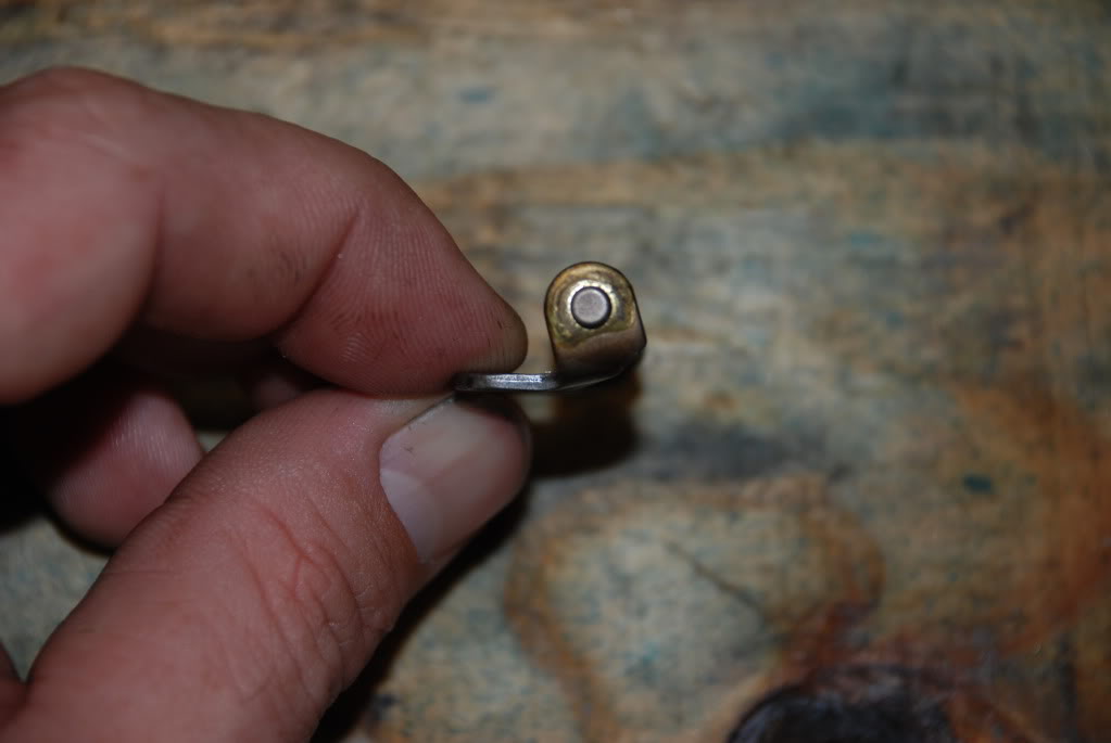

And incase some are confused as to what the lever in the case is supposed to look like angry
It is not supposed to be bent.. (I have talked to guys, that since every single one they have seen is bent, they think it is supposed to be that way...)
Make your kips work properly boys and girls..
And vice gripped hardware just bothers me, so it got replaced....

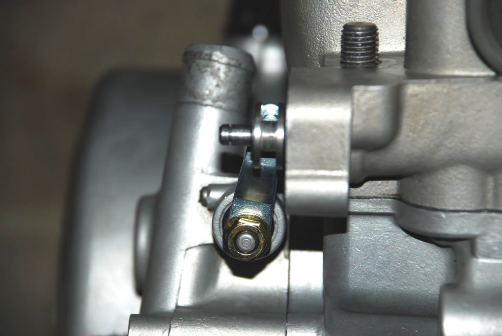

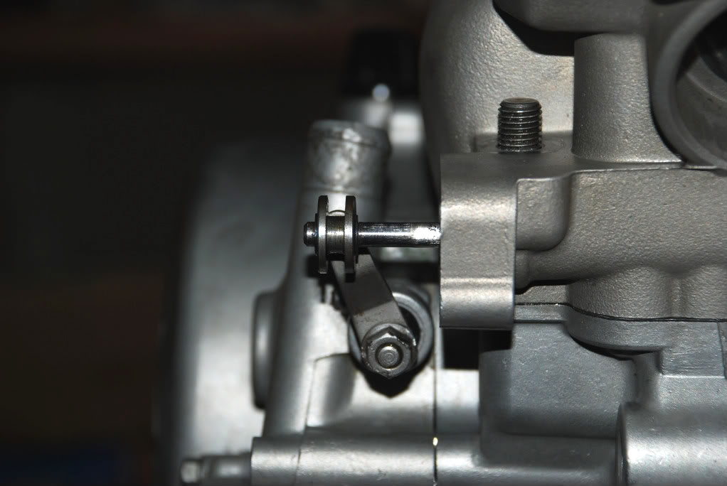

Havnt dug into part numbers yet.. Beyond both arms are differant from my 91 to the newer... the govener arm is superseeded by the new number... and the arm we are looking at now is just straight listed as "disscontinued" But here are some pictures of mock up..
Old.
(IN)
Motorrads Jeff Wards Engine build round 2 8-7.jpg (76.94 KiB) Viewed 7573 times
Motorrads Jeff Wards Engine build round 2 8-8.jpg (100 KiB) Viewed 7573 times
(OUT)
Motorrads Jeff Wards Engine build round 2 8-9.jpg (82.49 KiB) Viewed 7573 times
Motorrads Jeff Wards Engine build round 2 9-0.jpg (73.75 KiB) Viewed 7573 times

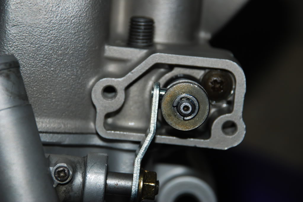

Posted: Sun Sep 07, 2014 4:35 am

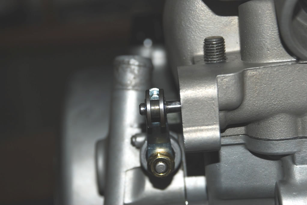

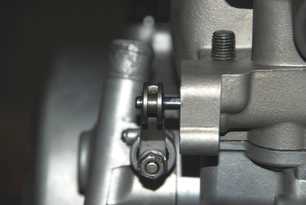

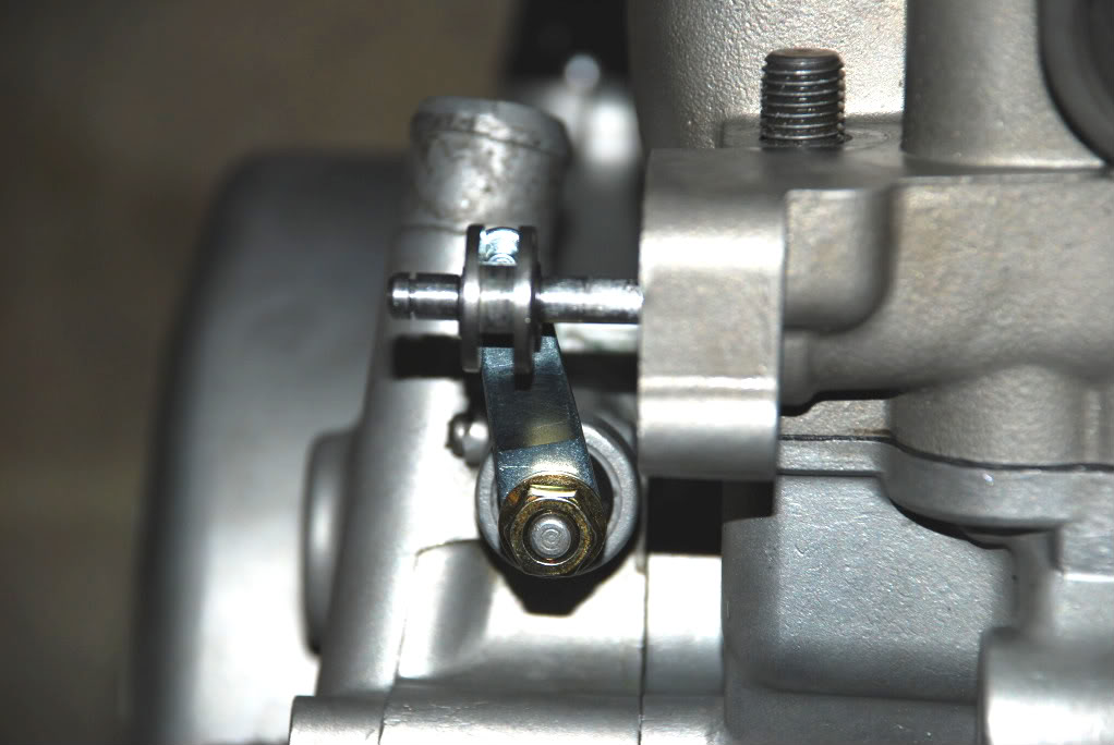

NEW
IN
Motorrads Jeff Wards Engine build round 2 9-1.jpg (75.59 KiB) Viewed 7573 times
Motorrads Jeff Wards Engine build round 2 9-2.jpg (87.54 KiB) Viewed 7573 times
OUT
Motorrads Jeff Wards Engine build round 2 9-3.jpg (73.5 KiB) Viewed 7573 times
Motorrads Jeff Wards Engine build round 2 9-4.jpg (78.87 KiB) Viewed 7573 times

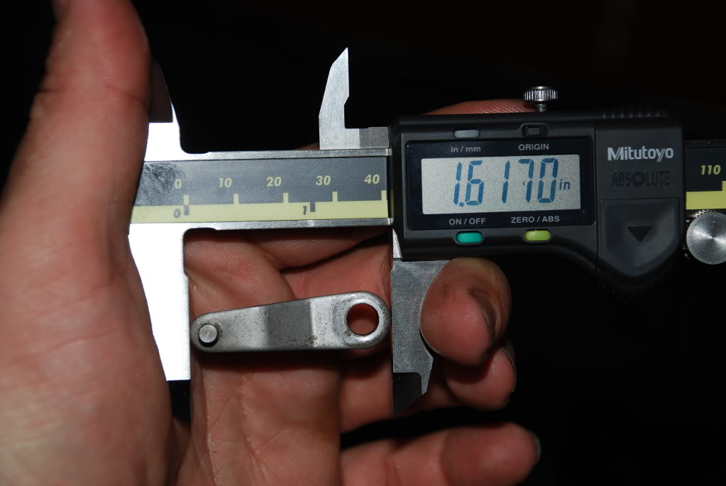

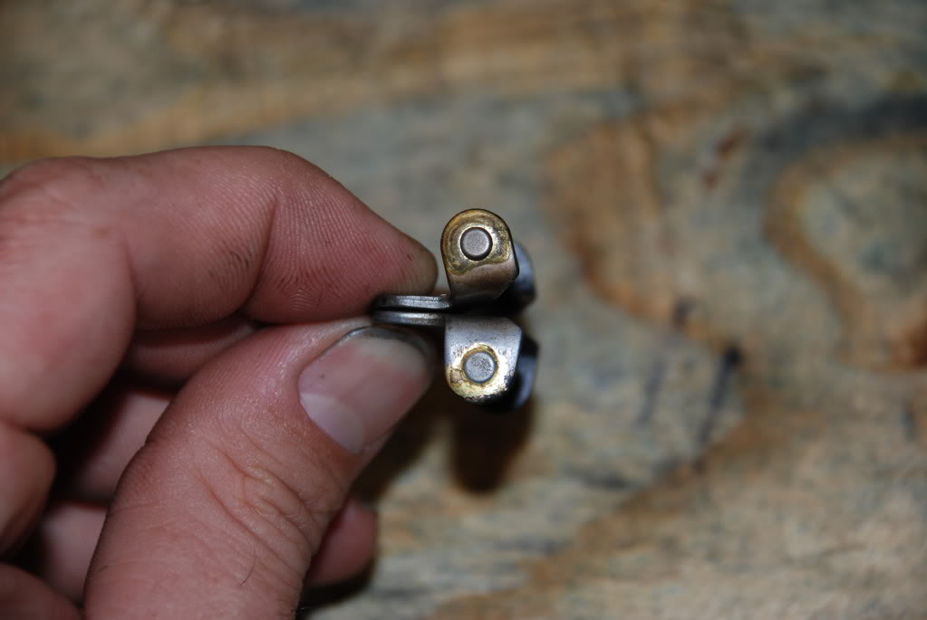

Measurements
(the spacing from Center of hole and pin is same to outside on each.. so just measured this way for easy picture)
Motorrads Jeff Wards Engine build round 2 9-5.jpg (61.54 KiB) Viewed 7573 times
Motorrads Jeff Wards Engine build round 2 9-6.jpg (67.88 KiB) Viewed 7573 times

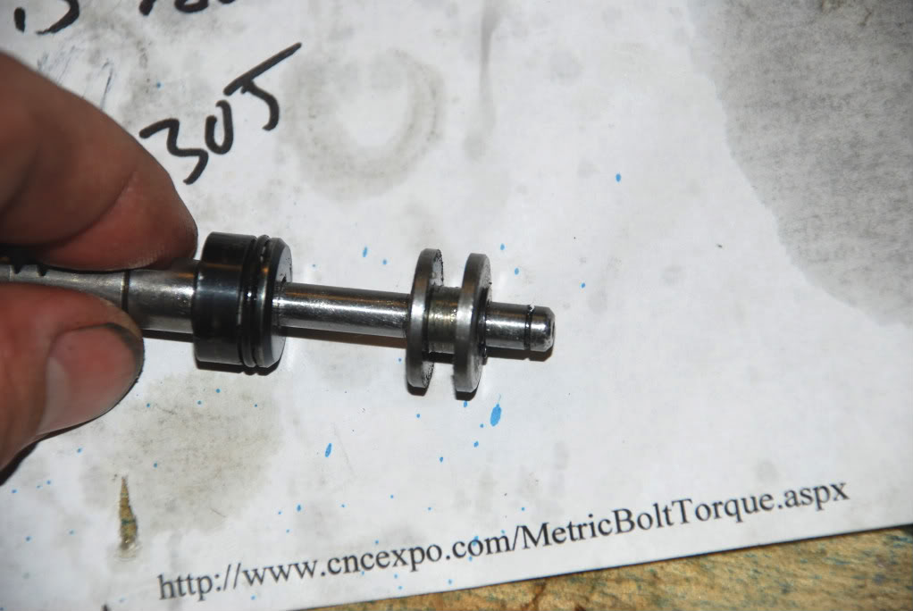

Since I dont have a stock Kips Bolt around here... can you give me the measurement differance between stock and modded. (how much further out it pushes the actuating rod)..
Im gonig to take my actuating rod out, and cut a new E-clip groove in it. to locate the arm further in for better angles.... as it sits now, when it starts to get to full travel, you can tell the arm is fighting to slide in the (ring) as its starting to want to travel downward too much...
from my quick math.. if I move the E-clip in .2305 the lever will have equal distance of travel each direction from mid stroke..
You guys are too slow...
Motorrads Jeff Wards Engine build round 2 9-7.jpg (79.7 KiB) Viewed 7573 times
Motorrads Jeff Wards Engine build round 2 9-8.jpg (76.28 KiB) Viewed 7573 times
Posted: Sun Sep 07, 2014 4:38 am
Here.. much better..
Full close/full open
Motorrads Jeff Wards Engine build round 2 9-9.jpg (79.34 KiB) Viewed 7573 times
Motorrads Jeff Wards Engine build round 2 9-91.jpg (83.8 KiB) Viewed 7573 times

alward25:
.383" and .538 I had some time and some dial calipers. That is without a crush washer.
Motorrad:
Thank you sir...
That tells me that I moved it all in farther than stock ever was... Interesting..
Okay. so I was thinking this long vs short arm thing through today..
I think Im going to run the shorter arm...
Here is why..
I think the reason they went to the longer arm is to deal with the ammount of travel the kips had.
With the kips bolt mod, we take alot of travel out of it... and with me cutting new grooves, it gets the angles better...
The Longer arm will cause MORE stress on the kips govener arm, (the one that likes to bend).. as the longer arm will reduce leverage.. ..

Well . I went out and stared at it for 20min... (Warning.. Im a case of beer in on the evening)
only thing I can come up with...
IS..
Idiots trying to pound cases on, when everything isn't lined up properly. (or seated)... (govener installed into center cases, instead of in outer case durring assembly)
Its the only way I can see the lever getting bent in the direction it is bent in..
and the "Idiot marks" on my bent lever are in perfect alignment with this theory.
