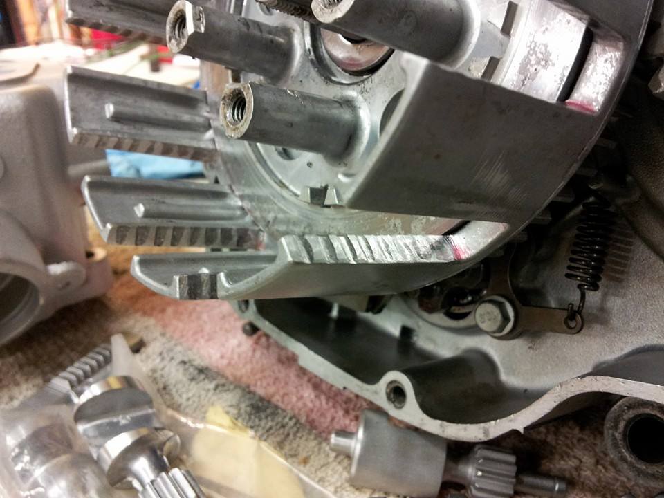

Got some new clutch plates...
queen of spodes 89 kx125 119.jpg (87.11 KiB) Viewed 11424 times
Looks like I need a new basket too. Luckily I found a NOS Matika basket in the UK, it's in route.

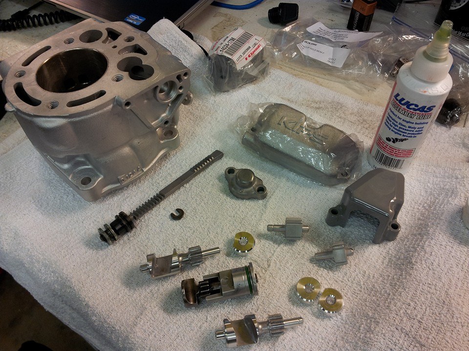

In happier news, I found the elusive RH power valve, NOS:
queen of spodes 89 kx125 121.jpg (132.67 KiB) Viewed 11424 times
Shiny happy parts
queen of spodes 89 kx125 122.jpg (129.12 KiB) Viewed 11424 times
ed out on the Lucus assembly lube and instead went with premix (Klotz R-50)
queen of spodes 89 kx125 123.jpg (204.12 KiB) Viewed 11424 times
Dry run of powervalve assembly
queen of spodes 89 kx125 124.jpg (142.51 KiB) Viewed 11424 times
Everything lined up
queen of spodes 89 kx125 125.jpg (128.18 KiB) Viewed 11424 times
