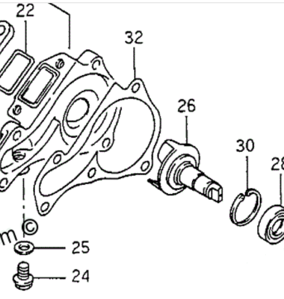

Mike, need your help on this. I have a brand new water pump impeller that was in the parts bin I bought. It looks like it may be too long, though. I have a shorter version that looks like it will fit once the case is fully lowered but I'd like to ask if you could recall what your impeller looked like and if it was a short or long stem. The guy I bought the parts from stated these were hard to find new and I was lucky he had one. The same guy who had four complete engine cases in the bin but didn't tell me one clutch case was for an RM125. The same one I decided to prep and paint to use on my rebuild!

It seemed to me it looked like this one..
Posted: Wed Aug 02, 2017 9:54 pm
1988 rm250 impeller.jpg (123.55 KiB) Viewed 10225 times

Mike, the water pump impeller you showed was not the correct one. It was actually the longer version I had.
