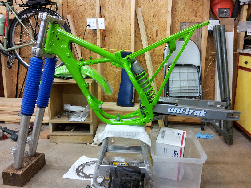

queen of spodes
queen of spodes 89 kx125 111.png (1.19 MiB) Viewed 9363 times
Re: Queen of Spodes 89 KX125 Kawasaki complete rebuild
Posted: Tue Nov 11, 2014 3:52 am
motojason
Frame looks great!

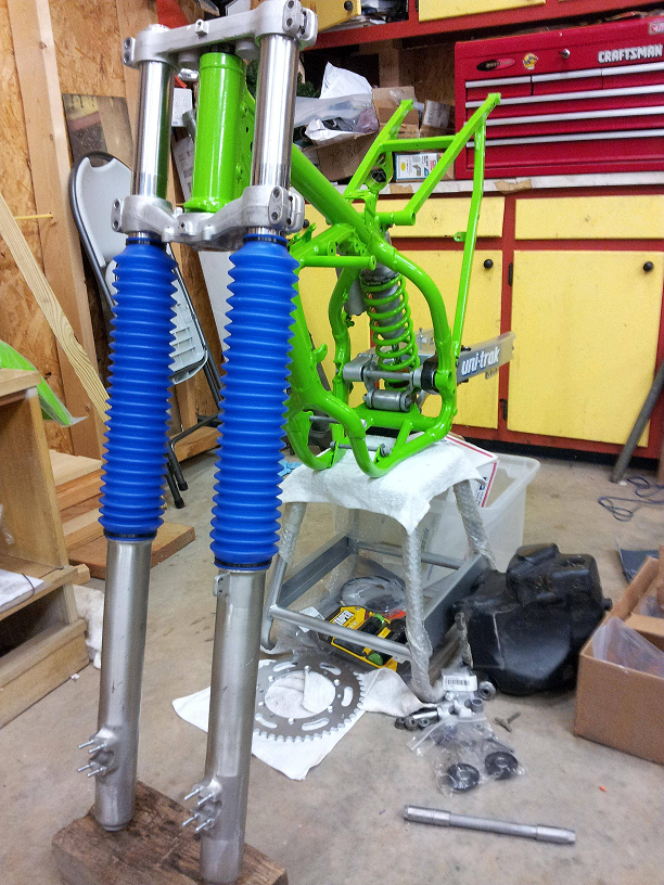

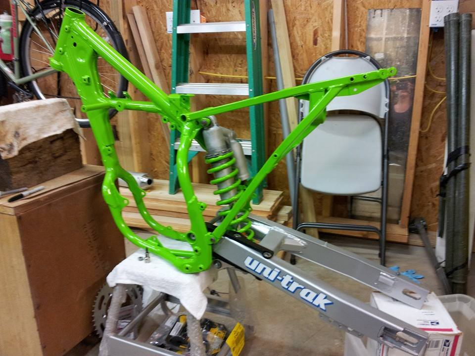

queen of spodes
queen of spodes 89 kx125 112.png (1.09 MiB) Viewed 9363 times
queen of spodes 89 kx125 113.png (1.08 MiB) Viewed 9363 times

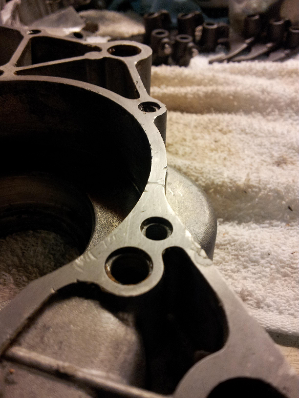

queen of spodes
Help!
I lapped case halves tonight using the bolt method. They are tight now, used to have some light shine through, now virtually none.
I did spot this troubling defect:
queen of spodes 89 kx125 114.png (820.03 KiB) Viewed 9363 times
This little scratch catches on my fingernail. Will Yamabond seal it up, or do I have a problem on my hands?
Posted: Tue Nov 11, 2014 3:59 am
sandblaster
Yamabond might do it but I like to fill them first with JB Weld.
viewtopic.php?f=40&t=411
queen of spodes
I was thinking of that - thanks!
