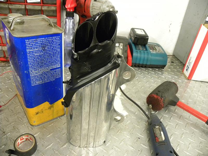

A little grinding after weld (My buddy Travis):
A little sanding after grinding:
A little finish polishing:
A little paint..
Stay tuned :-)

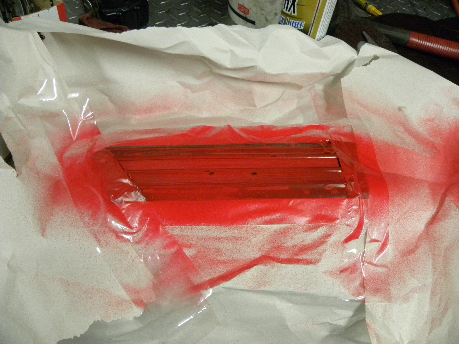

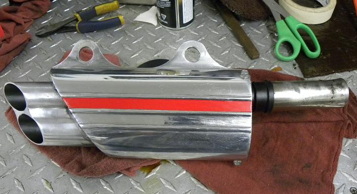

Posted: Mon Jan 14, 2013 8:52 pm
One stripe down.
I'm sure that adds about 5 HP :D
Now I will wait till tomorrow to paint the other strip as I have to let it dry or I'll pull off the existing stripe with the tape :o

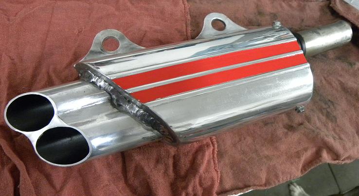

Posted: Tue Jan 15, 2013 11:25 pm
Ok here is a picture of the final product.
The first mod was quick and easy.
The second mod was a bit more work then I thought.
Although it would really help if I could weld aluminum myself and had some decent tools for cutting the aluminum.
I used a sawsall, jigsaw, and a bench grinder for most of the work on this so it takes a while :D
But hey, an extra 25 HP for the muffler and an additional 10 HP for the racing stripes, (5 HP each) it's a real bargain :lol:
stripe double.JPG (52.07 KiB) Viewed 17710 times
If I were going to do another the only thing I would change would be the angle of the muffler.
For some reason (Just how it looked?) I used a 53 degree angle.
A 45 degree angle would have given me a bit more internal baffling and screen to work with and slightly less cutting once I got it apart.
But over all I am very happy how this turned out.
My next step on the muffler is some final polish and then I want to coat it with a product called Sharkhide Metal Protectant.
Look for that on a future product review.
Posted: Fri Jan 18, 2013 9:41 pm
by foxx4Beaver
tell ya what....for only having primitive tools to work with,it looks pretty damn good!!!....nice job!!
