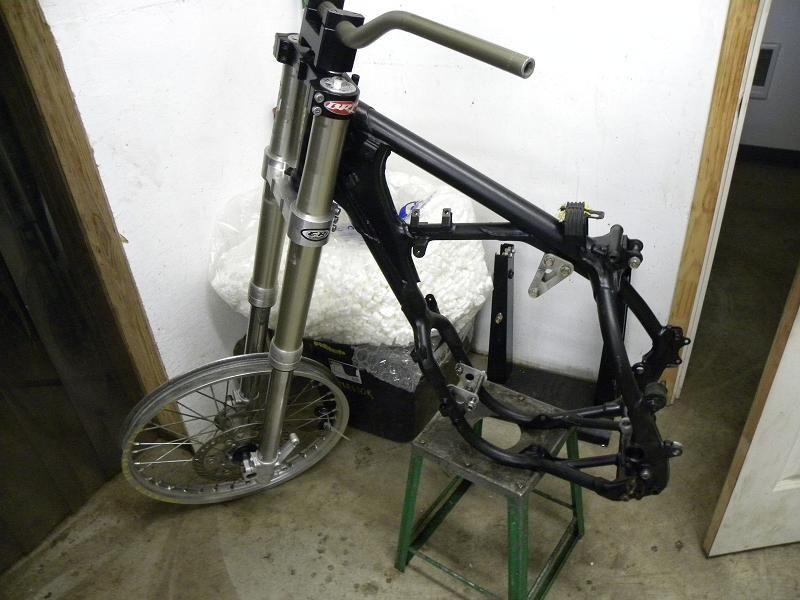

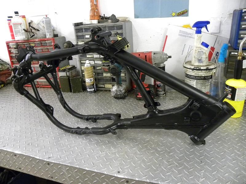

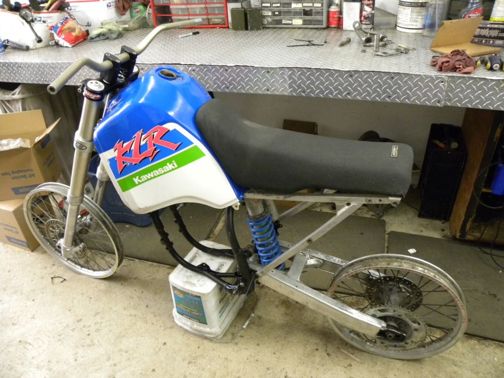

Ok, the DMV want's it to look like a bike before they will transfer the title.
They said it didn't have to have an engine in it so this is what I have come up with:
I'll let you know what they say tomorrow :D

I went to the DMV this morning.
There were further questions about the bike not having an engine or odometer.
I explained to them what I had been told the first trip in, that the engine was not required and nobody said anything about an odometer.
However, I told them that I would go back to the shop and get a odometer.
After looking the paperwork over they said it wasn't really necessary as there was no mileage on the bike from the previous owner.
So here was the result:

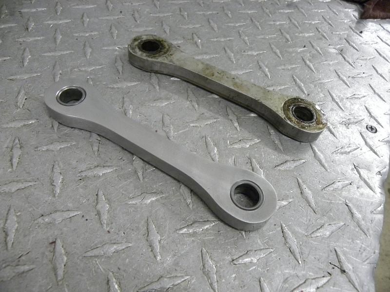

Here is some items that are often over looked.
Clean and not clean:
A little WD-40, 120 and 240 grit sand paper, and a quick trip to the wire wheel does wonders :D
I didn't want the polished look, just clean.
I also wanted to clean up the rough machine work on the edges.
I don't want to build a show bike, just a well oiled street sleeper 8-)

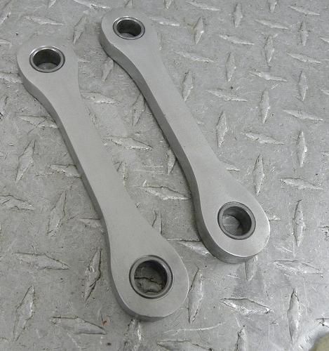

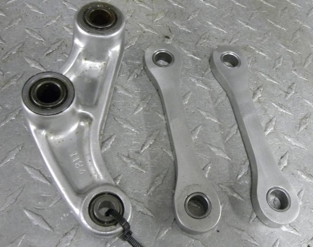

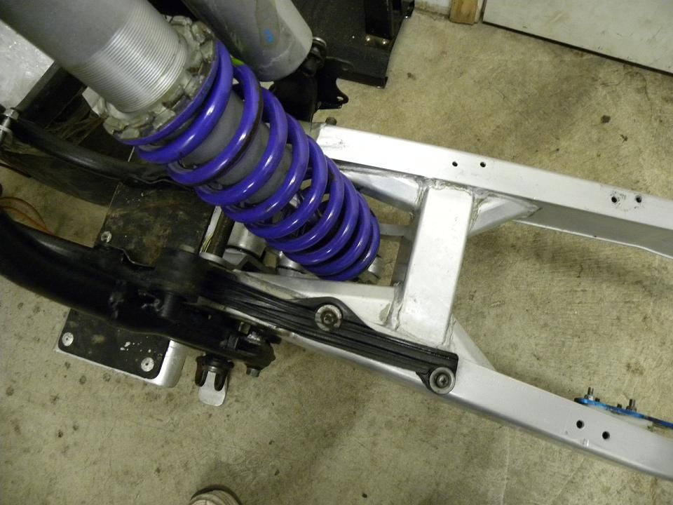

One of the most abused parts and the least maintained is the shock arm link.
A good cleaning is in order.
Normally, when I get one this far apart I always replace all the bearings.
However, these bearings were like new.
So, I gave them a good cleaning, greased them up, and installed them.
Now, it's all ready to mount up:

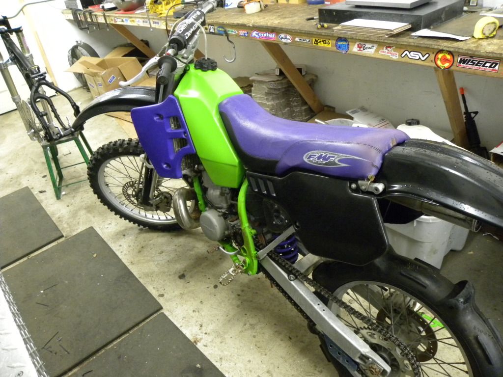

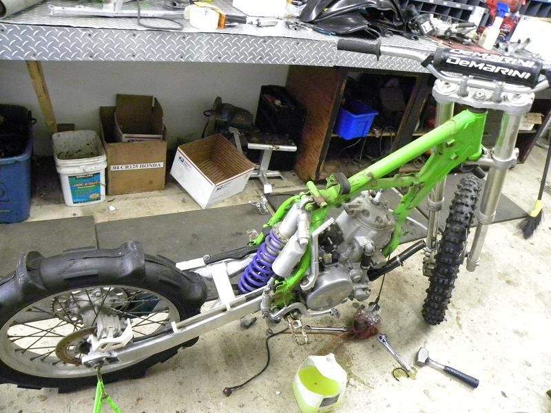

Today the 1994 KX500 Donor bike arrived.
Visually it looks good for a 94.
We know that 3rd gear is bad so we'll see what happens when we get it opened up :lol:

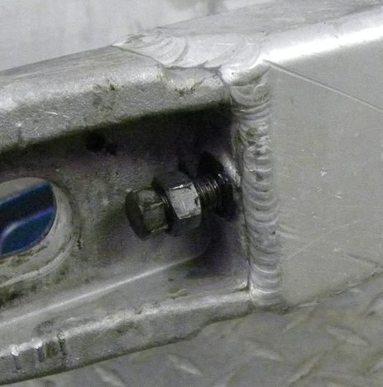

As I was test fitting the parts I discovered that one of the sub frame inserts is stripped out.
It was fixed using a Heli-Coil.
However, the stock bolt could not be used and I wanted to use the stock bolt.
Here is a link to another article on how I handled the problem:
viewtopic.php?f=40&t=156
Here is some pics of where I am at.
Donor Bike:
K5SM

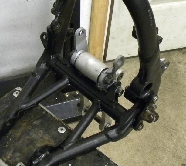

Every nut and bolt is being cleaned and lucubrated before assembly onto the K5SM.
I like it when the nuts and bolts fit properly ;)

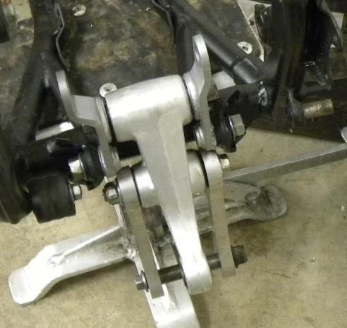

After cleaning, inspecting, and greasing all the parts, assembly is required :-)
It is nice working with clean parts...

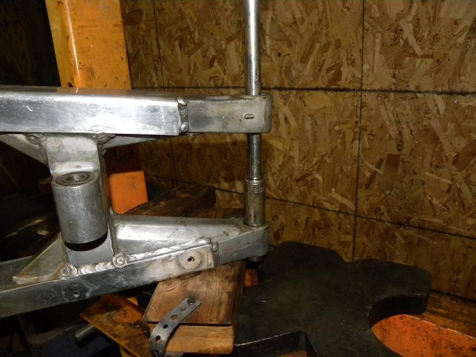

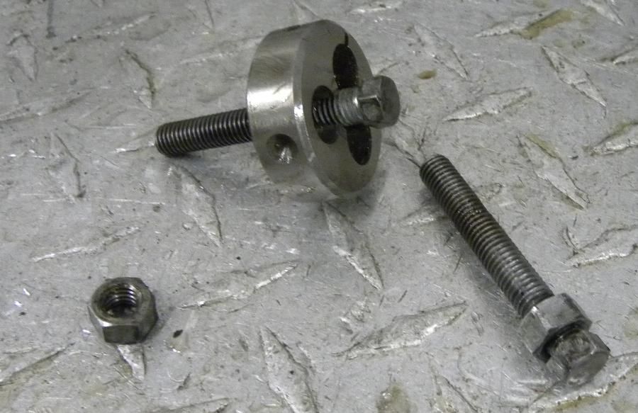

Another area often over looked until it's too late is the chain adjustment bolts.
These weren't too bad yet:
After removing the bolts, I ran a die over them to be sure there was nothing to cause any problems.
Out with the old bearings and in with the new bearings:
Assemble as required...
Here is where we are at for today:
More to come so stay tuned...
