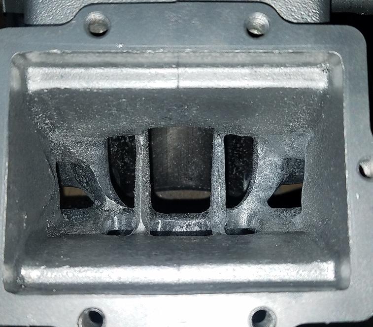

I spent a few more hours porting today..
KX GURU RACING 1992 KX500 SNOW BIKE ENGINE BUILD FOR BRENT 141.JPG (79.01 KiB) Viewed 12885 times
A lot of work getting these to blend with the skirt...
It is still in it's rough cut stage but the hard part is done..

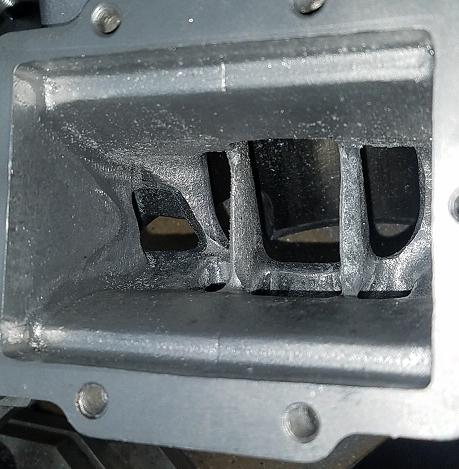

KX GURU RACING 1992 KX500 SNOW BIKE ENGINE BUILD FOR BRENT 142.JPG (91.28 KiB) Viewed 12885 times
Look at the left side of the cylinder... That is Eric's work.
Now look at the right side.... That is our work.
You'll note how much better the blends are where the different surfaces meet... Not to mention we need it to breath a bit better then how it was set up :ugeek:
The object is to get higher port velocity and volume...

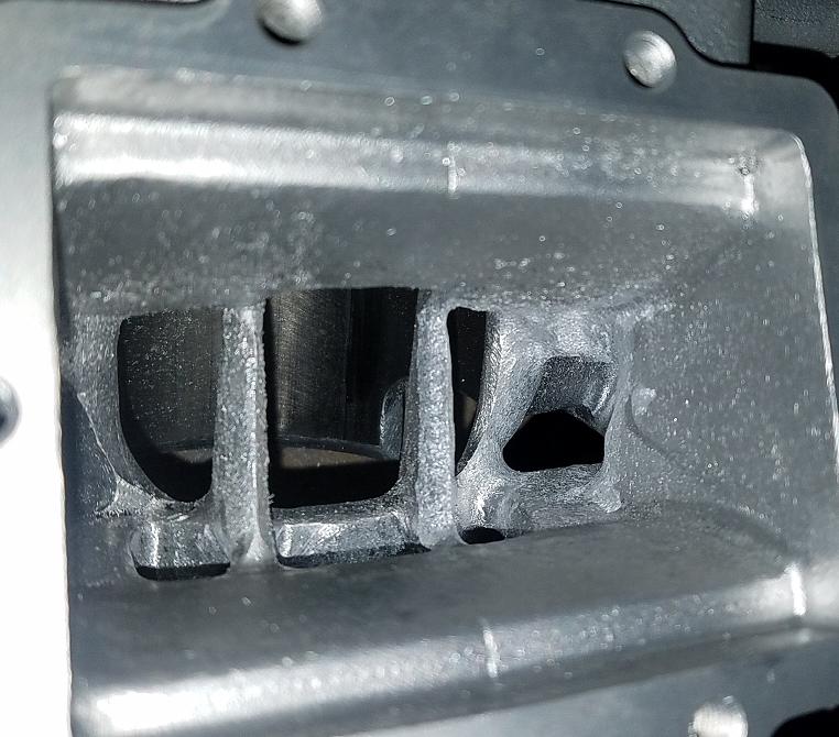

Posted: Tue Dec 20, 2016 12:42 am
Our work..
KX GURU RACING 1992 KX500 SNOW BIKE ENGINE BUILD FOR BRENT 143.JPG (75.99 KiB) Viewed 12884 times
Eric's work
KX GURU RACING 1992 KX500 SNOW BIKE ENGINE BUILD FOR BRENT 144.JPG (39.33 KiB) Viewed 12884 times
And, I'm still not done with the right side yet... :mrgreen:
