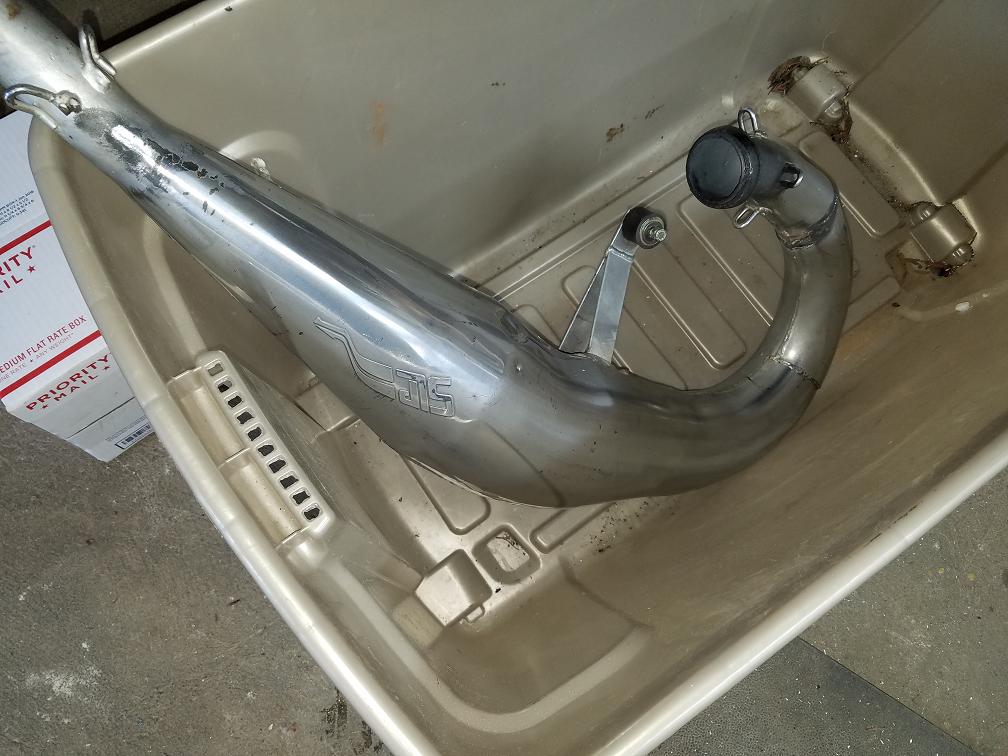

Waiting for installation...
JT ENGINE WORKS 89 CR500 CART ENGINE BUILD 148.JPG (118.01 KiB) Viewed 4381 times

So... here is what we know.
The mechanical fuel pump was too small for the CR500.
The pipe was cracked.
The muffler was under packed.
All that conspired to lean it to the max.
We have it running great now.
Wheelies are amazing :lol:
