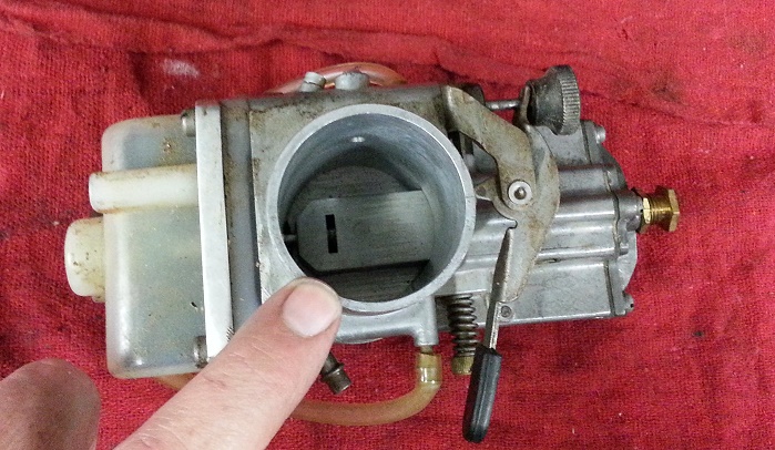

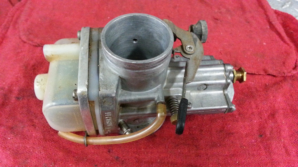

Something huge showed up last week..
www.oem-cycle.com 44mm lektron 101.jpg (289 KiB) Viewed 19777 times
www.oem-cycle.com 44mm lektron 102.jpg (159.42 KiB) Viewed 19777 times

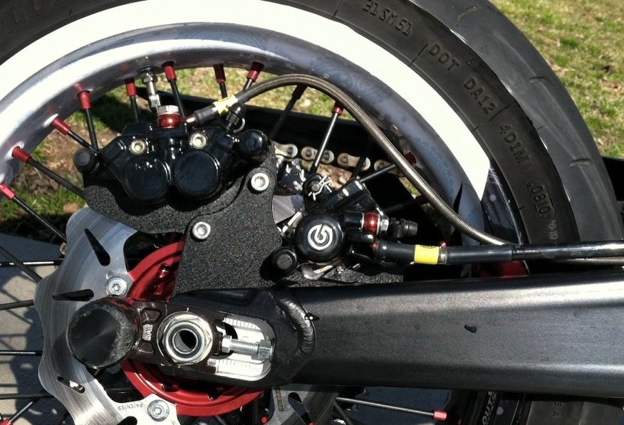

Hmmmm. My next brake mod?
rear brake mod.jpg (210.71 KiB) Viewed 19675 times

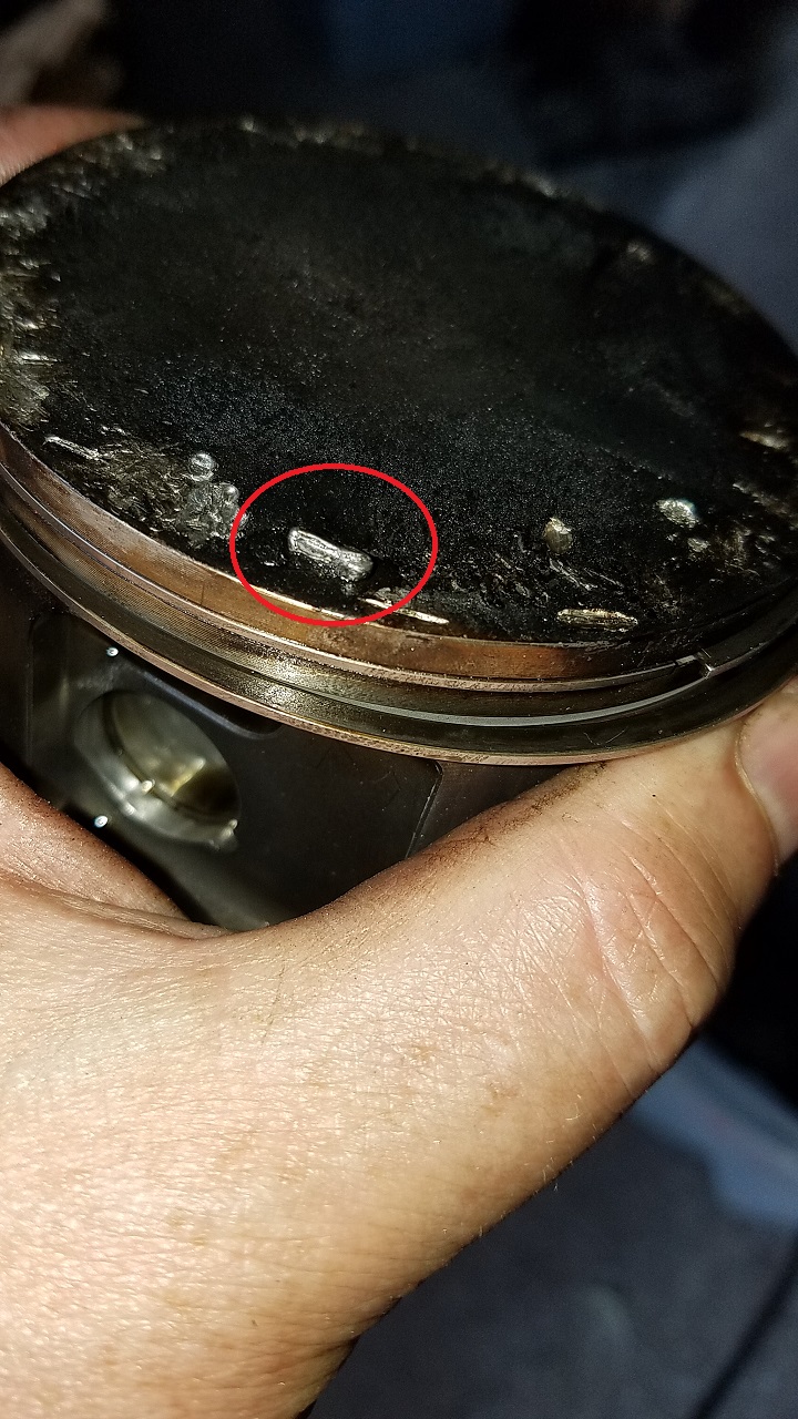

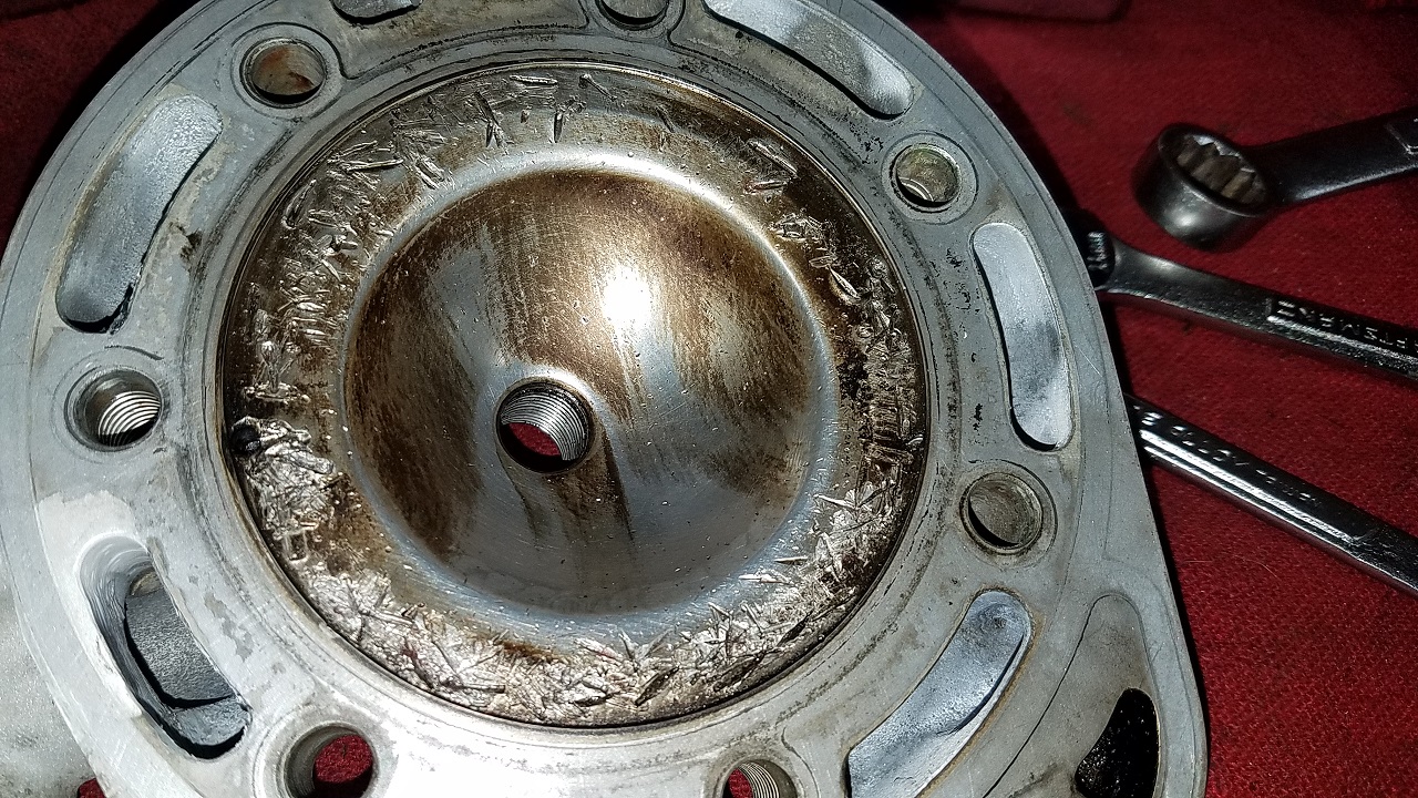

Well... It's been about 6 years since I built this bike when catastrophe happened.. :o :o :o
I was climbing a dune and misjudged the amount of speed it would take to just barely clear the top so I had to wind this baby up and leave it there for about 10 seconds... I made it to the top when I heard a rattling sound... I shut the engine off and got towed behind a side by side a few miles back to camp in the deep sand :(
I just let the bike sit in the garage for the last several months because I thought that I had ran it too lean and smoked the piston...
Well... the piston was smoked but not from being ran too lean...
Supermoto smoked top end 11.jpg (361.7 KiB) Viewed 18130 times
Supermoto smoked top end 102.jpg (527.84 KiB) Viewed 18130 times

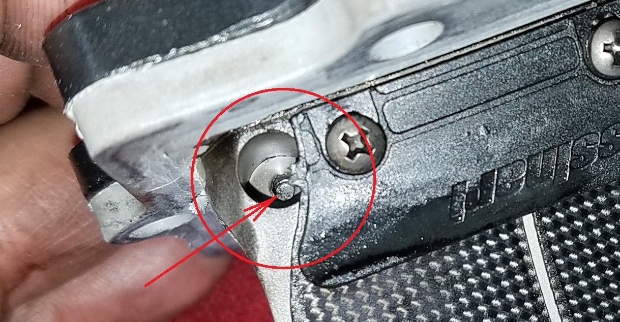

Posted: Wed Jun 13, 2018 4:19 am
As soon as I saw it I had a feeling I knew where that small bolt had come from...
Supermoto smoked top end 103.jpg (362.23 KiB) Viewed 18129 times
In one of my "How To" threads I specifically say that if you use a VF2 reed that you need to take all the bolts out and use thread locker on them.
Apparently the Blue I used wasn't enough... So next time I will use the red... 8-)

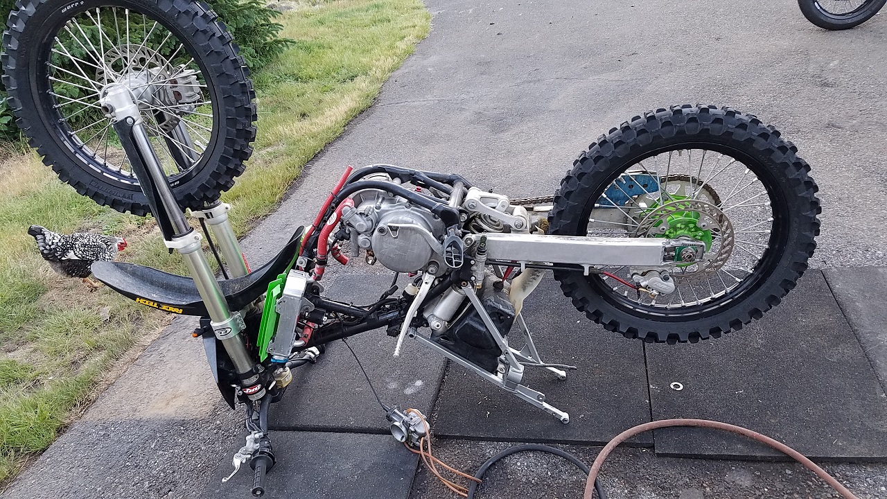

So here my baby sits in need of some love...
Supermoto smoked top end 104.jpg (621.29 KiB) Viewed 18129 times
After I get some fork cleaner in town tomorrow I will rinse out the bottom end and get it prepped for a test top end.
Yes.... Test top end.... :?: :lol:
