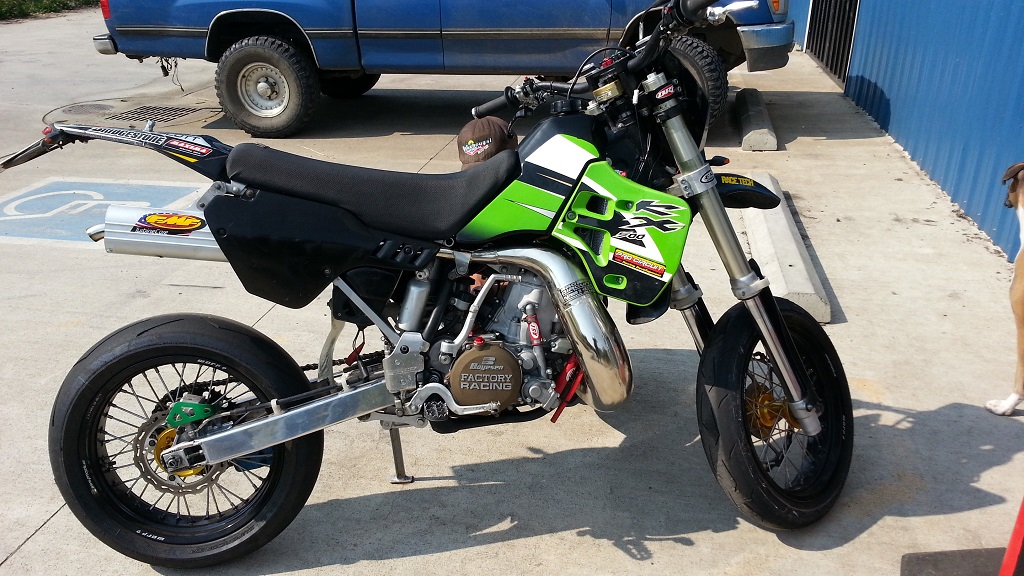

Definitely running cooler.... but I'll record some accutemps this weekend...
2001 kx500 kawasaki street tard 8-6-14.jpg (278.94 KiB) Viewed 16353 times

Posted: Fri Aug 22, 2014 4:49 am
Excuse the messy garage... :oops:
2001 kx500 kawasaki street tard 8-21-14.jpg (309.15 KiB) Viewed 16282 times
Posted: Wed Aug 27, 2014 3:46 am
Now for a quick recap.
I did the water pump impeller clearance mod.
I cleaned up all the water passages.
Cleaned up oil passages in the cases.
I have a re-cut head.
Chinese Rads.
Stock port timing.
Cleaned up cylinder transfers, ports, and bridges.
Balanced crank.
Wossner windowed piston.
VF2 Reed with modded boot.
41mm carb jetted a bit rich at the moment.
Running 1 qt of distilled waterper 2 oz of Royal Purple's Purple Ice (Bought it at Napa).
MZB ignition with a flywheel that is 1lb lighter then stock.
My bike has never ran so cool and with so much smooth power.
Time to start another build with some advanced port timing
