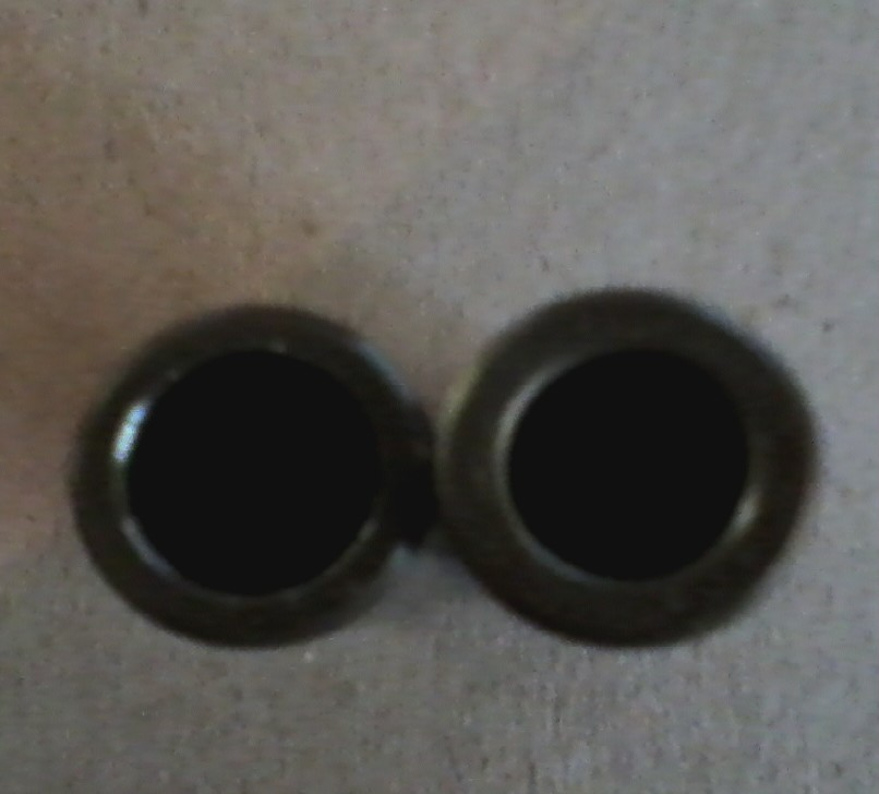

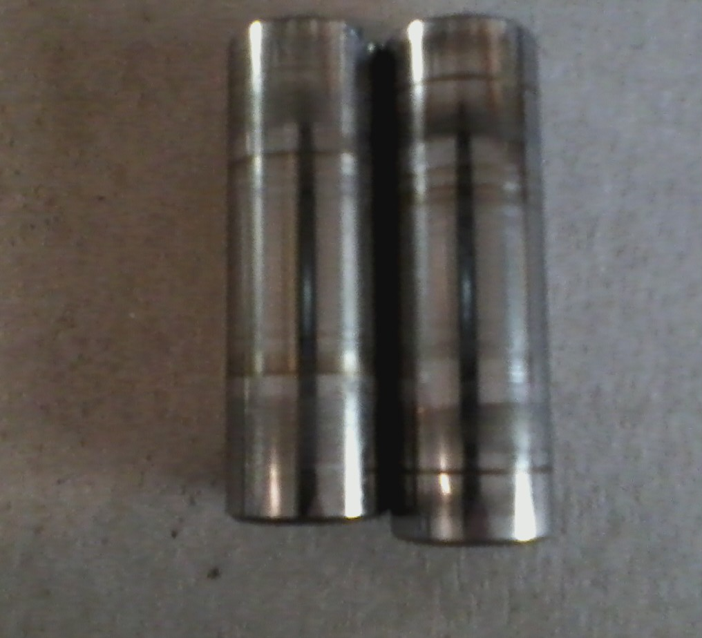

Foxx4Beaver:
yeah the Wiseco pins are like a chunk of lead compared to the Wossner....I don't have a scale handy, but you can clearly see the substantial difference between the two. Wossner on the left Wiseco on the right.
KX500 JEFF WARD ROUND 3 REBUILD 1034.png (1.2 MiB) Viewed 8942 times
KX500 JEFF WARD ROUND 3 REBUILD 1035.png (600.81 KiB) Viewed 8942 times
I don't have an OEM pin on hand...but there is a thread that shows the OEM is 4grams lighter than Wiseco.
