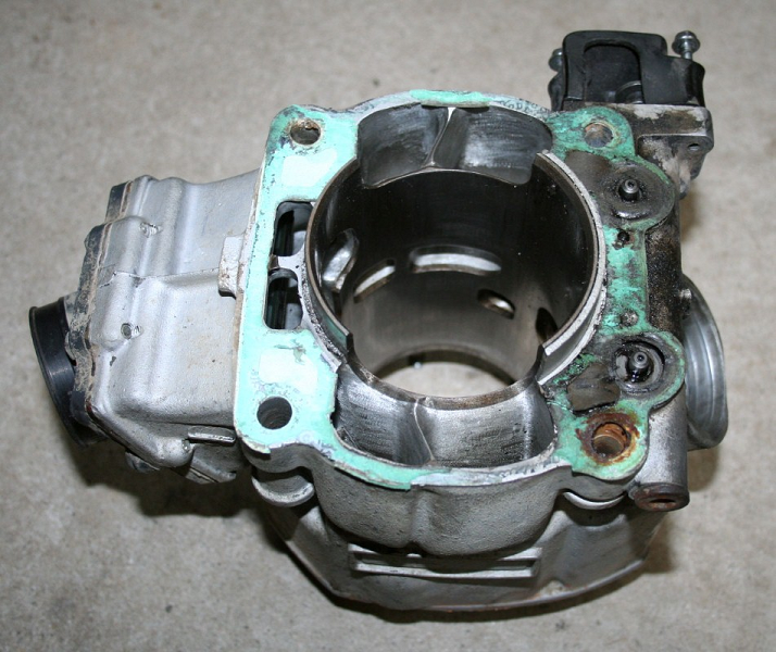

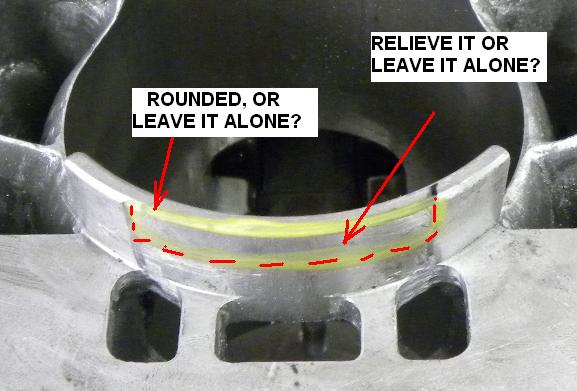

Sandblaster wrote:The following questions are for Motorrad but others feel free to join in :lol:
You want to round a lot of those items you pointed to free hp

Yes, I thought you used some sort of motorradish style of applicator... the pen :D
Qsixteen
Agreed, rounding is good.

I don't know where this work came from but I want to be clear that it is NOT mine.
cylinder 1.JPG (19.92 KiB) Viewed 14456 times
cylinder 2.JPG (20.45 KiB) Viewed 14456 times
cylinder 3.JPG (48.22 KiB) Viewed 14456 times
cylinder 4.JPG (50.48 KiB) Viewed 14456 times
cylinder 5.JPG (43.65 KiB) Viewed 14456 times
CYLINDER 6.JPG (47.34 KiB) Viewed 14456 times
