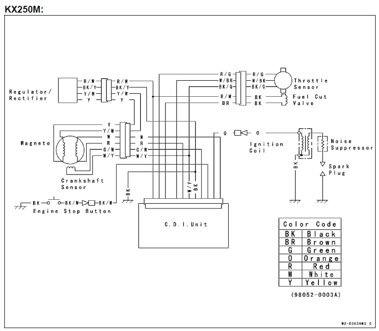

Leo Sadzewicz: I’d like to mention the kx250 has 3D mapping which is one of the things that makes this mod SO sweet 😁
The power D just has one curve to my knowledge and cannot support a tps or a power jet.
That is the reason I didn’t buy the power D

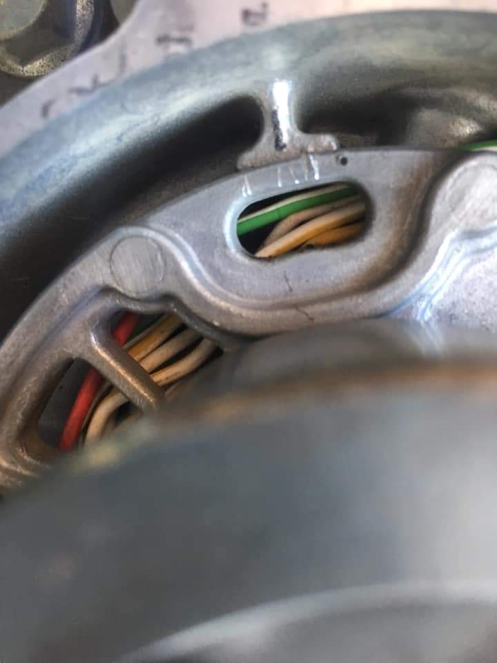

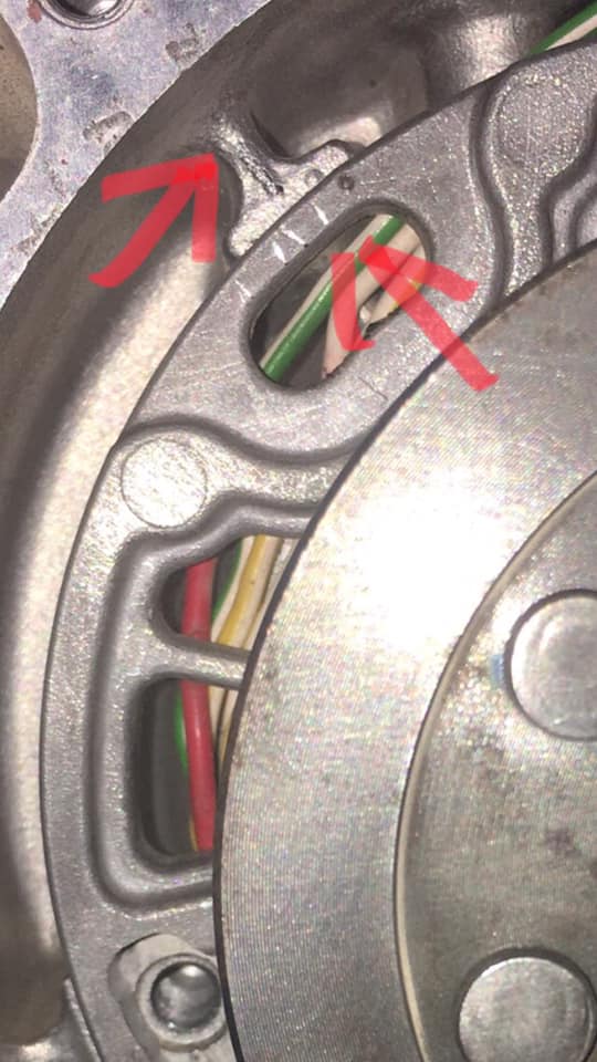

Re: Kx500 TPS and power jet how to by Leo Sadzewicz
Posted: Mon Oct 29, 2018 1:14 am
Update from Leo Sadzewicz:
Timing needs to be here or even a little more advanced or top end will be a little flat

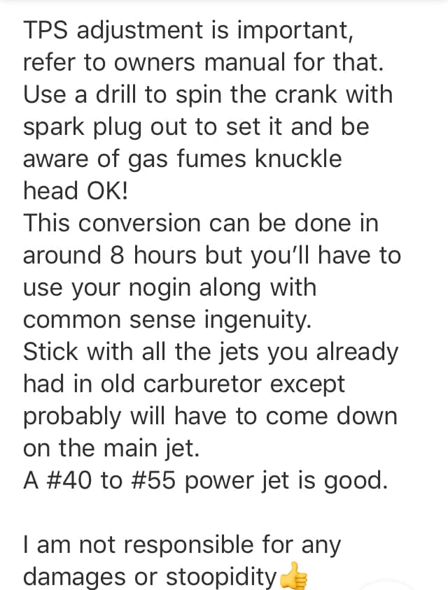

Leo Sadzewicz jetting info..
4000’
#9 slide
172
58
A N82N 3rd has best top end
A N89D 3rd slightly richer at full throttle.
#55 power jet is too rich.
40 works great but I haven’t tried a 42,45, or 48 yet. Just ordered them
