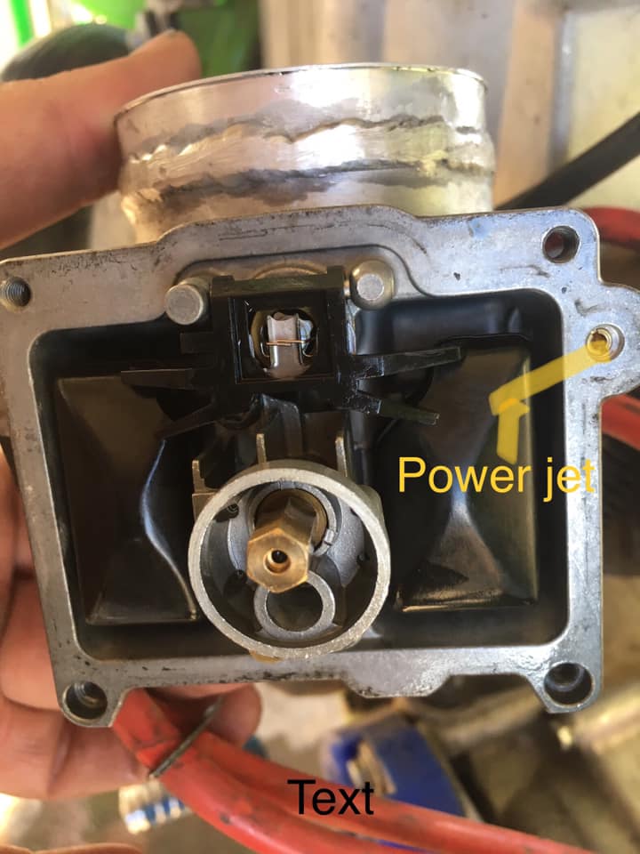

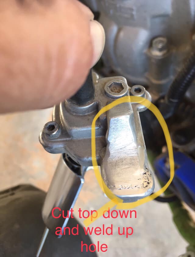

Kx500 TPS and power jet how to by Leo Sadzewicz
He used a 2000 kx250 ignition and flywheel in his kx500
Another guy used a 1999 kx250 set up with the same results.
