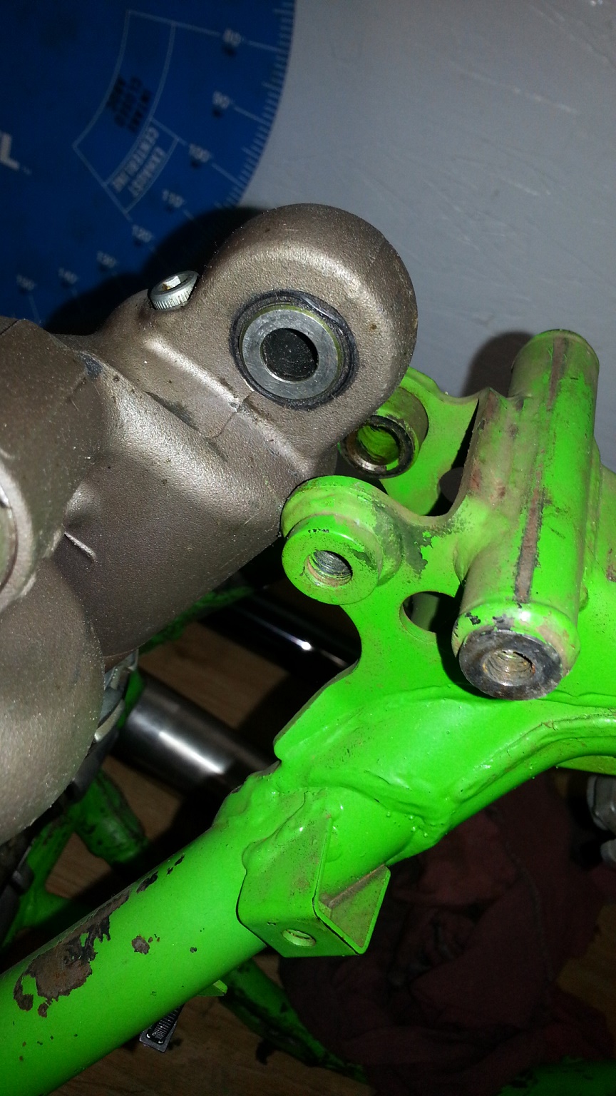

KX500 WITH A KX450F REAR SHOCK 104.JPG (39.17 KiB) Viewed 11312 times
KX500 WITH A KX450F REAR SHOCK 105.JPG (37.14 KiB) Viewed 11312 times

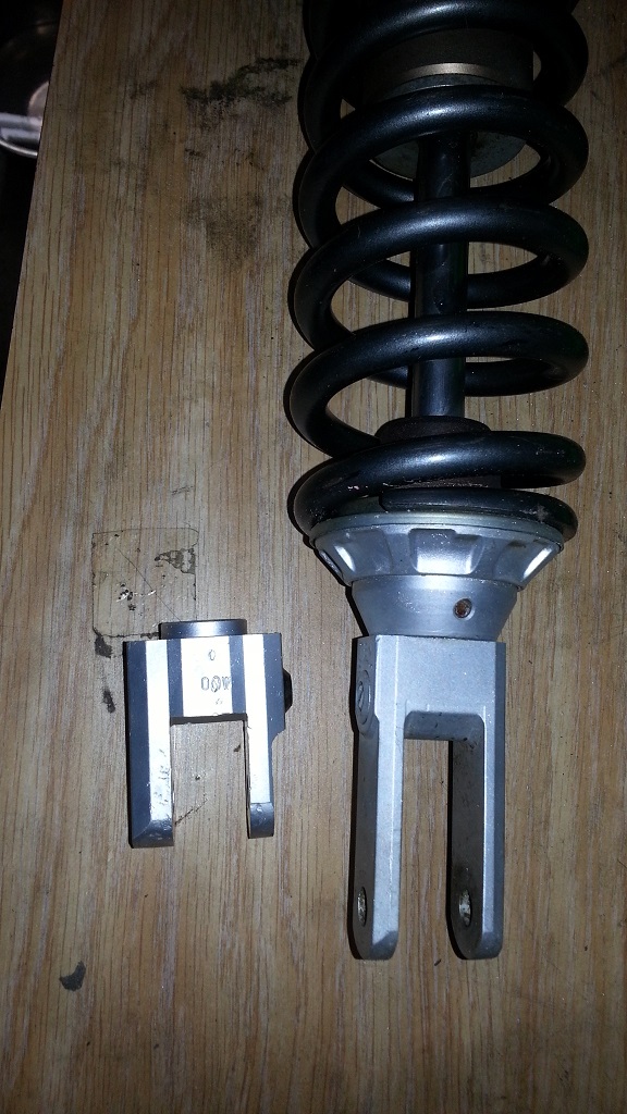

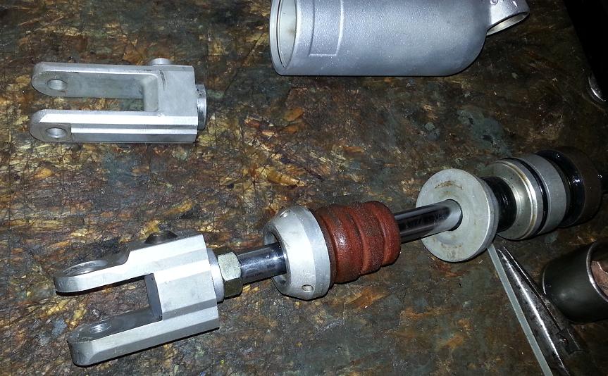

Here is the issue with the clevis..
KX500 WITH A KX450F REAR SHOCK 106.JPG (71.83 KiB) Viewed 11311 times
Posted: Thu Oct 01, 2015 10:01 pm
OK... Sometimes you feel like a dummy...
I unscrewed the clevis off a 92 kx250 shock (Same as the KX500 clevis) and screwed it right on the KX450F shock.. 8-)

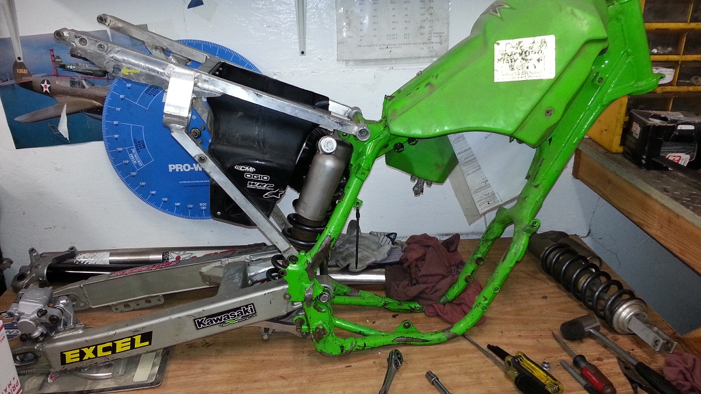

Before I go any further, I need a mock up.
Turns out I just happen to have a few spares laying around...
Except for the stupid swingarm that I had to buy on eBay :?
