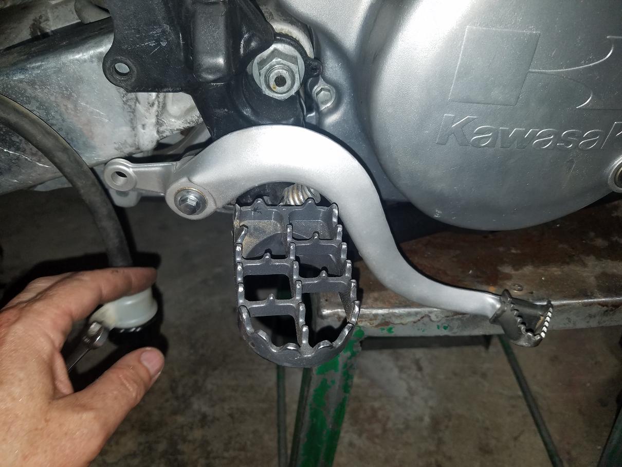

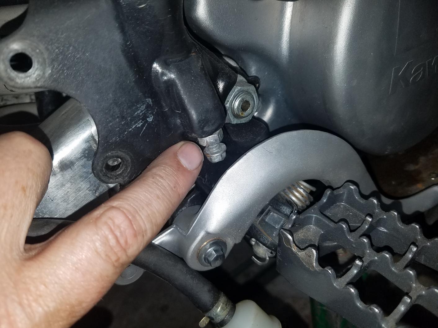

For now I will remove the bolt but in the future, I will remove the mount and help streamline the frame..
KXGURU.COM KX500 REAR BRAKE MOD 108.JPG (199.48 KiB) Viewed 16621 times
All the way down.... No problem..
KXGURU.COM KX500 REAR BRAKE MOD 109.JPG (152.5 KiB) Viewed 16621 times
All the way up.. Perfect
KXGURU.COM KX500 REAR BRAKE MOD 110.JPG (171.1 KiB) Viewed 16621 times
You can watch the smooth action here:

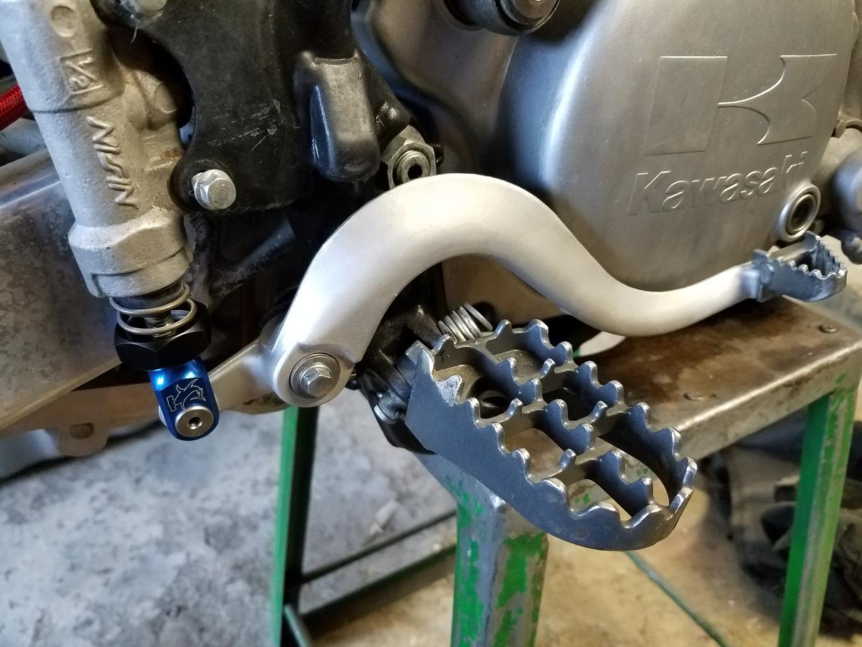

Here is a pic with the Hammerhead Spring and Clevis kit installed.
KXGURU.COM KX500 REAR BRAKE MOD 111.JPG (158.34 KiB) Viewed 16618 times
Perfect... :D

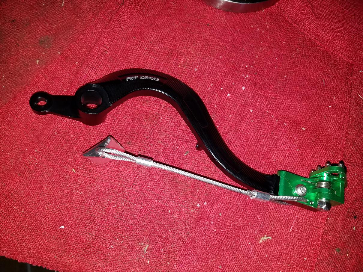

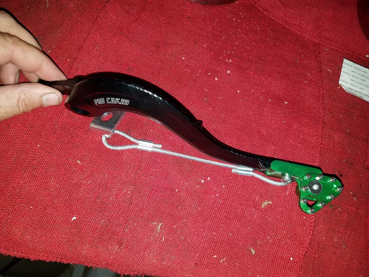

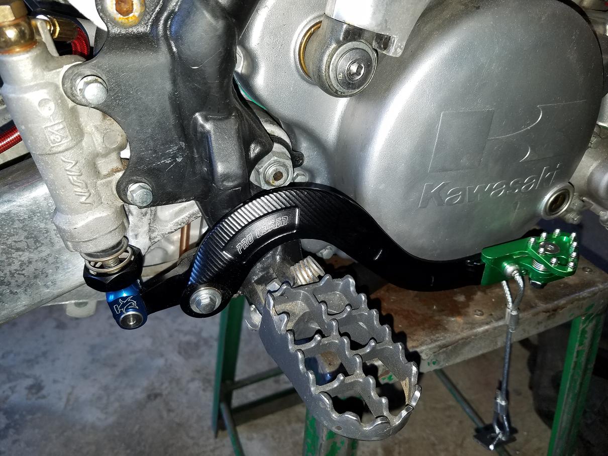

Ok... I received a cheapo rear brake lever with a folding tip...
KXGURU.COM KX500 REAR BRAKE MOD 112.JPG (375.29 KiB) Viewed 16607 times
KXGURU.COM KX500 REAR BRAKE MOD 113.JPG (366.08 KiB) Viewed 16607 times
Looks good...
Pressed in two bushings and...
KXGURU.COM KX500 REAR BRAKE MOD 114.JPG (219.98 KiB) Viewed 16607 times
Fits perfectly...
So, on to the next issue... the rear brake caliper mount...

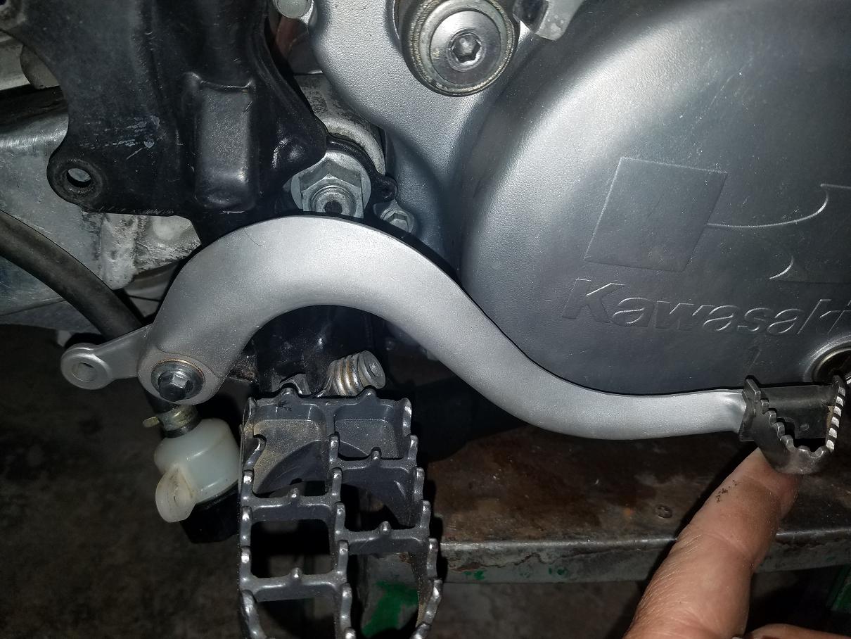

In case you want to do the rear brake lever conversion, use the KX250F rear brake lever 04-16.
You will need two bronze bushings, ID 12mm, OD 16mm, Length 12mm.
Once you press the new bearings in, you will need to slightly ream the ID of the bushings as they do not want to slip right on.

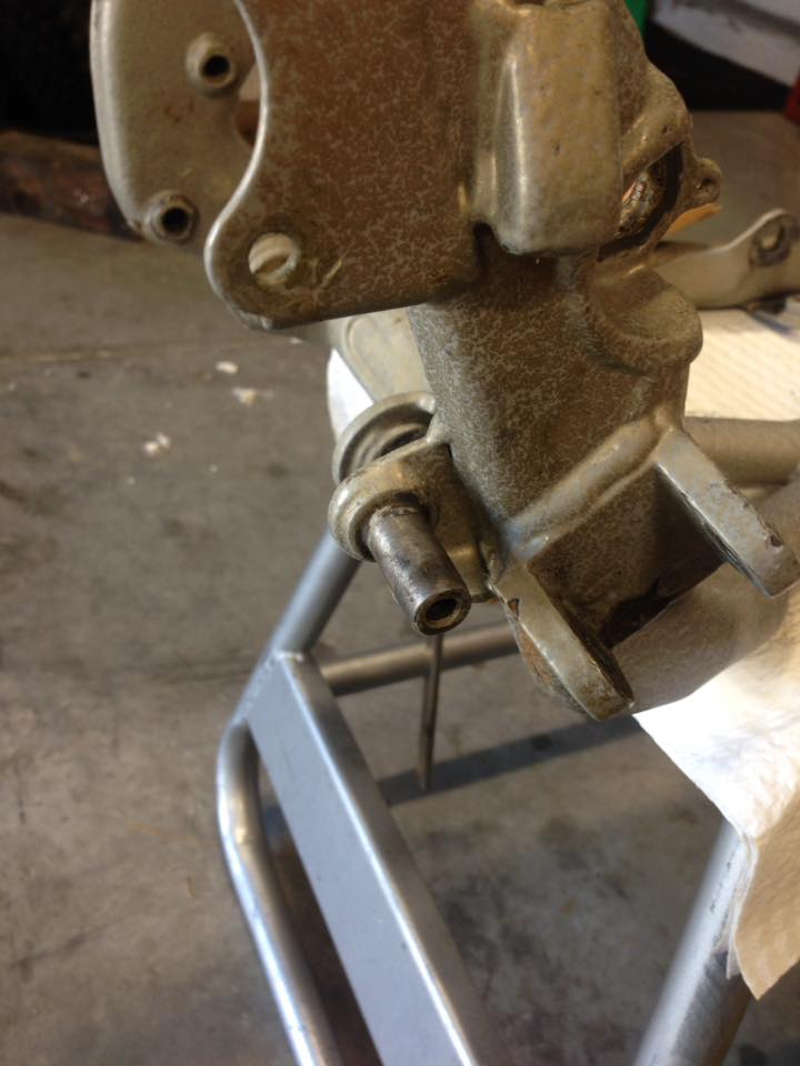

Here is another way to upgrade your rear brake lever.
This was wrote By Alex Ward KX Guru team member:

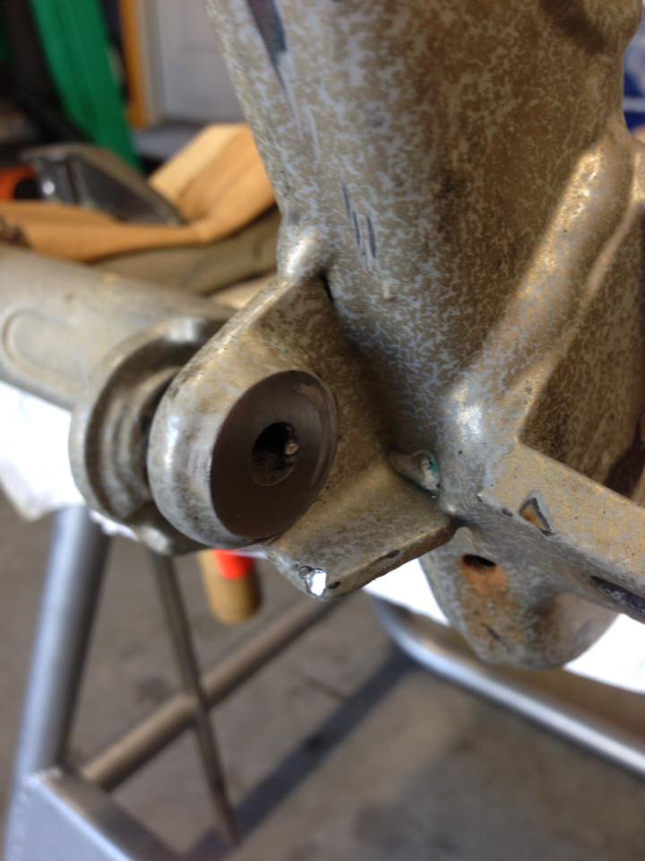

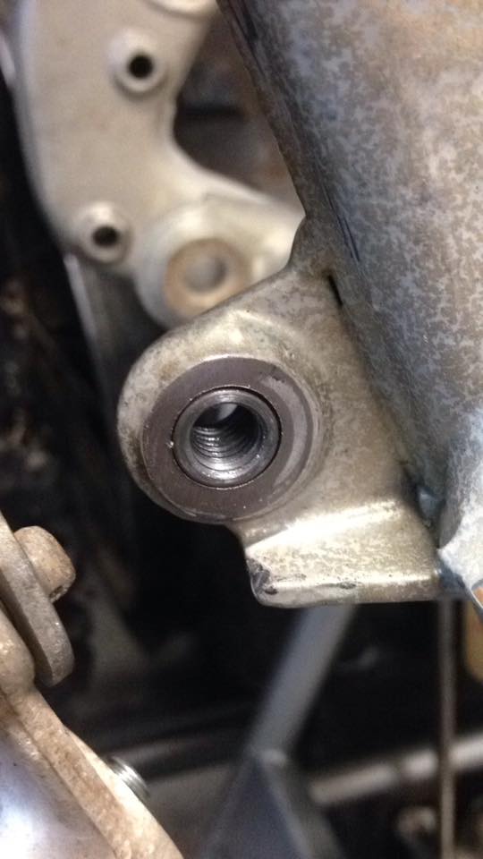

One mod I had been kicking around. The rear brake pedal post wears funny. So, this helps solve that problem. After you cut the post off, M8 1.25 time-sert solid insert and a KX 450F/250F brake pedal and use a 2000 or newer kx 250 2t pivot bolt.
time-sert kit.png (162 KiB) Viewed 15876 times
The first step is to remove the post.
After you cut the post off you will need to tap the hole with the correct tap size for the OD of the Time-Sert
Next you install the Time-Sert and your ready to mount the brake pedal on.
