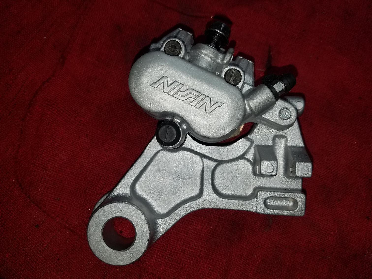

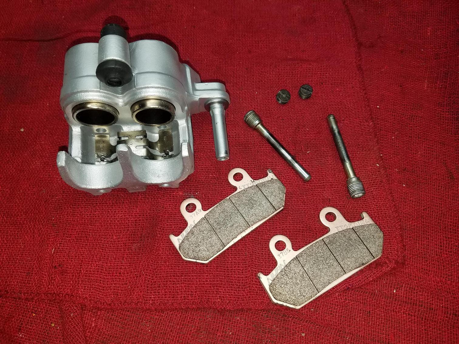

I ordered a set of 1994 CBR600 F2 front brake calipers for 30.00 including shipping and they were advertised as Used and usable.
KXGURU.COM KX500 REAR BRAKE UPGRADE CBR600 1994 101.JPG (66.03 KiB) Viewed 14331 times
When I got them I quickly discovered that the seller has no idea what a good set of calipers is suppose to function like.
The pistons were severely stuck.
After some serious cleaning, 150lbs of air, more scrubbing, and some general maintenance, I finally have a caliper that is worth the effort.
I'm certain a less stubborn person would not have recovered this caliper ;)

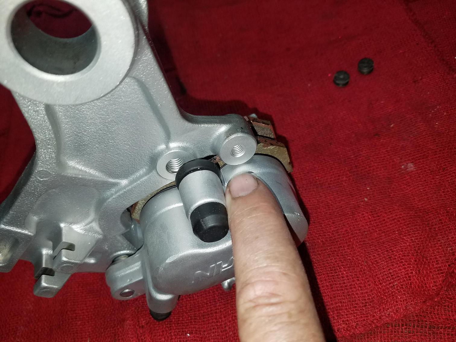

At this point I'm not doing a full rebuild.
I'm just testing to see if this is possible and how well it works..
As you can see, the caliper guard mounting hole is in the way.... So off it goes..
KXGURU.COM KX500 REAR BRAKE UPGRADE CBR600 1994 104.JPG (243.29 KiB) Viewed 14330 times

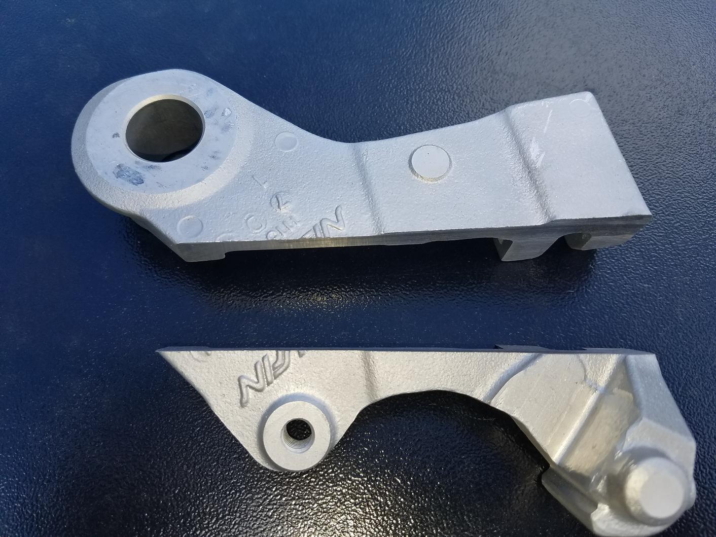

Once that was out of the way it became apparent that I needed to trim a bit more off the mount here and there for clearance of the caliper and the pads.
No biggie, that's what a Sawsall is for :lol:
So here we are.
The mount and caliper are together and this appears to be a viable conversion.

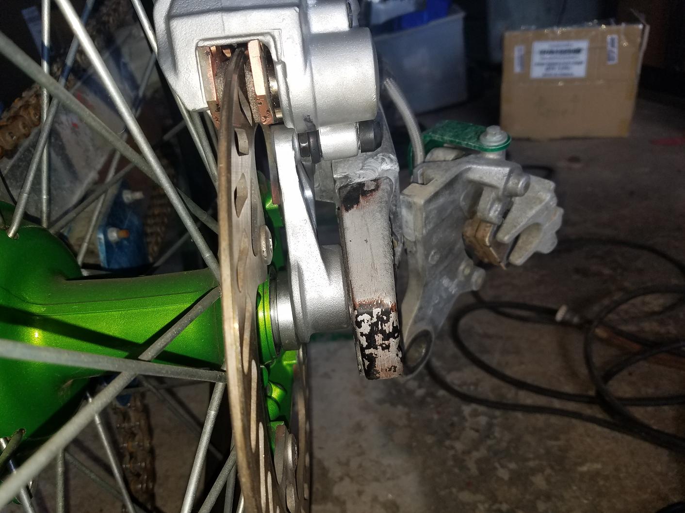

Here is what happens if you try to mount everything up without extending the mount.
KXGURU.COM KX500 REAR BRAKE UPGRADE CBR600 1994 107.JPG (199.45 KiB) Viewed 14301 times
I cut the mount so that I could add the spacer.
The band saw I used removed about 1.5mm of material.

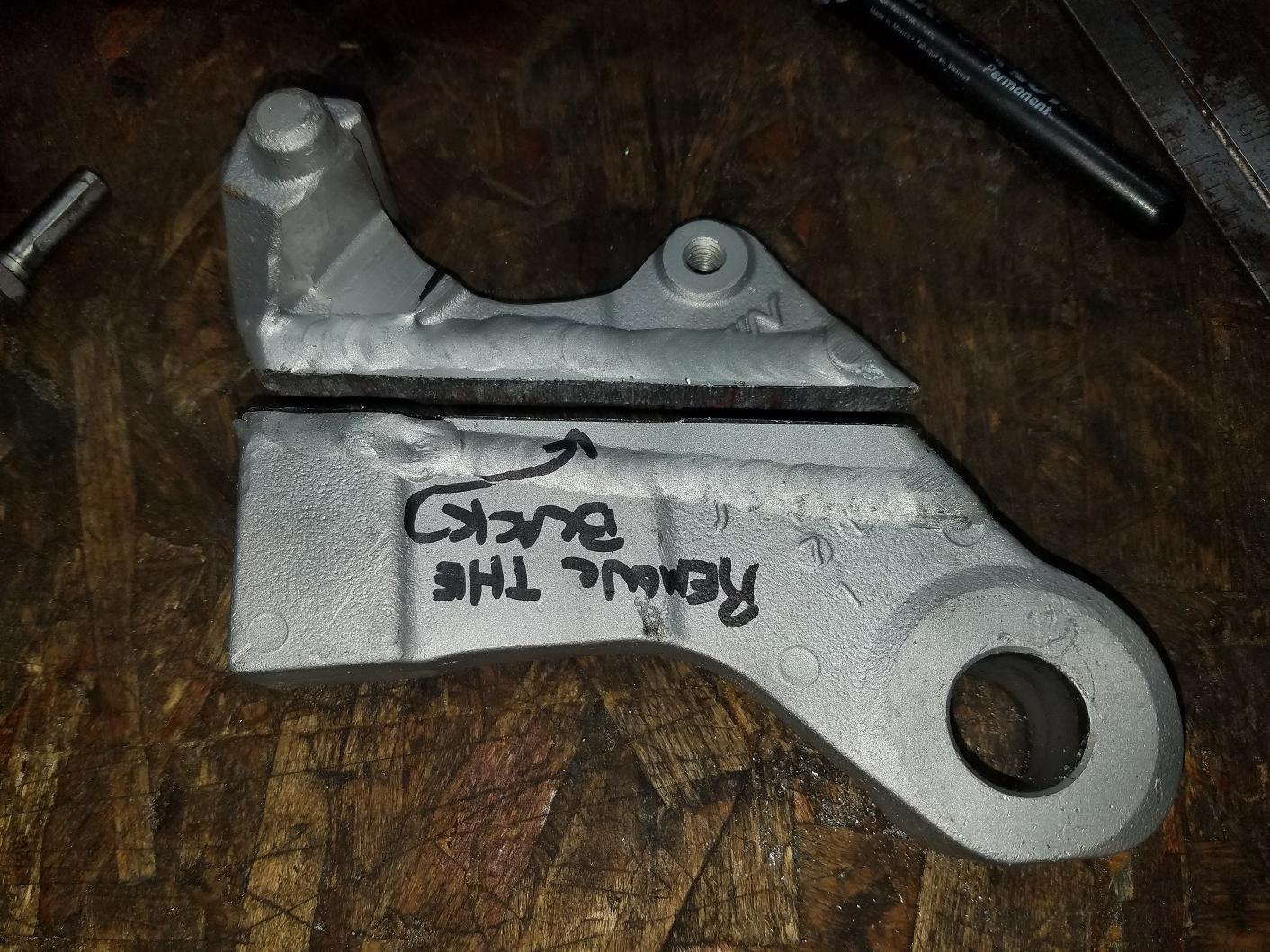

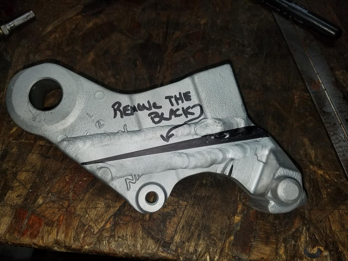

Ok... I just wasn't happy with the way the pads lined up on the rotor.
Sure, I could have tested it just to see where we were at on it but I couldn't justify it.
So, I removed a wedge to give it better alignment.
Ok Ok... It's a prototype......
But this might end up on someone else bike so I might as well make it a bit better..
KXGURU.COM KX500 REAR BRAKE UPGRADE CBR600 1994 116.JPG (292.8 KiB) Viewed 14253 times

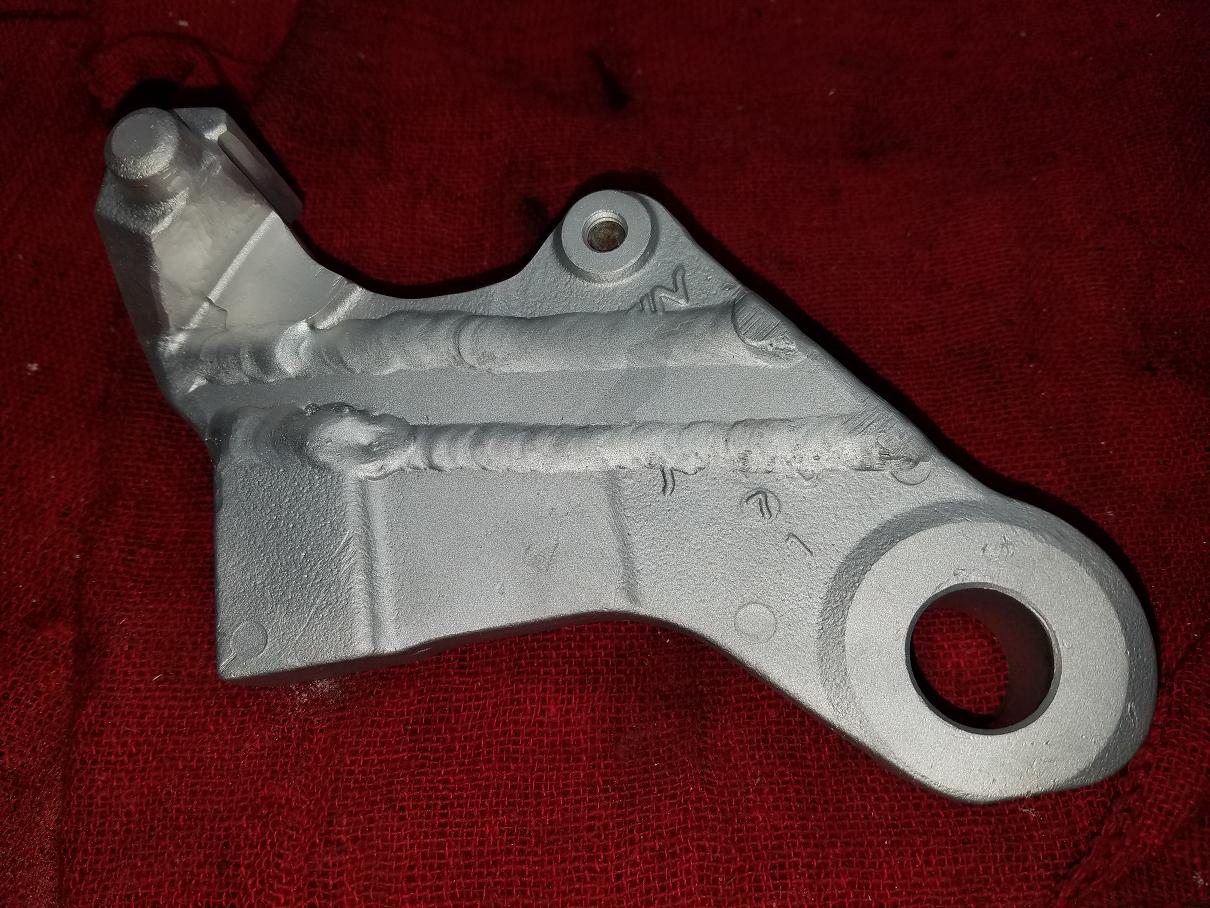

On the original attempt I didn't allow for the angle of the mount vs the radius of the rotor.
But this should fix it up nicely.
KXGURU.COM KX500 REAR BRAKE UPGRADE CBR600 1994 117.JPG (290.58 KiB) Viewed 14253 times
I didn't get a pic of it but I did mount it up on the bike and it looks much better.
So off it goes to Travis for some lick n stick action :lol:

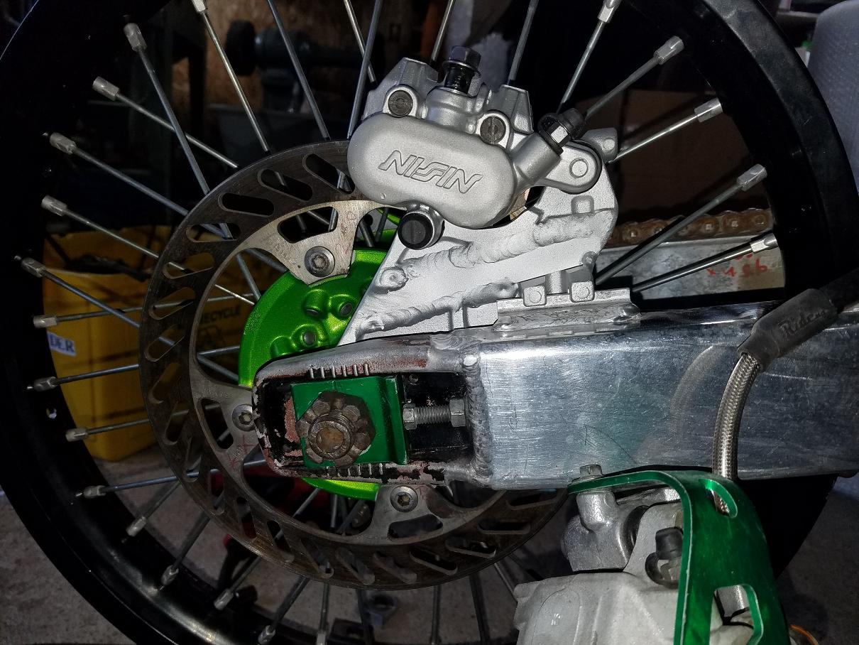

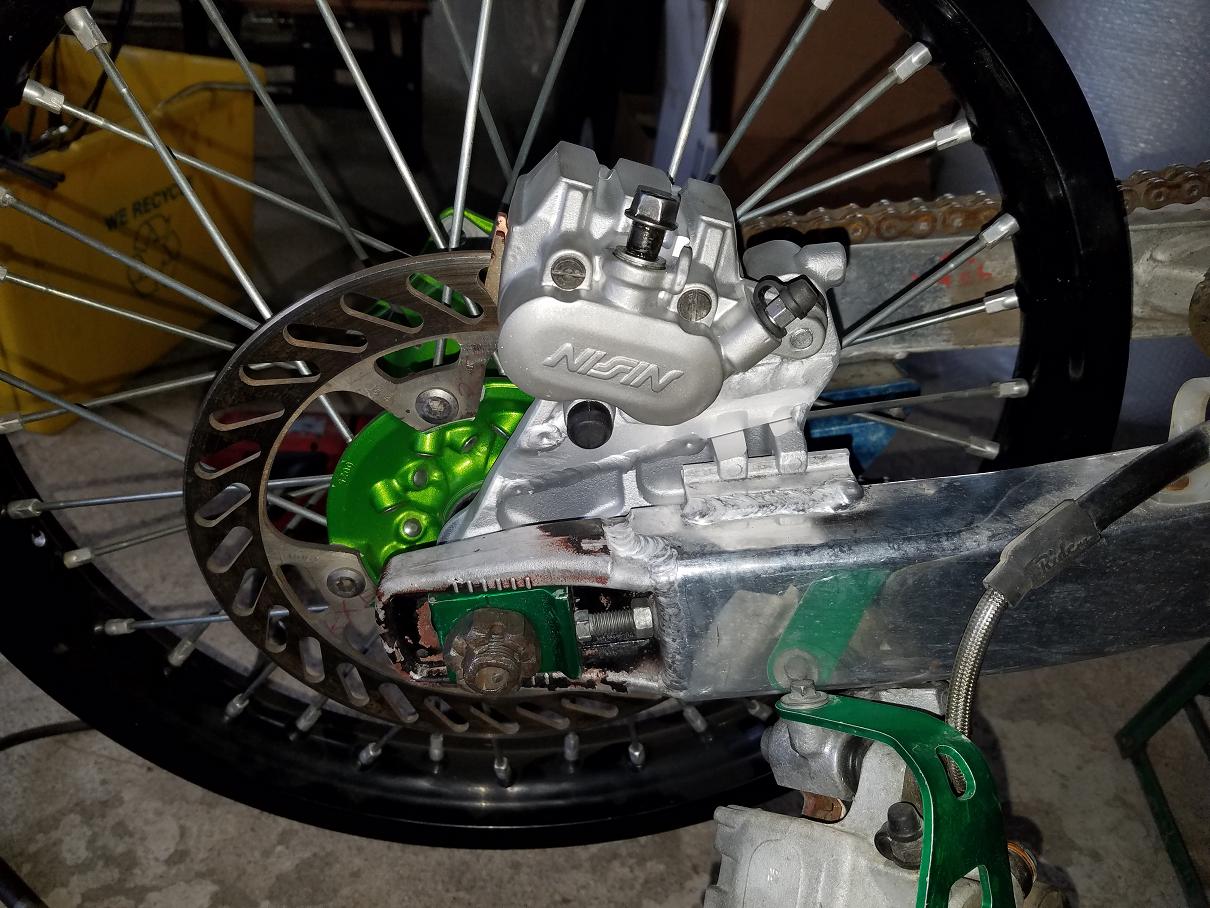

Ok.. all welded up and ready for another try.
I bled the brake and was all excited... pumped the brake lever... nothing... Pump Pump Pump... Still nothing :cry:
Then I notice a puddle of brake fluid on the floor.... Busted SS brake hose.... :lol:
So here is what we ended up with so far.
KX450F rear wheel
KX450F to KX500 rear axle adapters from Warp 9.
A used 94 CRB600 f2 Right front brake caliper.
KX500 01 rear brake caliper mount.
KX500 93 rear brake hose.
Nothing has been rebuilt.
All I did was disassemble the caliper, clean it, and reassemble it.
Modded the mount to make correct clearance and removed some unnecessary material, then bled and adjusted it.
That's it.
To do this right I should completely rebuild the master cylinder, the caliper, installed new pads (I used the pads that came on the used caliper), installed a new SS brake line, and installed a new rotor.
However, even with all this old used junk the performance is remarkably better..
But how much of the increased braking is from the larger rotor diameter and how much is from the dual piston caliper?
We will have to test it and find out...

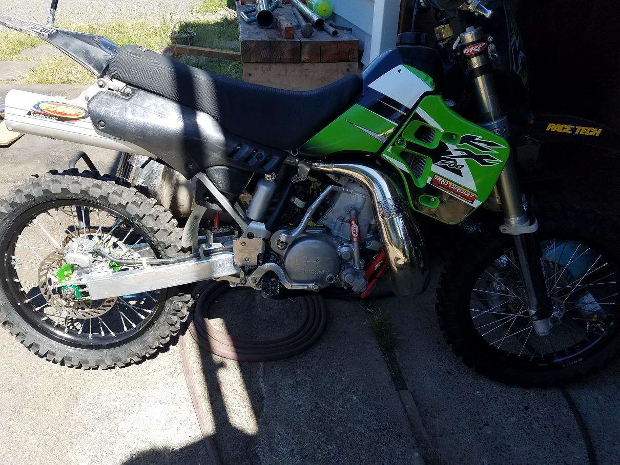

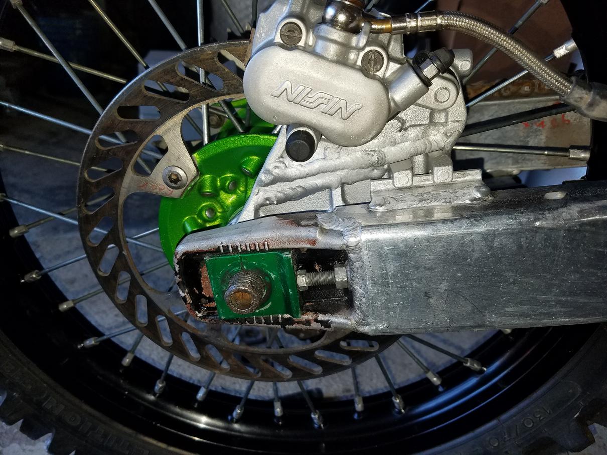

I believe this is the final version for the CBR600 caliper..
KXGURU.COM KX500 REAR BRAKE UPGRADE CBR600 1994 118.JPG (242.33 KiB) Viewed 14240 times
This is as the bike was tested..
KXGURU.COM KX500 REAR BRAKE UPGRADE CBR600 1994 119.JPG (211.84 KiB) Viewed 14240 times
