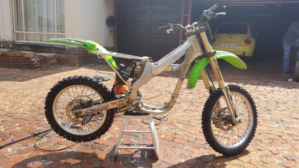

I also got around to cleaning up my 250F

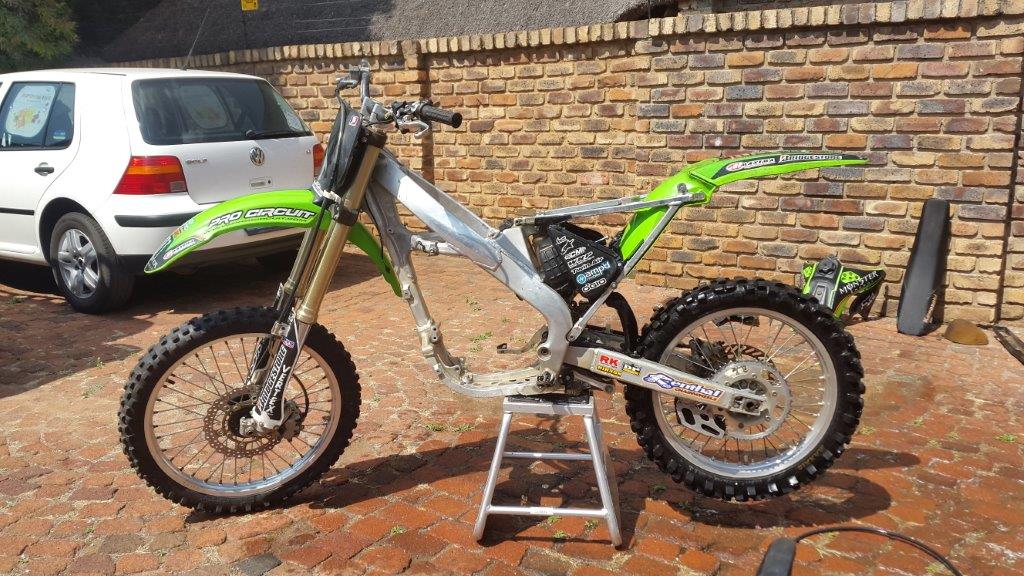

Got the motor in this weekend.
Drilled the hole for the swingarm pivot bolt bigger and ground the collars very lightly to make the motor fit.
Then I cut the frame in front for the exhaust to fit.
