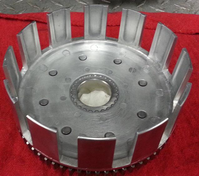

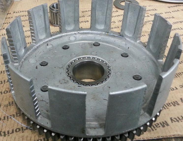

Clutch basket repair...
Before
91 KX500 CLUTCH BASKET REPAIR OEM-CYCLE.COM 120.JPG (72.41 KiB) Viewed 10791 times
After
91 KX500 CLUTCH BASKET REPAIR OEM-CYCLE.COM 121.JPG (51.36 KiB) Viewed 10791 times
Jason is a master with a hand file and Scotch Brite :D

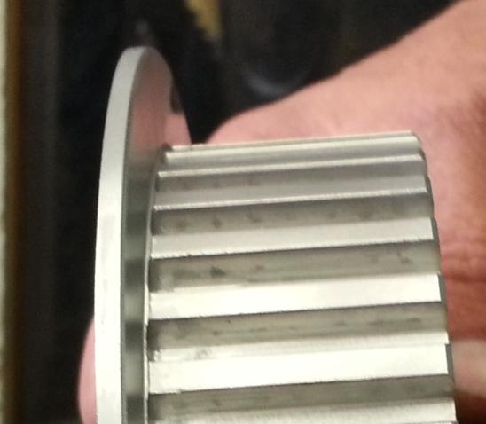

Clutch hub before
91 KX500 CLUTCH HUB REPAIR OEM-CYCLE.COM 125.JPG (40.56 KiB) Viewed 10789 times
After
91 KX500 CLUTCH HUB REPAIR OEM-CYCLE.COM 126.JPG (23.34 KiB) Viewed 10789 times
Not perfect but a whole lot better then before.

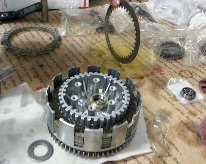

Getting the clutch plates pre oiled..
