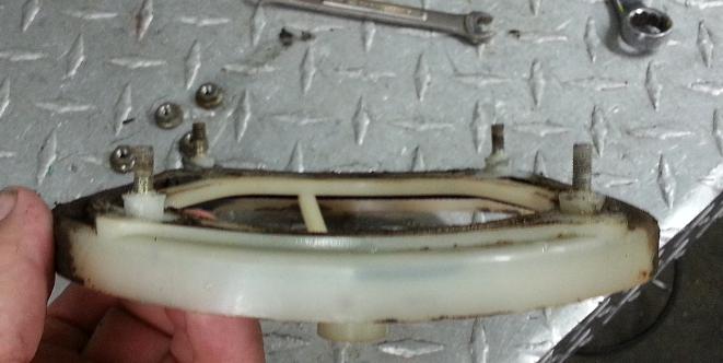

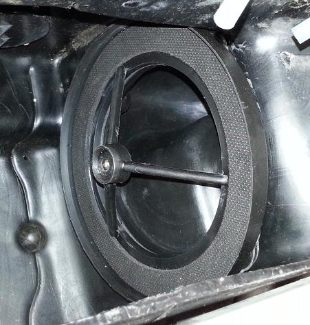

I was cleaning my air box out and noticed that I had dirt inside the rubber boot that goes to the carb :o :o :o :o :o
Needless to say I was freaking out....
I checked the filter and it didn't seem to be coming though any part of it including the center bolt.
So I pulled the box apart and discovered the problem.
KX500 AIR BOX PROBLEM 1.JPG (29.29 KiB) Viewed 15514 times
KX500 AIR BOX PROBLEM 2.JPG (52.68 KiB) Viewed 15514 times
I almost cried when I saw the dirt...

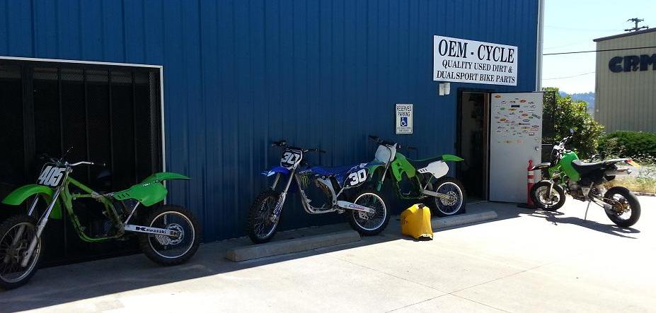

The solution was a cage asy from a 99 kdx200 and some Permatex Ultra Black RTV Silicone.
Same size and configuration as the kx500
KX500 AIR BOX PROBLEM 3.JPG (44.92 KiB) Viewed 15514 times
Clean it all good...

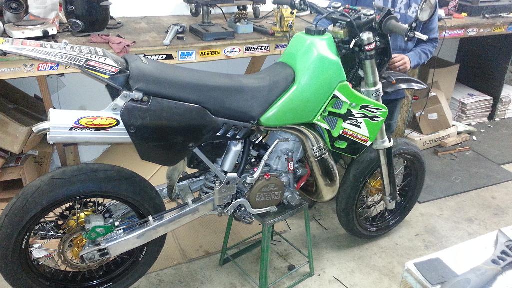

Ready to go...
In transition
7-18-14 SUPERMOTO KX500 2001.jpg (88.26 KiB) Viewed 15513 times
