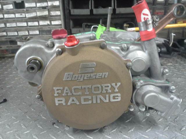

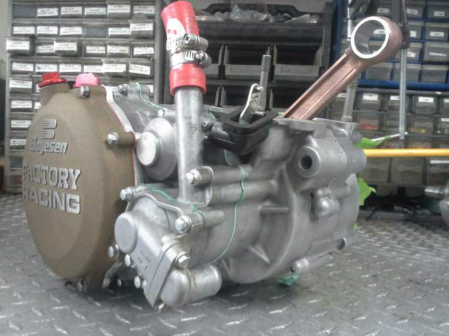

I know I know.... I just got this thing together and running....
But I just can't resist...
So...... Out with the old...
KX500 ENGINE SWAP 1.JPG (68.33 KiB) Viewed 10589 times
KX500 ENGINE SWAP 2.JPG (140.65 KiB) Viewed 10589 times

But for now I'm finishing the bottom end...
What we have is all the oil passages have been cleaned up, all mating surfaces have been lapped with Timesaver, bearings, seals, gaskets, shift forks, shift drum, and every snap ring, has been replaced.
The crank has been welded, trued, and balanced and rebuilt, using a IMS Pro rod.
Windowed Wossner piston, stock bore, fresh plate.
Transfers, bridges, and exhaust port, has been cleaned up.
Water ports have been cleaned up and the impeller clearance mod is done.
2 angle squish band with decompression on the head.
The rest is just glitter...
So, it should be just a nice, smooth, stock motor with some cleanup.
How will it run?
I should find out very soon.
