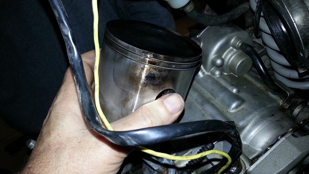

I next pulled the pipe off and looking into the cylinder... Sure it was locked up but I couldn't see why?
So i pulled the cylinder off and now the lever works fine... WHAT????
5-19-14 kx500 top end rebuild 1.jpg (222.65 KiB) Viewed 9850 times
Nothing unusual here... Although it might be running a bit lean..

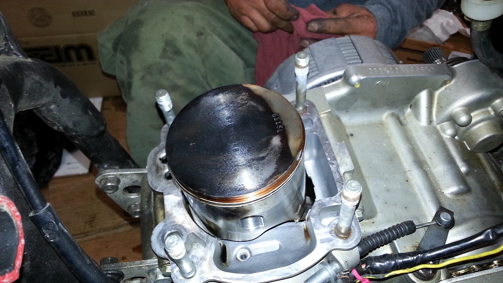

5-19-14 kx500 top end rebuild 2.jpg (185.49 KiB) Viewed 9850 times
Over all, I'm happy with how everything looks so where is the problem?

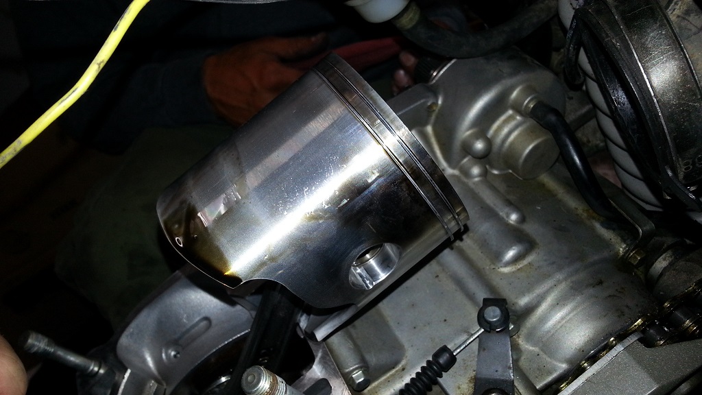

5-19-14 kx500 top end rebuild 3.jpg (206.15 KiB) Viewed 9850 times
Again, nothing out of the ordinary..

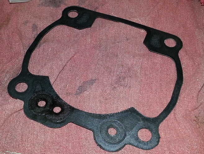

5-19-14 kx500 top end rebuild 5.jpg (178.7 KiB) Viewed 9850 times
Again, a little lean but no biggie..

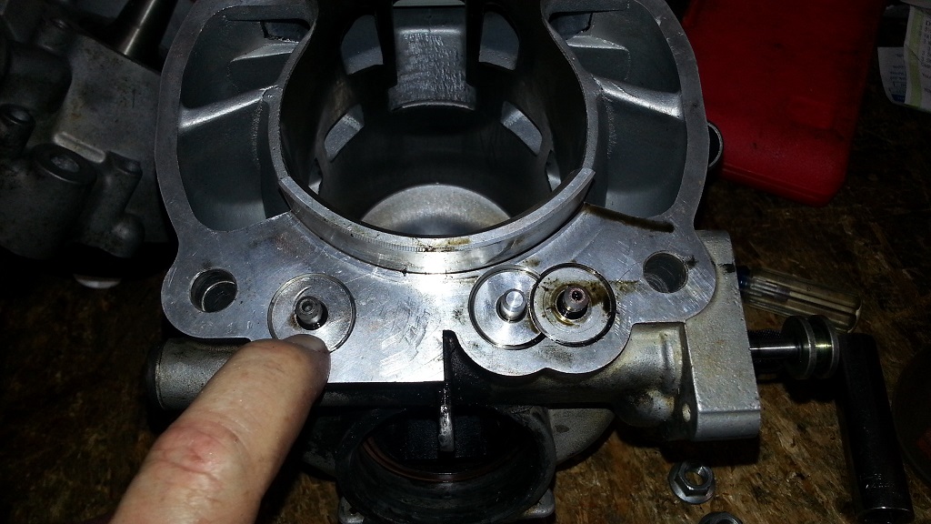

Then, I found the problem...
When I put a little pressure on this valve guide, the KIPPS stop moving.
5-19-14 kx500 top end rebuild 9.jpg (200.97 KiB) Viewed 9850 times
I put a straight edge over the other valve guides and this is the only one sticking up about .002" above the surface of the cylinder base.
So, I grabbed a cylinder I've had sitting on the shelf for a while, put it on the engine and it works perfectly.

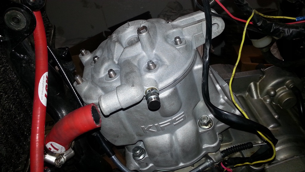

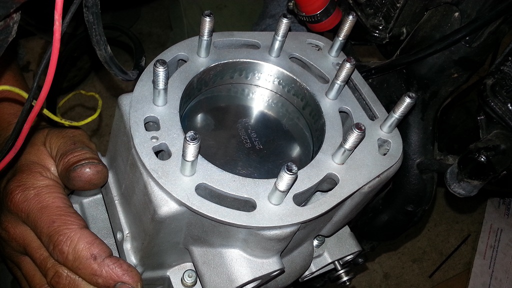

With my thoughts verified I decided to install the new cylinder, a new Wossner windowed piston, a new Larry modded head with compression release, and re-jet my carb.
Oh yeah, and install my 2 piece clutch cover...
5-19-14 kx500 top end rebuild 9-1.jpg (211.28 KiB) Viewed 9850 times
New studs, check.
Ring end gap .018", Check
Circlip opening up, check
Writing on rings up, check
2 stroke non synthetic break in oit, check
Head gasket with the small holes to the right, check

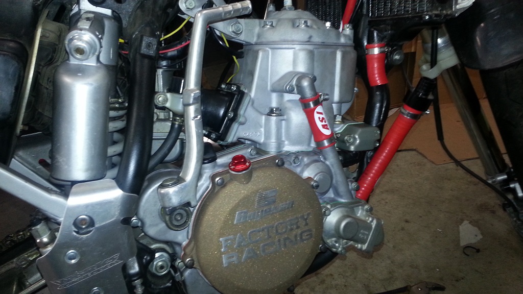

Posted: Tue May 20, 2014 2:26 am

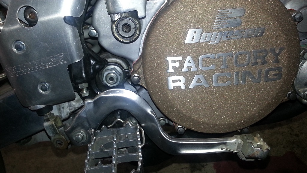

KIPPS move smoothly once the inner clutch cover is installed, Check

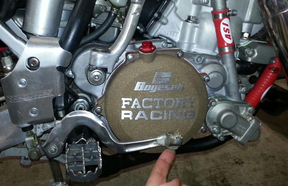

I was asked at another site if you were to raise the rear brake lever as high as it would go is there still clearance..
The answer is yes.
I was also asked if I have someone making some of these.
The adapter rings yes.
The welding, drilling and tapping, no.
What I did was adjust the rear brake set screw as far up as it would go, then I pushed up on the rear brake lever as far as it would go.

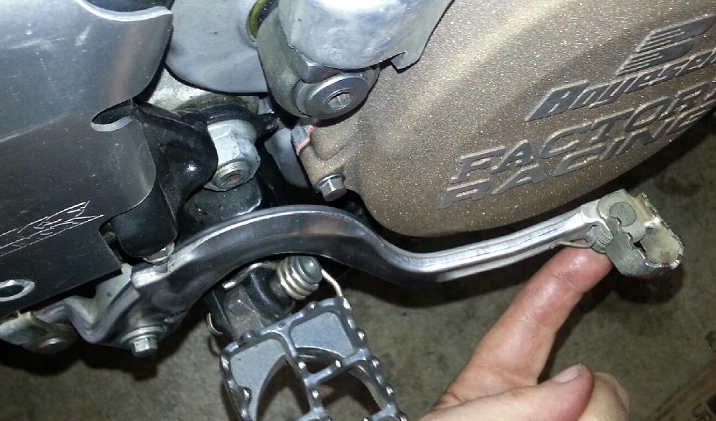

Here is a pic of a KX450F Hammerhead shift lever installed on my KX500.
If you wear a bigger boot size you can order them in different lengths.
This one is 20mm longer then stock.
