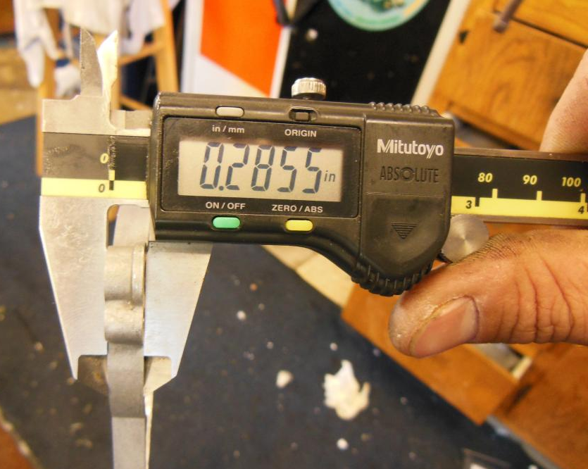

KX500 water pump modification
motorrads impeller mods 9-2.png (412.29 KiB) Viewed 29020 times
motorrads impeller mods 9-3.png (643.99 KiB) Viewed 29020 times

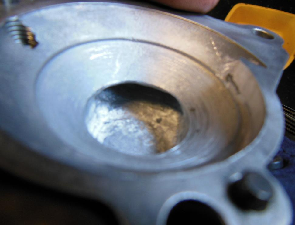

Ported impeller cover, and elbow
motorrads impeller mods 9-4.png (699.69 KiB) Viewed 29020 times
