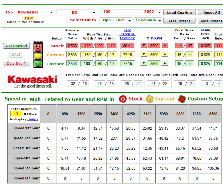

Playing with Gearing Commander today.
With my current set up at WOT in 4th gear I hit 81mph, not hunched over, by satellite.
10-11-13 GEARING COMMANDER.png (59.44 KiB) Viewed 11515 times
I think that is about right for a basically stock engine..
