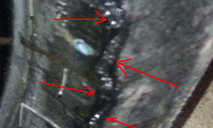

When I got back to the shop I took a look at the tire and found black greasy stuff on the edge of the tire...
Guess what it was?
Oh yeah, remember that new chain I put on?
It had a heavy amount of lube on it.
I didn't bother wiping it off.
Since the tire rubs just a wee bit on the chain it got covered in chain lube.
CHAIN LUBE ON TIRE.JPG (42.07 KiB) Viewed 10839 times
You can bet that I will finish my spacer and get it installed and keep the chain lube off my tire :shock:

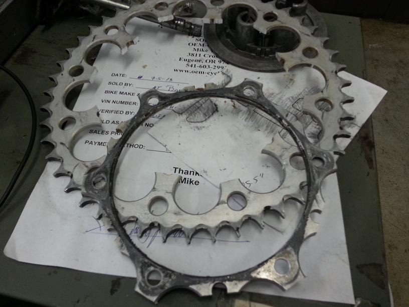

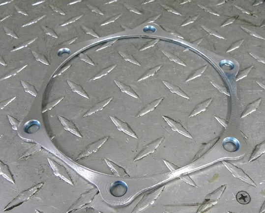

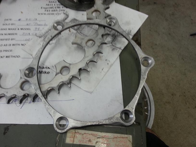

Here is the spacer I made for the rear wheel....
The finish thickness is .120"
