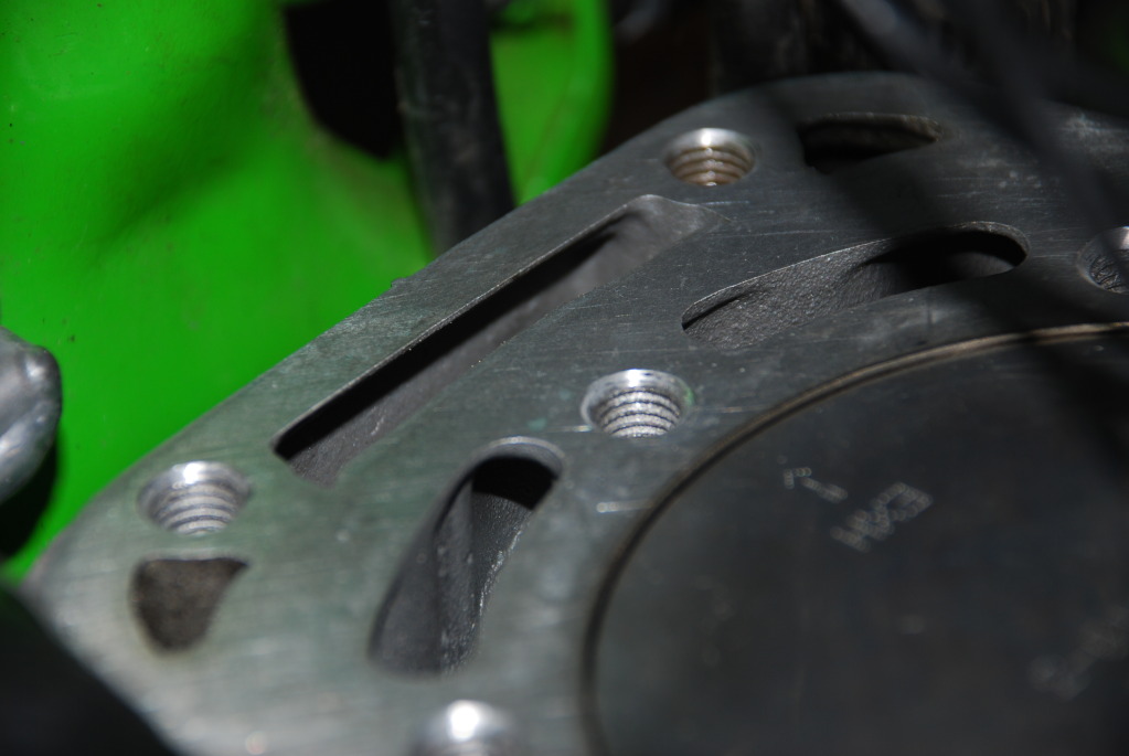

Marco810
Holly crow, those exhaust ports are huge!. Looking good

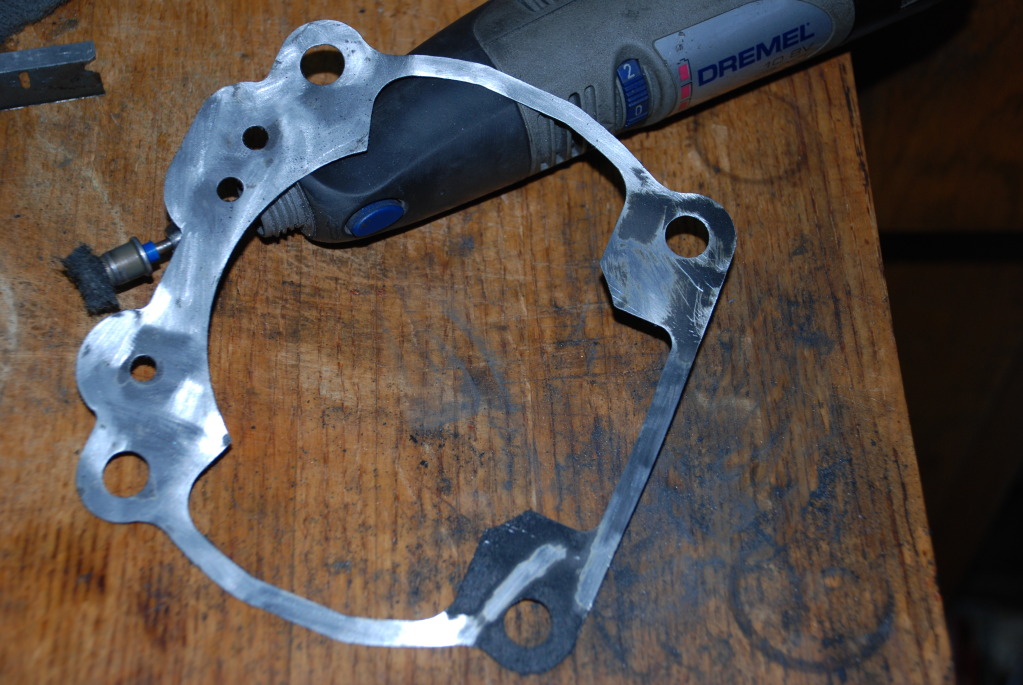

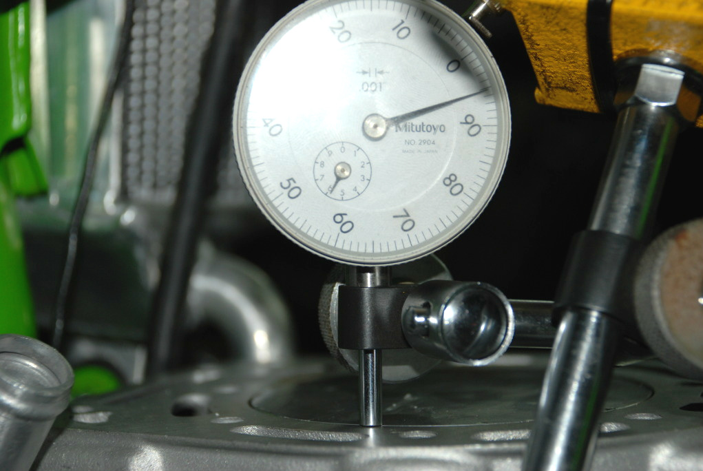

Posted: Sun Sep 14, 2014 3:35 pm

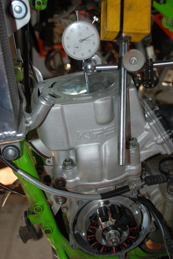

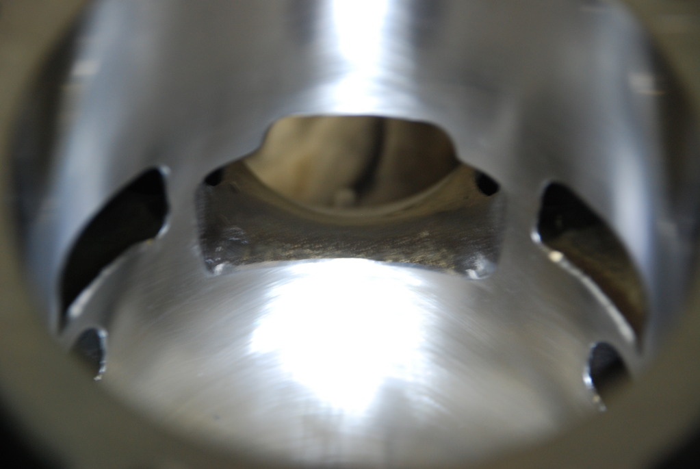

After sticking the Mitatoyo guage on the deck.. and a degree wheel on the PORTS... Decided I needed a bit more UP on the jug.. but stock .020 gasket was too much...
Soooo.. I took all the gasket material off one side of the gasket.. (it is going up against another rubberized gasket, so no problem with seal). and whala... exactly where I needed..
Motorrads Jeff Wards Engine build round 2 9-99999999-5.jpg (208.1 KiB) Viewed 7725 times
Motorrads Jeff Wards Engine build round 2 9-99999999-6.jpg (196.43 KiB) Viewed 7725 times
Deck hight after Gasket fix.. Positive .005"

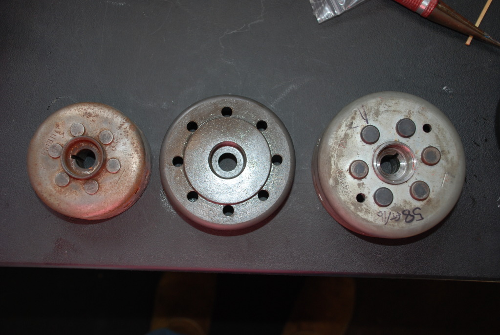

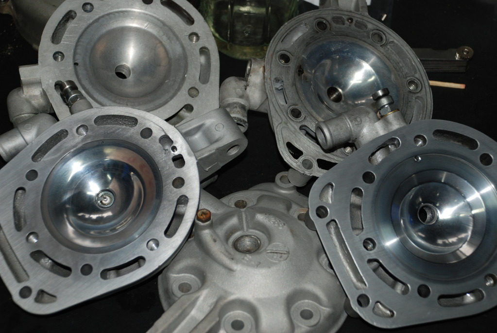

Left to right.
1987, Light MZB, 88-04
Motorrads Jeff Wards Engine build round 2 9-99999999-8.jpg (174.3 KiB) Viewed 7725 times
Motorrads Jeff Wards Engine build round 2 9-99999999-9.jpg (194.78 KiB) Viewed 7725 times
Motorrads Jeff Wards Engine build round 2 9-999999999-1.jpg (175.78 KiB) Viewed 7725 times
Motorrads Jeff Wards Engine build round 2 9-999999999-2.jpg (173 KiB) Viewed 7725 times
Motorrads Jeff Wards Engine build round 2 9-999999999-3.jpg (207.04 KiB) Viewed 7725 times

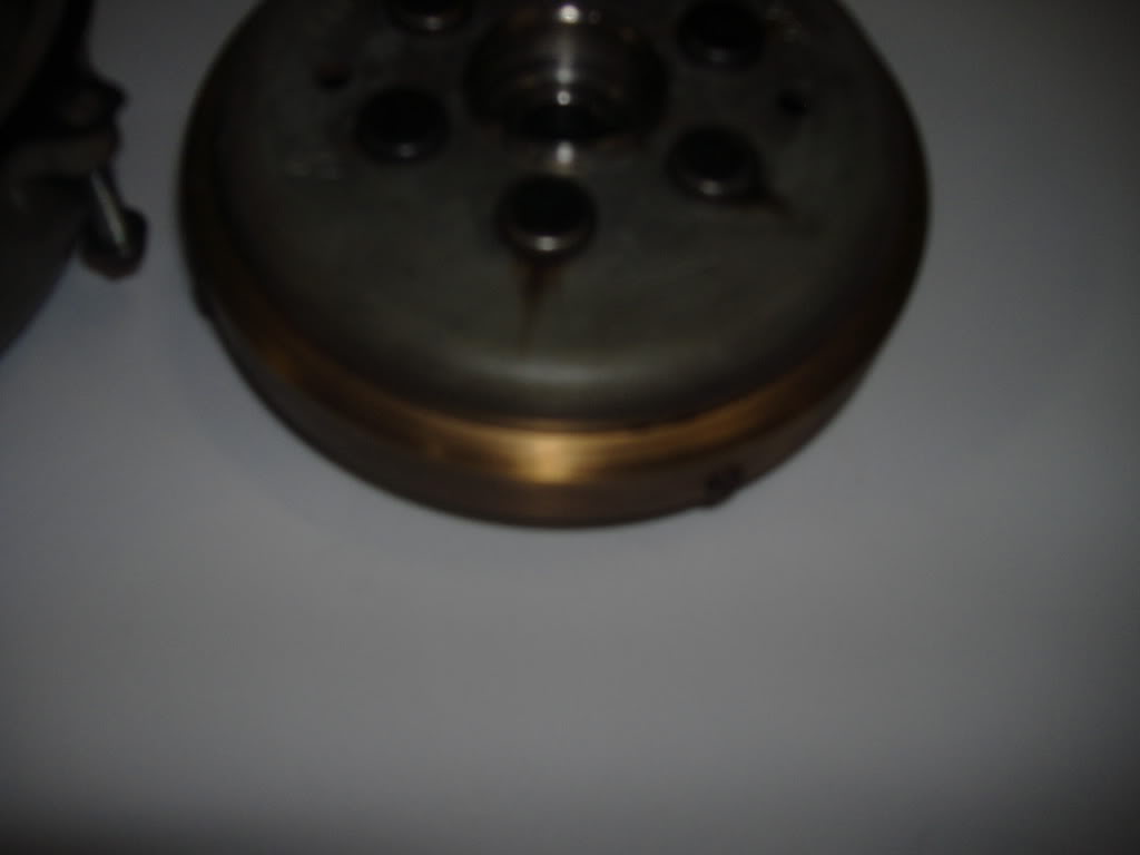

Posted: Sun Sep 14, 2014 3:46 pm
jgturbo
Are you planning on lightening the flywheel?
Motorrad
Going to run the 26oz MZB one... so roughly 1LB less than stock...
jgturbo
What's your reasoning behind a lightened flywheel? I've got an opinion on the subject, but I'd like to hear yours first
Motorrad
Simple.. It's Easyer to add weight that remove it...
That being said.. I like the light one for when I'm on the supermoto track.. Or the street. (remember my bike is plated)... As it comes out of a corner like you shot it out of a cannon evil
In dirt.. I have enough (ward) flywheel weighs cut to add 2.5 lbs to my setup... Half a lb at a time... (when I trail ride it durring summer, I LOAD HER UP)
Weight on my old flywheel New ones are still at work

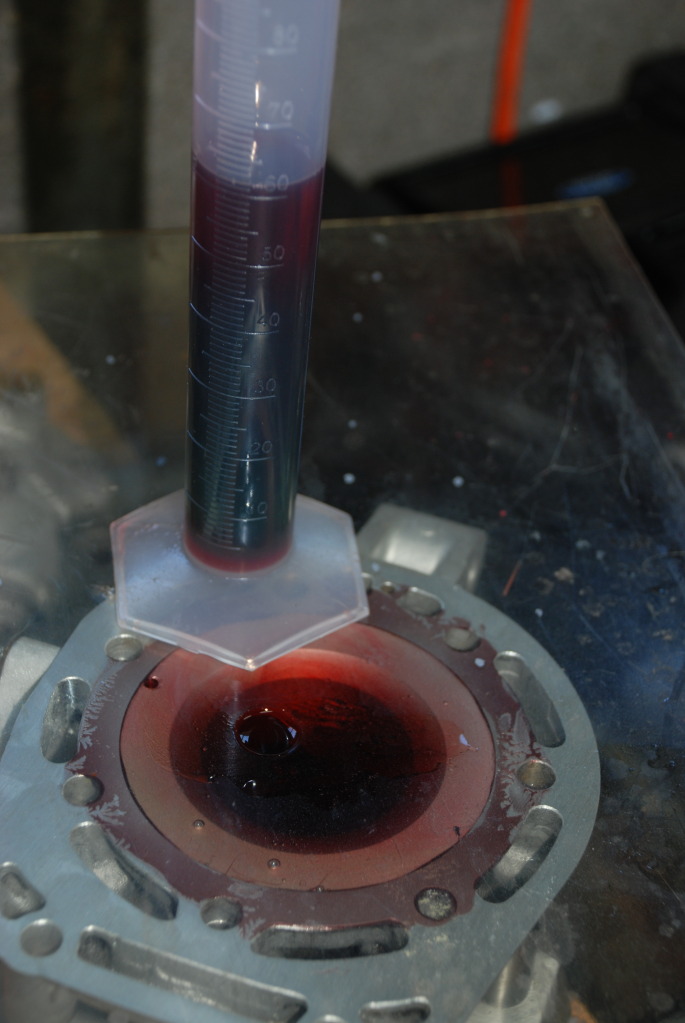

Posted: Sun Sep 14, 2014 3:49 pm
14.5 : 1 uncorrected compression
Motorrads Jeff Wards Engine build round 2 9-999999999-6.jpg (124.39 KiB) Viewed 7725 times
Motorrads Jeff Wards Engine build round 2 9-999999999-7.jpg (178.28 KiB) Viewed 7725 times

Posted: Sun Sep 14, 2014 3:52 pm
jgturbo
Don't these bikes come stock with an 8.5:1 ish compression ratio? Are you really adding 6 more points, or are we talking about different methods of CR measurement? I know four strokes inside and out but I'm rather new to the world of two stroke engine theory.
Motorrad
The numbers in the "book" are corrected... Im quoting Uncorrected numbers...
also.. keep in mind. the K5 has a heavy rotating assembly to start with... compaired to anything modern.
Say BUH----BYE..

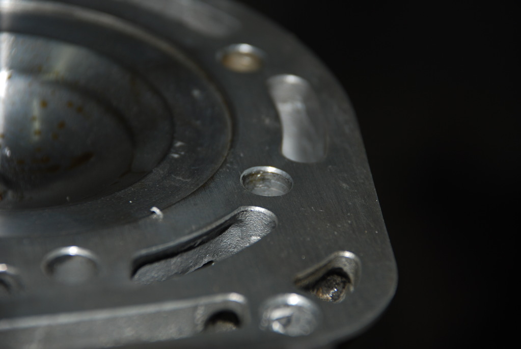

P.S. Can you find whats wrong with this picture... that I noticed the second I dropped the head on...
Motorrads Jeff Wards Engine build round 2 9-999999999-8.jpg (125.32 KiB) Viewed 7725 times

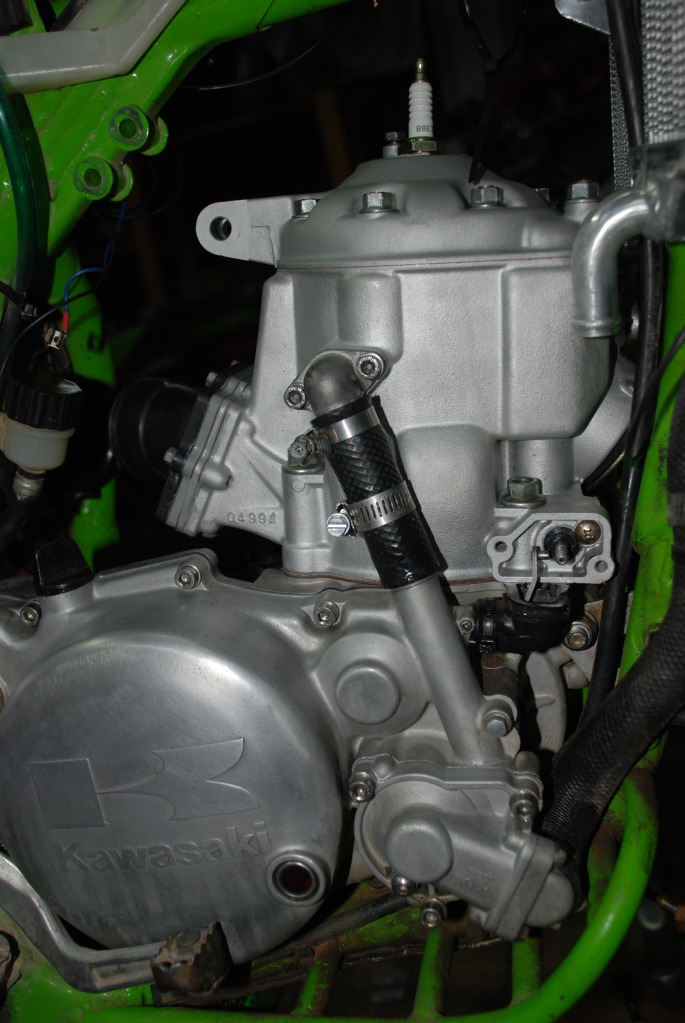

And... we again... Like I tell all the 4 poke guys ... have "a STOCK Kx500 motor"
Motorrads Jeff Wards Engine build round 2 9-999999999-9.jpg (169.04 KiB) Viewed 7725 times

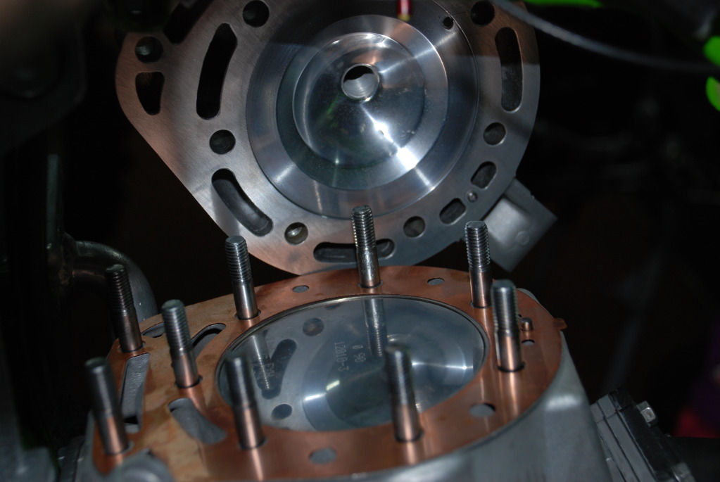

Motorrad
heat cycle #2... what I thought was left over coolant from bleeding head... wasnt.... wheeping coolant from head...
Head is off. On bench..
I already knew what the problem was before I took it off.... (somthing I was going to do before I put it together. but didnt)
confirmed it..
Walking out the door RIGHT NOW... to my grandmothers 89th Birthday party..
will post more later... and take pictures of how to fix it..
RoostDaddy
my guess would be to heat the copper head gasket first. Or throw it away and use a Cometic S/S
Larry Wiechman
Dowel pin bottomed out?
jgturbo
How are you sealing the copper head gasket? Got a stainless o-ring and matching groove for compression and some sort of goo (hylomar works wonders) for coolant?
Motorrad
Head studs pulled a bit of material...
I normally countersink them... But didn't this time... Being in a hurry bites ya..
