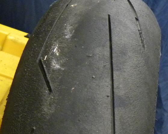

How about some Pirelli Diablo Supercorsa's.
Front 120/70 ZR17
Rear 160/60 ZR17
I know... The rear will rub...
I didn't want a 160 in the rear, I wanted a 150.
My tire guy said he couldn't get what I wanted in a 150... (Cheap but awesome, actually trade)
I measured it at 155mm.
I measured what is on my bike right now and it is very close.
I guess we'll see when I get it mounted.
Unfortunately it won't be till next week as too much is happening right now..
These were mounted on a bike that took a couple of laps.
Still tons of life left :-)

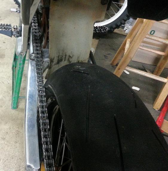

Started playing with the rear wheel fitment...
It's tight..... I'm going to switch to a non O-ring chain...

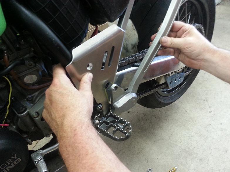

So I picked up a set of Works Connection Frame guards.
The right side was a breeze and took all of about 2 minutes to install.
The left side wouldn't be bad except that I am using the Pro Motion Side stand and of course the two interfere with one another.. :o

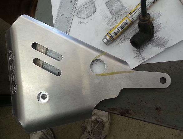

SIDE STAND AND FRAME GUARD INTERFERENCE.JPG (72.75 KiB) Viewed 11948 times
I'm thinking about cutting the frame guard around the side stand as I have indicated in yellow.
It will still bolt up and work just fine but I was hoping for a better solution...

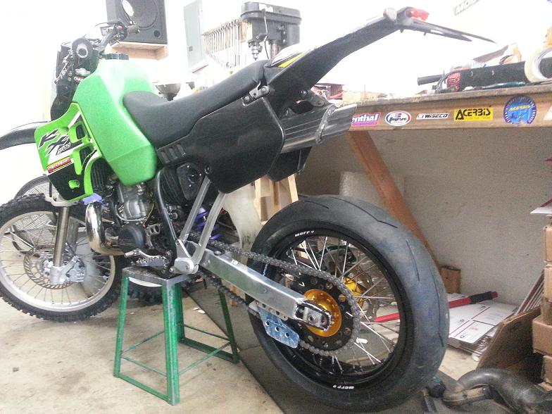

Simply Ridiculous 8-)
