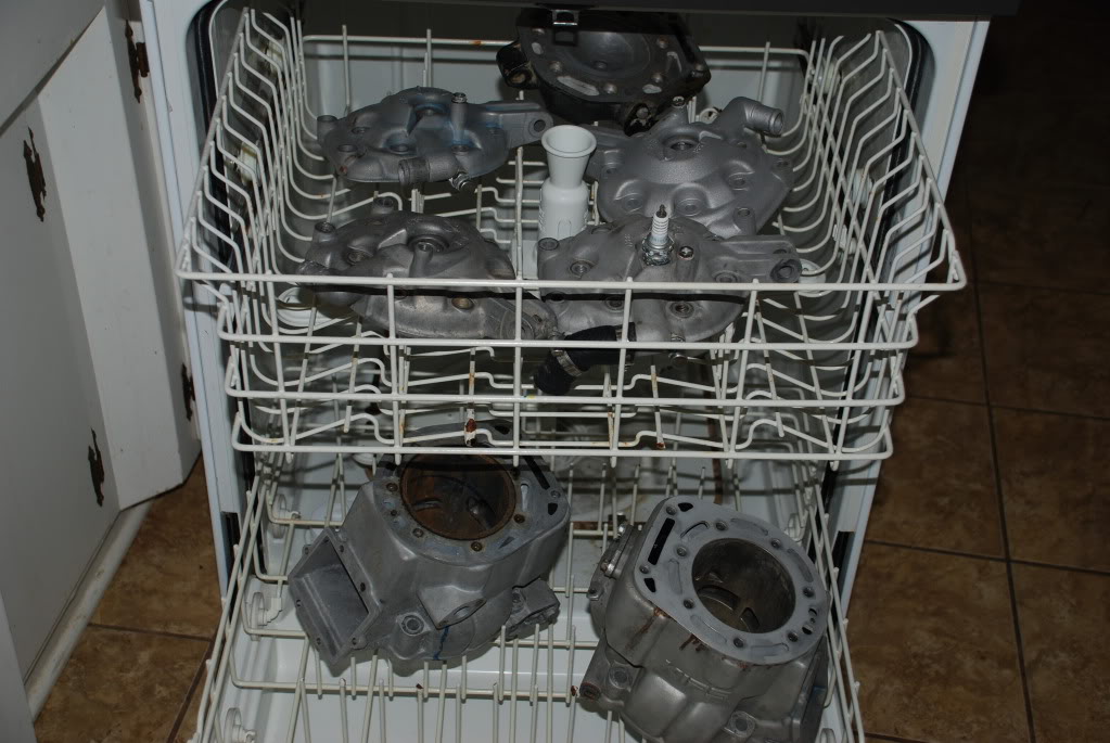

Oh... BTW... what does the inside of your wifes dishwasher look like?
Motorrads Jeff Wards Engine build round 2 9-9999999-1.jpg (123.73 KiB) Viewed 7580 times
Changing Jugs... and Pistons..
Found the 2nd machining flaw in my wiseco piston.... (yep 2 in one piston)... not happy.. that was causing my ring seal issues..
Going 88MM steel sleved jug (what I got).. (was going to go with 90mm, but ended up with a 88mm piston, so... gunna use it since its already here on the bench.)
Have some porting ideas I want to try with a sleve first before I dork up a good alum CLY...
Just pulled it off the mill.... Ran a Flycutter over the top.. to go with a ZERO deck hight...
all transfers etc are now ported etc how I want.. now I need to focus on the exauhst..
ALso going to put this 88mm piston on a Diet.. its a PORKER... weighing it at 446g (WITH A WINDOW CUT IN IT!!!)
after that it goes off to swaintech for pc9 skirt coat and Gold coat ceramic top coat....
Not exactly the route I wanted to go... as I was honing in on a good setup with the 86mm and other jug...
But Going this route I wont have hardly anything in it as its all here on the bench already... vs buying another piston, etc etc... so $$ was the determining factor in the decision...
