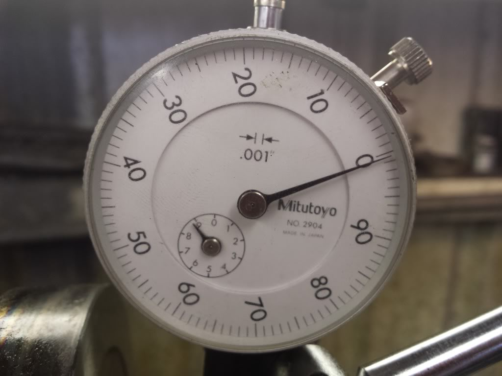

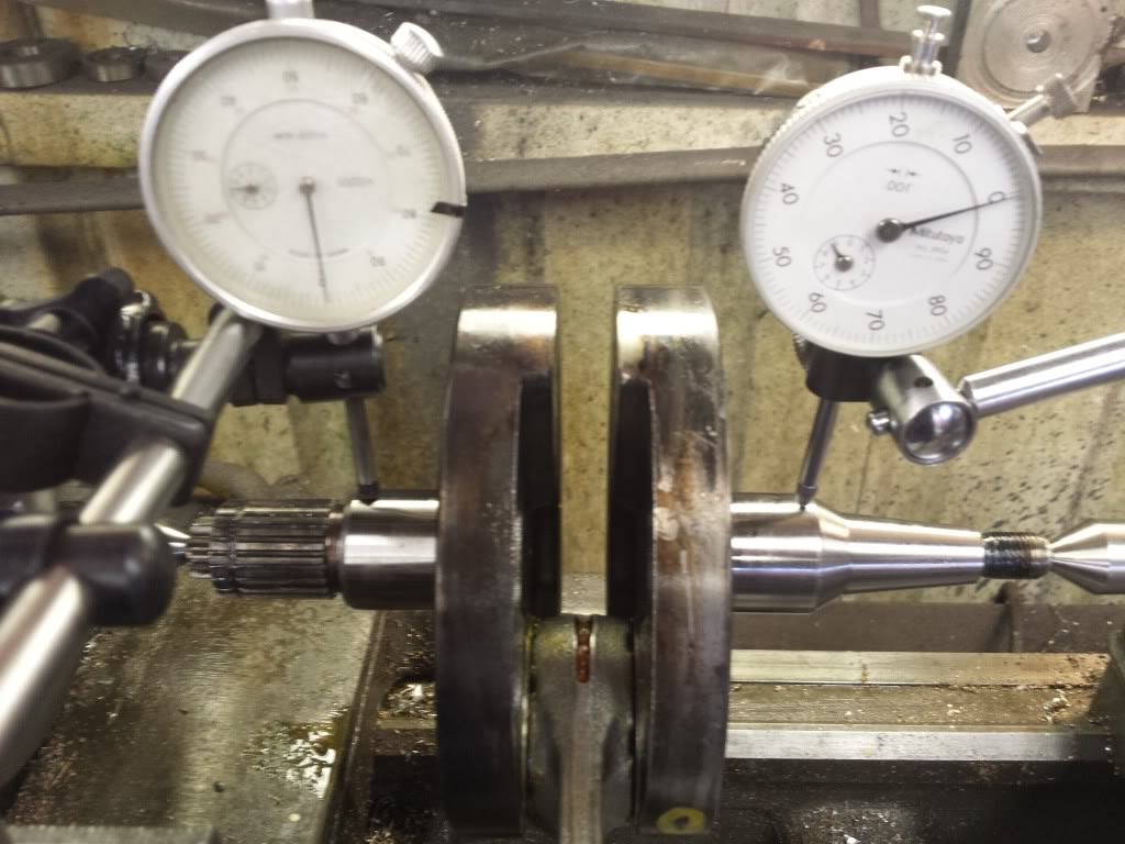

Motorrad:
KX500 JEFF WARD ROUND 3 REBUILD 1009.png (876.34 KiB) Viewed 9327 times
KX500 JEFF WARD ROUND 3 REBUILD 1010.png (523.03 KiB) Viewed 9327 times
Motorrad;
Huh. Figured I'd get some comment about something. Like how dirty my lathe is. Etc..
sandblaster:
Nope, didn't want to hurt your feelings.... but now that you mention it.... A happy lathe is a clean lathe.... Wish I had one... grin
Posted: Wed Oct 29, 2014 12:39 am
81cr450:
d**n so what your saying is only .0005 runout. I was way off
sandblaster:

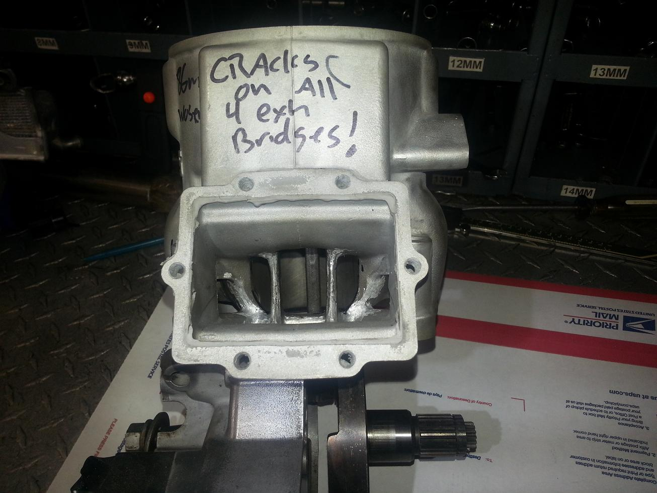

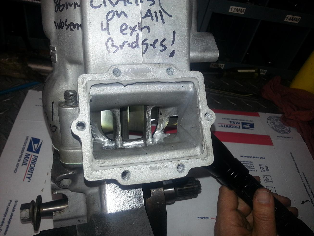

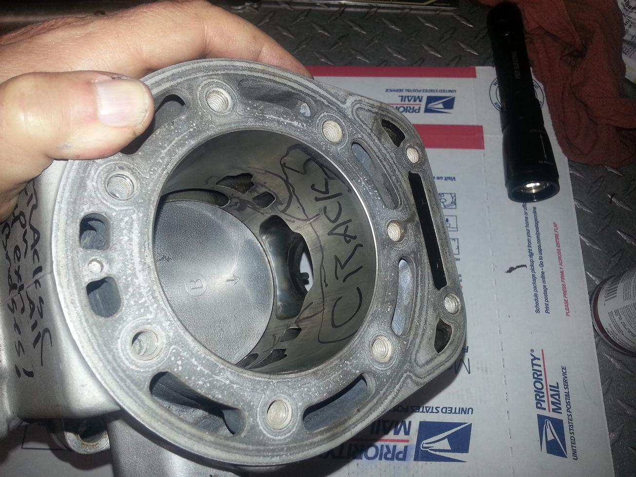

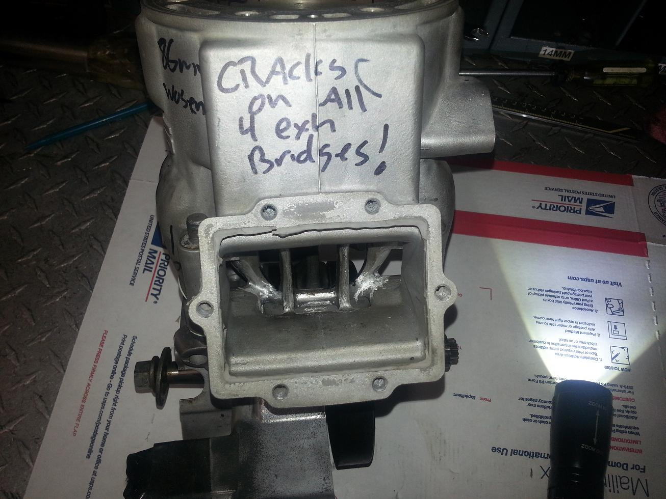

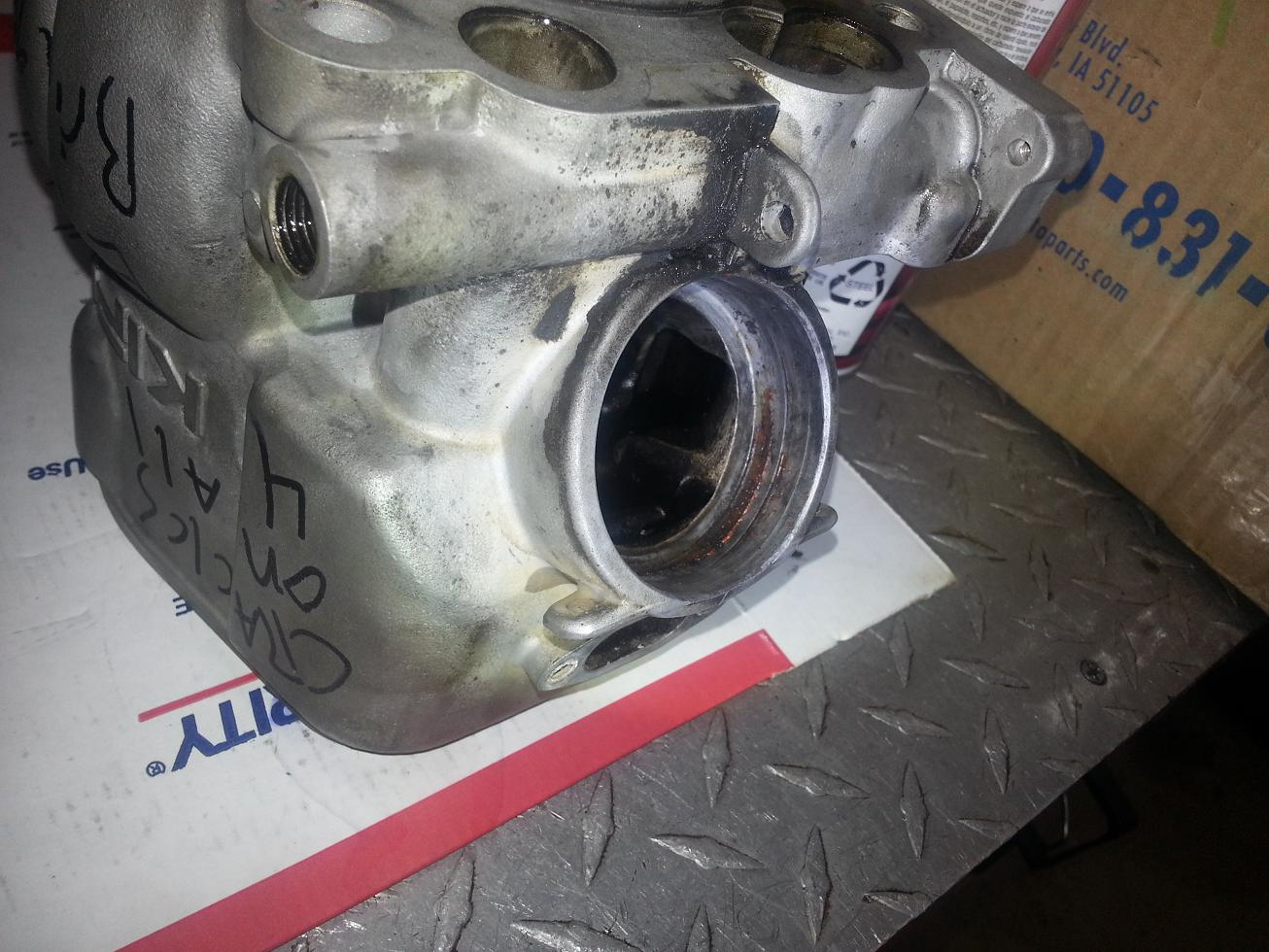

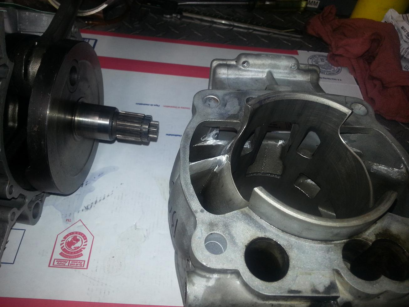

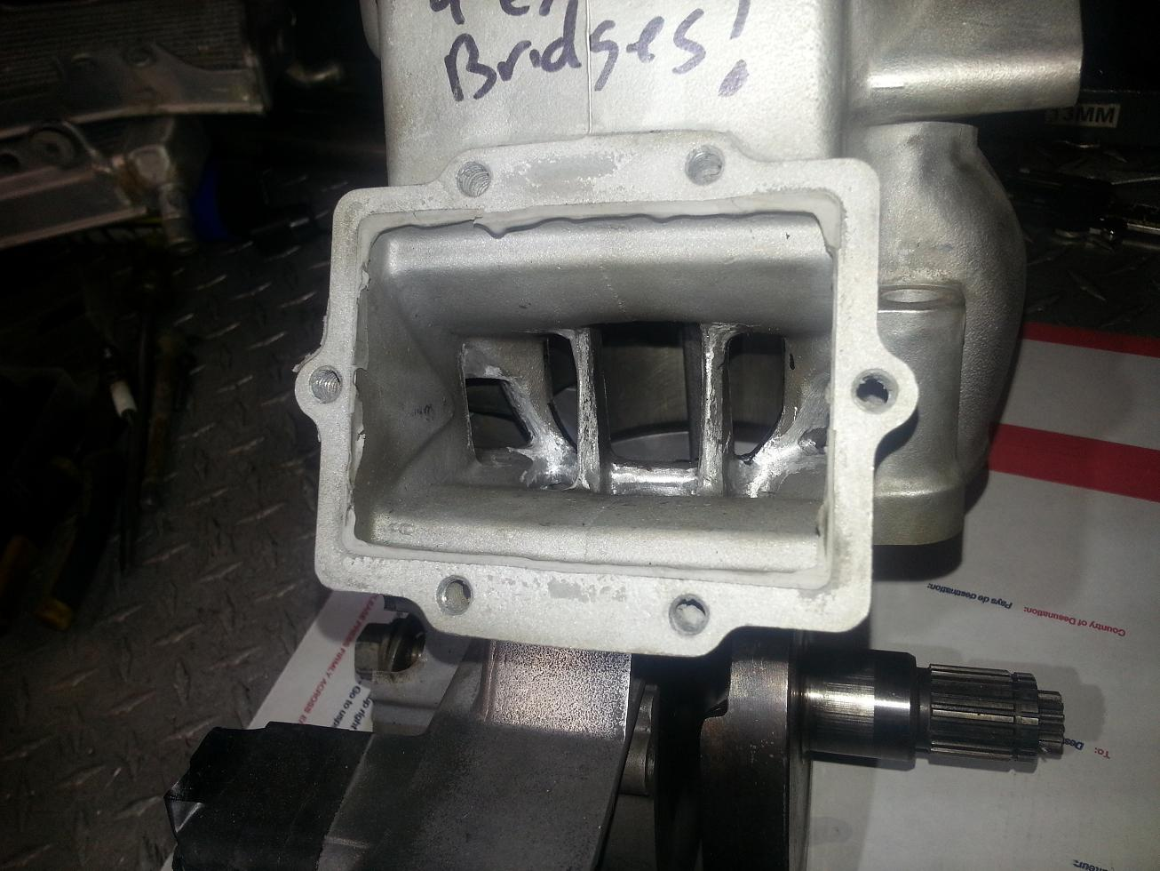

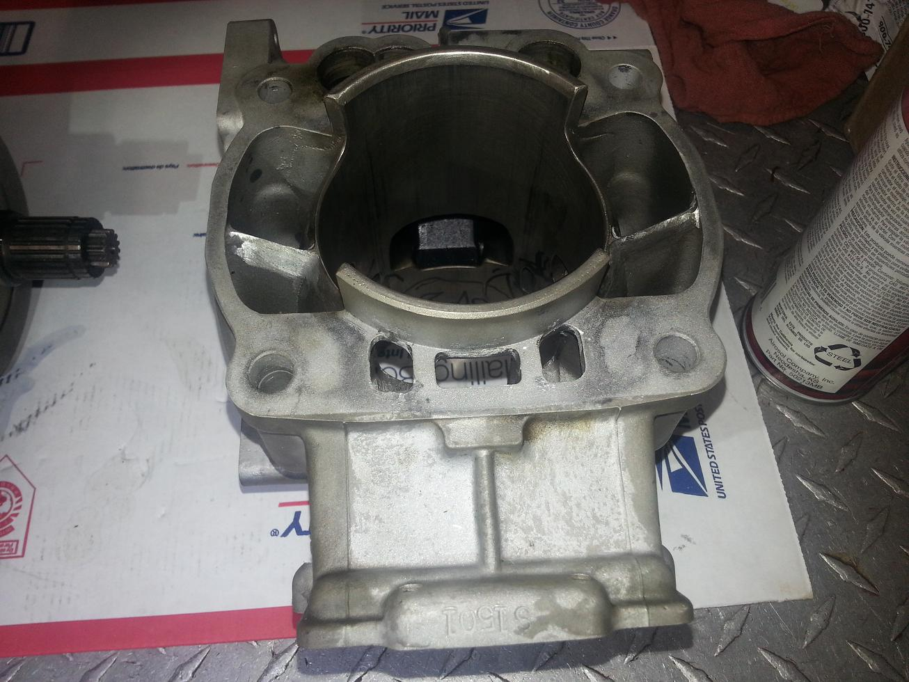

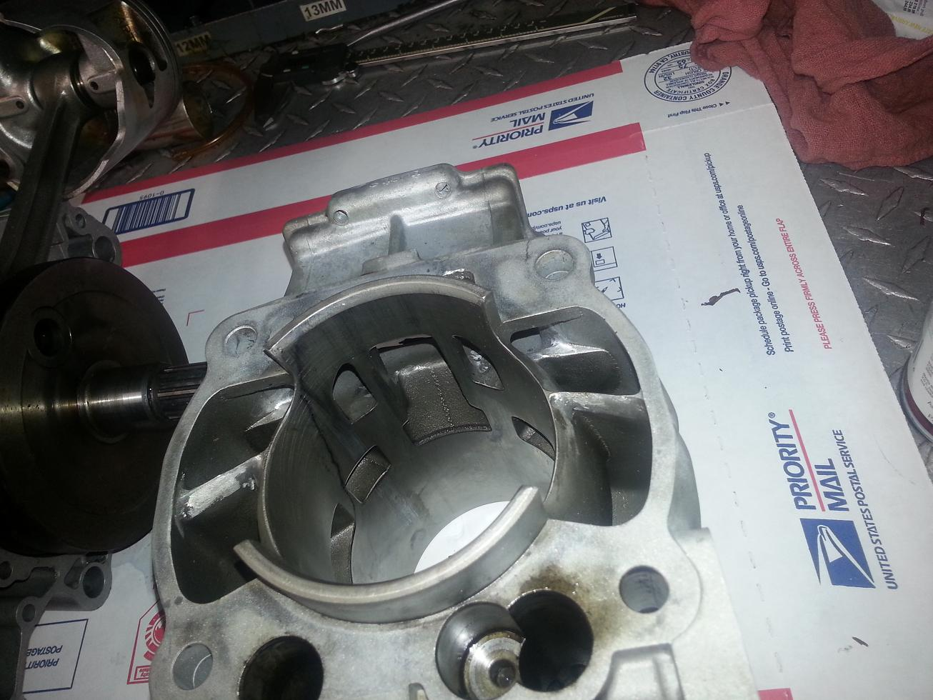

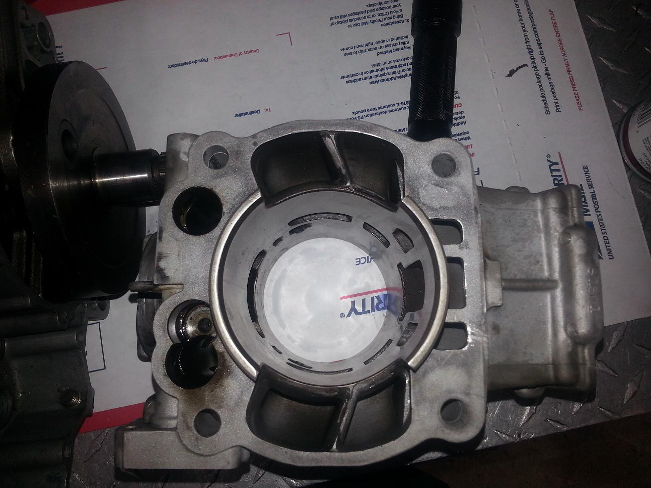

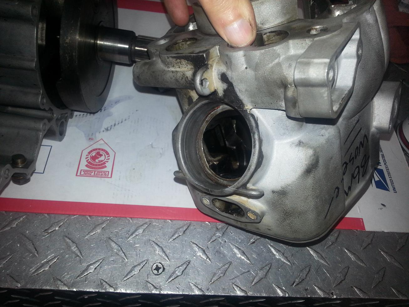

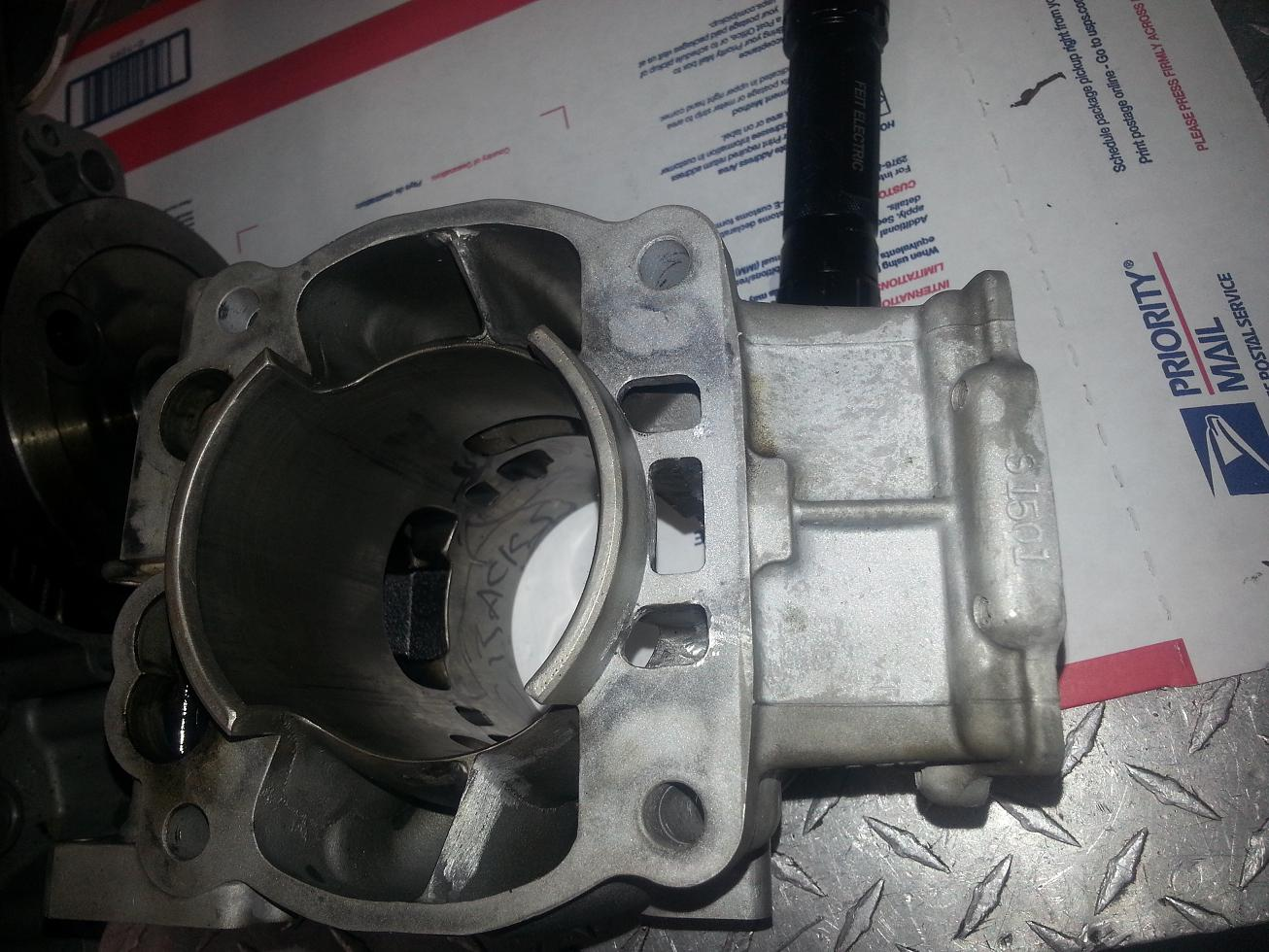

I received Motorrads jugs today.
I was real busy so I couldn't inspect the jugs until this afternoon.
When I finally had my hands on the jugs they were everything I expected and a whole lot more grin
Funny thing is previous pics I saw of the jugs was showing something I should have seen but I completely missed it....
Posted: Wed Oct 29, 2014 12:41 am
sandblaster:
I'll start with Oscars M cylinder first..
If you want to see larger pics go here:
posting.php?mode=edit&f=5&t=566&p=2186
KX500 JEFF WARD ROUND 3 REBUILD 1011.png (1.25 MiB) Viewed 9327 times
KX500 JEFF WARD ROUND 3 REBUILD 1012.png (1.27 MiB) Viewed 9327 times
Posted: Wed Oct 29, 2014 12:42 am
KX500 JEFF WARD ROUND 3 REBUILD 1013.png (1.37 MiB) Viewed 9327 times
KX500 JEFF WARD ROUND 3 REBUILD 1014.png (1.41 MiB) Viewed 9327 times
Posted: Wed Oct 29, 2014 12:43 am
KX500 JEFF WARD ROUND 3 REBUILD 1015.png (1.42 MiB) Viewed 9327 times
KX500 JEFF WARD ROUND 3 REBUILD 1016.png (1.31 MiB) Viewed 9327 times
Posted: Wed Oct 29, 2014 12:45 am
KX500 JEFF WARD ROUND 3 REBUILD 1017.png (1.4 MiB) Viewed 9327 times
KX500 JEFF WARD ROUND 3 REBUILD 1018.png (1.25 MiB) Viewed 9327 times
Posted: Wed Oct 29, 2014 12:46 am
KX500 JEFF WARD ROUND 3 REBUILD 1019.png (1.47 MiB) Viewed 9327 times
KX500 JEFF WARD ROUND 3 REBUILD 1020.png (1.54 MiB) Viewed 9327 times
Posted: Wed Oct 29, 2014 12:47 am
KX500 JEFF WARD ROUND 3 REBUILD 1021.png (1.47 MiB) Viewed 9327 times
KX500 JEFF WARD ROUND 3 REBUILD 1022.png (1.42 MiB) Viewed 9327 times

Posted: Wed Oct 29, 2014 12:51 am
motopunk:
thats the typical area where also the newer kx250`s (88 and up) can become cracks.. on a used bike, you never know, what the preowner has realy done with it...
