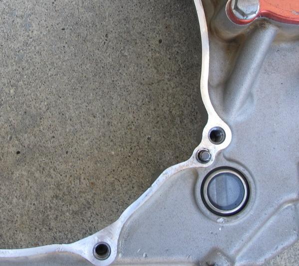

I hear you.
I had that same pic and enlarged it a bit to show some more detail
kx500 2 piece clutch cover 1.JPG (50.84 KiB) Viewed 15463 times

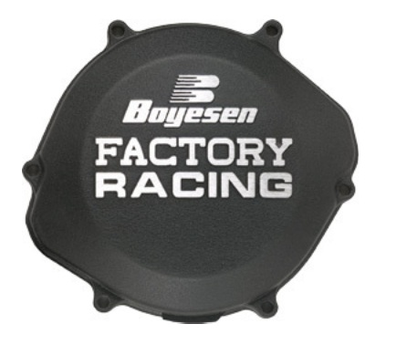

Of course, if the kx250 clutch cover sliced bread method works, there is some after market covers ready to go for 92-08.
This is suppose to be a pic for 92-96 kx250
boyesen clutch cover.jpg (31.88 KiB) Viewed 15463 times
