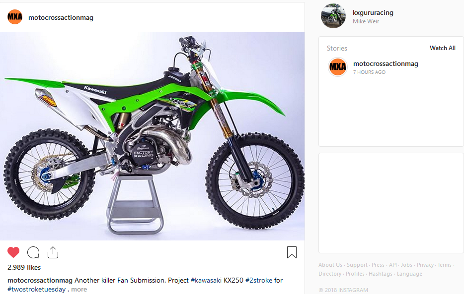

Looks like Umberto caught the attention of Motocross Action Magazine 8-)

That was pretty cool to see my bike on their Instagram feed. Although one mean man said it was ugly in the comments. :lol:

There is always one oddball in the crowd... Generally it just means that they are jealous :lol:

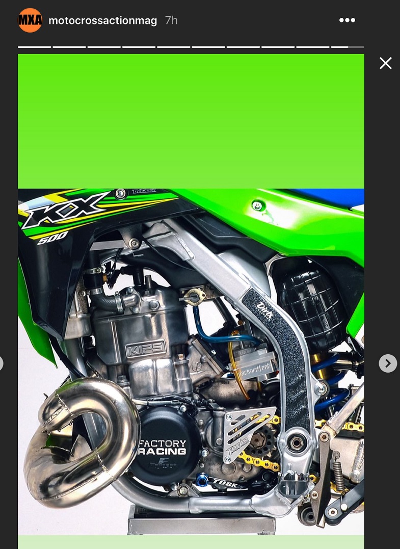

More Motocross Action Magazine action for Umberto..
Look what popped up on Motocross Action’s Instagram story this morning.
